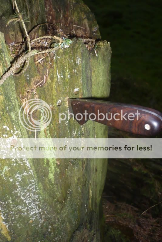

All day it takes until dusk comes and you find the shelter of a gully with a wood and stream below ... you need a fire for food an warmth ... but no knife to work with ... and then the same voice ... it tells you to "look in the dead tree" ...
and behold the knife you saw is there !! You rush to the tree eager to claim your prize ... but the tree just sucks the knife in ...
Hours pass trying to pull out the knife ... darkness comes ...
The tree shakes with your efforts ... and the voice speaks ... "only the worthy shall draw the knife" ...
So you shout back ... "my name is "Wilson" and I AM WORTHY" ...
The knife is released and the knife is yours ...

Wait wait wait, so you stuck a 9% vanadium steel with a tapered tip and thin ground edge(traditionally found on all his works), probably hardened to Rc 63+, into the ice and a tree?:eek:
I'm not sure Phil would approve.

And yes Noctis ... Phil's knife does have a very fine tip and fine edge geometry ... but if you use it properly you would be suprised at what it can accomplish ... although a full explanation of the "tree" and "ice" is that this looks a lot more severe than it actually was ... the tree is not as hard as it might first appear ... notice the termite holes ... the tree was actually as soft as putty ... and the ice was truely a weird phenomenon ... but there was no perma frost in the ground so sticking the knife in for the pic was no more difficult than other surrounding soil ... however this knife has been my belt knife now for 6 months and it is still educating me with what it can do ... it's pretty amazing :thumbup:
True, though there are those knots I would watch out for. I myself have a Phil Wilson South Fork in M390. After I made a few cuts into 3 layer cardboard about an inch thick, I found that the edge had rolled(an impressive feat at Rc 62). I concluded that the razor thin edge geometry is different from most knives that I'm used to, and that there are certain things I shouldn't cut with it.
