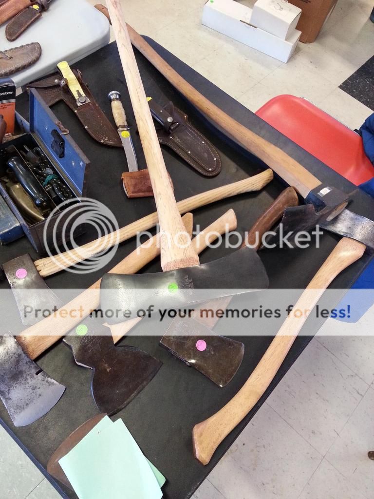

I received a pro tip yesterday from an older guy that I met who is THE axe guy in my area as far as collecting and restoring goes. I had heard of him from a few of my antique store contacts, and met him at a show yesterday. He isn't really competition as far a buying the common rusty stuff that I normally find goes, but he specializes in finding/buying highly collectable stuff, hand making handles from lumberyard hickory blanks, refinishing the heads and selling to collectors as very expensive wall hangers. (They could easily be users, but these could also be museum pieces) From what I could gather, he is a retired woodworking or shop teacher. We spoke for a while, I let him know about my new interest in the hobby and my love for crawling through basements and barns. The guy, having never met me before, opened up a bag, pulled out a very nice axe head and handed it to me as a gift just for being into the hobby. Genuine gestures like that leave a mark on me, as he did it with no expectations of anything in return. I will return the gesture in some way. He gave me his number and has many great heads that are right up my (our) ally but are not interesting to him for high end sales. He will happily sell them to me cheap, can't wait to see what he comes up with.
