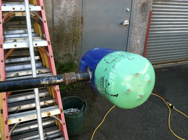

Thought I'd share my freon tank forge build. I've been holding off on making a freon tank forge, I am going to make a PID controlled,dual burner, blown, bigger forge because I want to be able to do larger/longer pieces and heat treat,normalize accurately and wasn't finding any free longer pieces of steel for a venturi forge. But, it'll be a month or two before I tackle the the blown forge, meanwhile, I have hammers, anvils and tongs itching to be used.
I didn't want to have an open back on this forge to accommodate longer pieces...Then I thought about the taper on the tanks and figured I could tack two together!
I bought refractory cement from a local company and their version of ITC/Plistix. I already have the Inswool from the local ceramic/pottery wholesaler.

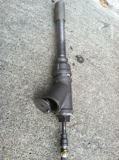

The gas regulator came from a BBQ/Turkey Fryer place it Texas because at the time Ellis was "lagging" in shipping...(note,I hear nothing but good about Wayne and High Temp :D) It's a 50 PSI Propane reg...
I bought the parallel fitting from my plumbing wholesaler for my venturi burner, the rest was scrap, including the 304 SS flare that came from 28' of a sliderail out of a sewage ejection pit :barf:... The choke plate was from the GIB packaging the tension spring is from a Delta faucet seat, the screw from a floordrain cover.

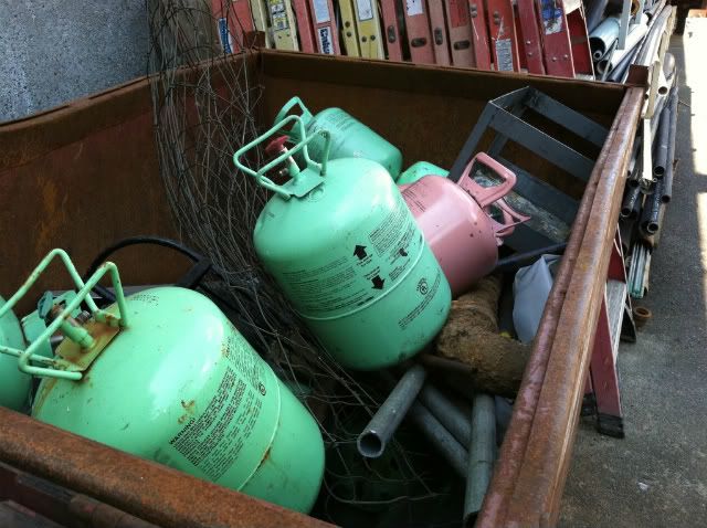

I started with the scrap bin at work...
Donned the appropriate safety gear, respirator, and eyewear..
Then I chose two tanks...

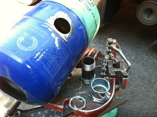

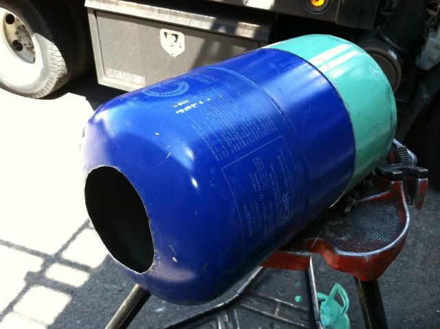

Cut the end off of one, cut another in half with a cut off wheel on my grinder. All holes, cuts, were rounded off to keep me from bleeding throughout the project.
Due to the tapered and, I was able to set one inside the other and tap it together, actually, I did it to test it, and it took me ten minutes to get them apart because I hadn't cut out the back of the blue tank yet....:o I don't think welding would be needed...I will weld a base on and add a tong/work support....
I measured in 3" from the back to allow for the insulation and refractory at the back, then centered the hole in the tank for the burner. Drilled it with a hole saw....
Next, I added an 1-1/2"x4" BI nipple. I used the lock nuts off of an 1-1/2" EMT electrical conduit connector to lock the nipple in place. I'll likely eliminate the locknut and weld it in place. I'll tap the nipple with a couple bolts to anchor the burner in place.
I then threaded it onto the handy dandy pipe rack at work and carefully bent the tank to bring the burner in on an angle....I assisted the bend with a hammer to keep it from kinking...
Here is my burner I made. It's based upon a Zoeller Z burner.

Looks good. I would recomend welding the pipe in place rather than using the conduit connectors. I used those on mine and it held for a few months until they got hot and bent under pressure. There is NO way to get in there after the insulation and satanite has been set to replace or tighten it. It is now welded in place
Yup, will do!
