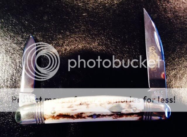

I only own one GEC stainless knife, but absolutely love it. Truth be told, I purchased it more for the Elk scales than the stainless blade, but am very pleased with both.
