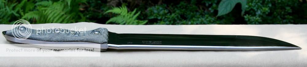

Satin:
Doublecut (twice bead-blasted using one blasting medium to "cut", then another finer medium to "seal", IIRC):
Competition Finish:
2nd down
Nuclear Meltdown Finish (note the rounded spine, guard, pommel, & "blended" lines on the blade, plus the "ball bearing finish" on the holes:

So what I'm seeing here is that, basically, there's a whooole lot of really pretty ways to get a Busse knife done. :p
Jaxx, that NMFBM is a Beauty!:eek: What kind of handle is that? It has a great pattern and color:thumbup:
Believe it or not, it's Tigerhide linen micarta. There were some pretty wild variances with that micarta during the short run of these...
Here's my other 6 side by side showing how much they varied away from the normal Tigerhide. I was not happy with the handles originally, but they grew on me and now I'm really glad that I didn't ask for them to be rehandled.
