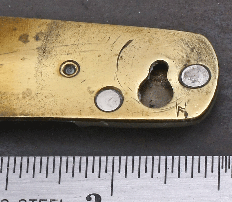

Model 301, first model made by Schrade under contract by Buck. Made using hidden bolster pin method. 'Swinden Key'.
Here is a photo of the side of the Schrade made Buck, the blades were put on the key pin, then both 'rivet like heads' were formed and then the heads slipped into the liner keyhole. This way no bolster pins show. But, they had issues with the strength of the brass.
Next in line is the method Camillus made Buck 300's, using the thru the bolster pin method. You can see how the pin's were flared at the ends to hold in place. This is why if you drive out a pin (and enlarge the bolster holes), you have to have a heck of a time getting the new pin to fill the bolster hole to the edge.

Here is a video that I learned more about the Swinden key.
MuskratMan repairs it by doing away with the Swinden key and adding a bolster pin.
I have four of the old Buck 301s that used the Swinden key design, so I wanted to learn a little more about it.
This was all I could find;
https://www.youtube.com/watch?v=X44CxU2wtOk

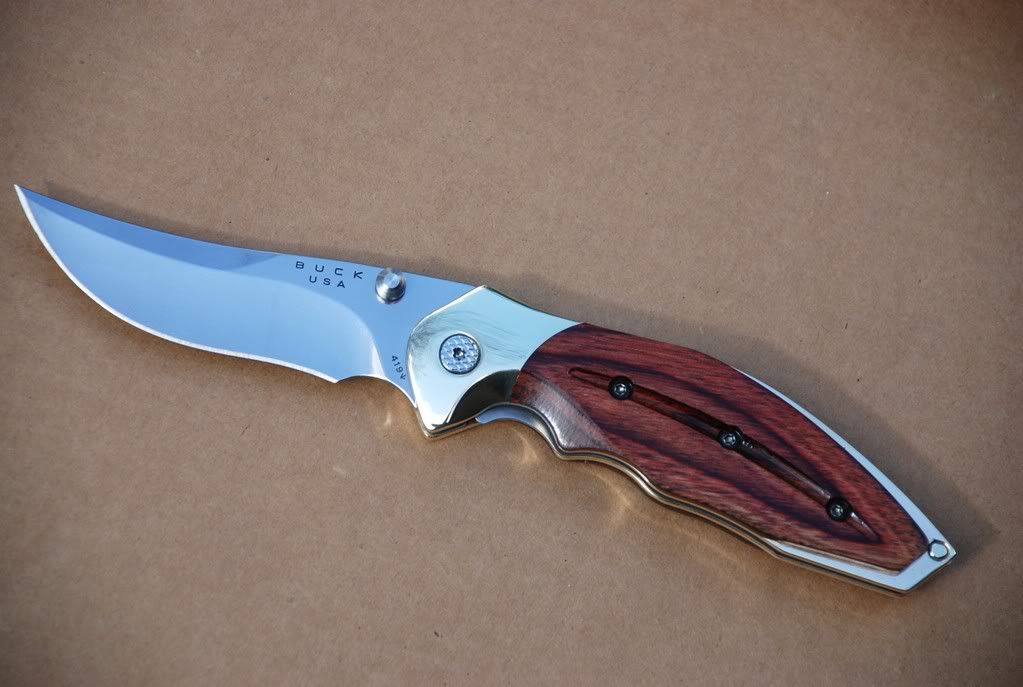

Maybe this goes along with this thread...
I don't remember now why I pulled the scales off of this one. But when I did I didn't like what I saw under them so I used some elbow grease and brasso. and I probably coated the handles with tru-oil
