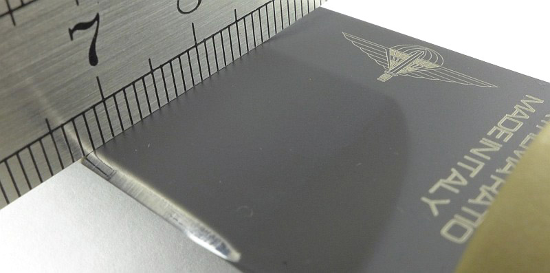

Using a set of gauges and precision measuring equipment including a Vernier protractor, callipers, fixed radius gauges and the unique Arc Master adjustable radius gauge (the one that looks like a crossbow).
These measurements have been tabulated and are presented along with a few reference blades (8" Chef's Knife, 5.5" Santoku and the popular Fällkniven F1).
Key aspects such as the primary bevel angle, grind type, blade depth, blade thickness, length, weight are detailed, along with balance information.
The 'Balance relative to the front of the handle' tells you if the knife will feel front heavy, or if the weight is in your hand (a positive value means the weight is forward of the front of the handle). The 'Balance relative to the centre of the handle' indicates how close to a 'neutral balance' the knife has in the hand.
In the case of full convex grinds the approximate centre of the grind is used for the primary bevel angle estimate.

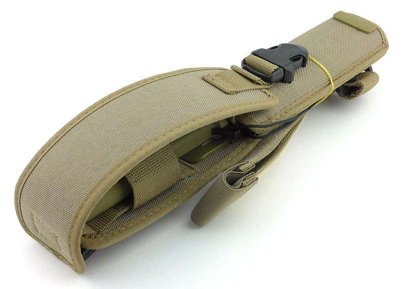

Onto the main sheath. The most obvious atypical feature is the full knife handle cover; as shown here, the knife itself is almost fully concealed. This flap is a critical feature to help prevent a knife fitted to a pack becoming a 'hang up' hazard. With the flap over the knife handle it is far less likely to catch on something.
Not relying on a fabric to keep the blade from cutting through the sheath, there is a full plastic sheath liner. This is the bottom of the sheath with the special fixing (visible on the front of the sheath) and the black plastic liner plug that closes off the end of the liner, but leaves gaps for drainage.
A high quality plastic snap buckle holds the knife cover flap in place.
Rolling the sheath over and there is a full length MOLLE fixing strap.
The top of that MOLLE strap is what holds the removable knife cover flap in place.
Here the knife cover flap has been folded under the rest of the sheath. Note the thin black cord running down the side of the sheath.
That cord runs all the way down and is held by the MOLLE strap press stud.
The knife retention strap is also adjustable / removable, with velcro holding it in place.
The primary knife retention is not the strap, but is a plastic tab that is part of the sheath liner.
You can see how the side of the handle hits that plastic tab as you insert the knife into the sheath.
Push a little more firmly, and the knife clicks into place. It is now held in the sheath by this plastic tab, requiring a firm pull to free it.

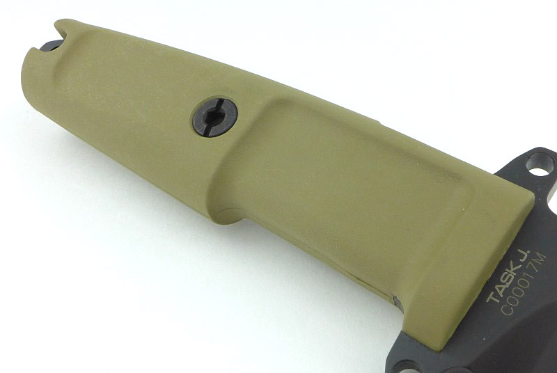

Extrema Ratio's distinctive Forprene handle is used, in this case the desert colour.
Used on several models, this recognisable handle is particularly effective. The grip design provides a secure dual finger groove and the Forprene material cushions the user from the shock of heavy blows.

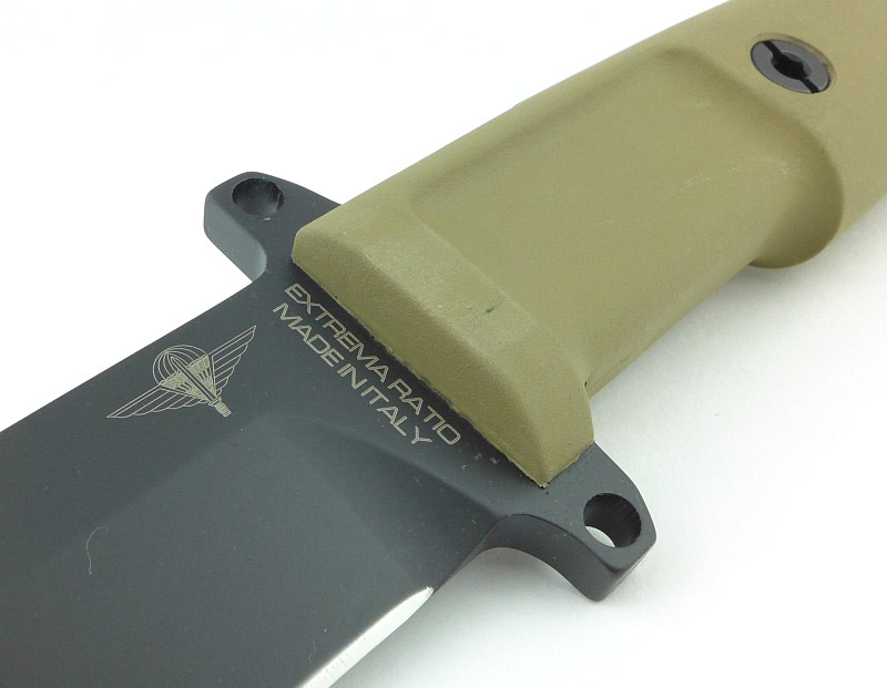

Another clear design feature intended for extreme use, is the double guard which provides the greatest protection against the hand slipping forward onto the blade.
A well radiused plunge line keeps maximum strength at the transition from cutting edge to ricasso. Note the lack of a choil which in this case removes the chance of a hang-up if the blade has made a full depth cut.
There is a single bolt to keep the handle in place.

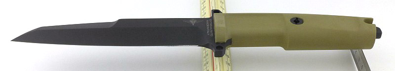

To properly show the proportions of the TASK J, this side shot minimises perspective distortions.

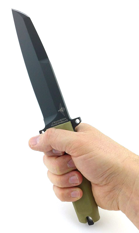

Taking the TASK J in hand, and it is a full size knife, having a blade just over 6" long. The ultra modern looking grip is very comfortable and secure to hold (one reason it features on many of Extrema Ratio's knives). Despite the amount of meat in the blade it does not feel overly heavy or unbalanced.
In a reverse grip, the top guard does interfere somewhat with the range of movement, and makes it more difficult to bring the blade back close to your arm.
