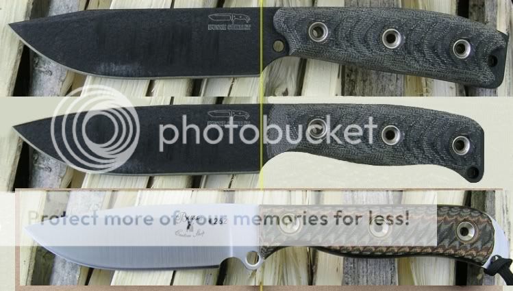

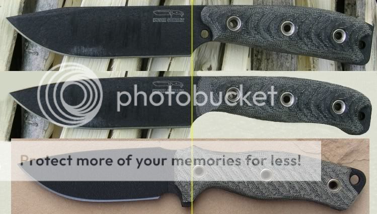

I was typing a response to Matteo when you posted this. That looks quite close to the sort of thing I am after! So close that I might rethink this idea right now and sell/trade the BATAC for a SAR5.

I just sent you an email. John and I have discussed modding the SAR5 before. It is a great blank for quite a few design mod options.
Truthfully, because of the BATAC's tall blade profile, the BATAC actually has even more versatility. But, modifying a BATAC into a smaller Bushcraft knife will require a LOT of steel removal and best to have the proper equipment.
The SAR5 is limited because of it's smaller size and lines. But, if you can get the design you want out of the SAR5 blank, modifying a SAR5 would be a LOT less work because of a lot less reshaping and steel removal.
I would spend some time getting a detailed and accurate feel for what you are ultimately trying to achieve. If you can't get exactly what you want out of a SAR5, then I wouldn't waste my time. It will be a LOT of work by hand.
Truthfully, if you want a Skookum or Koster, I would get a Skookum or Koster. But, that is me.
INFI is the KING of knife steels, but seriously, Skookum offers A2 ,O1 or CPM 3V. Koster also uses CPM 3V, 01, 1095 and 5160. While not INFI, for Bushcraft sized knives with proper heat-treatment, they are VERY good.
O1 is particularly suited for a Bushcraft style blade. It can't handle quite the extreme abuse and prying of INFI. But, O1 is quite tough, holds a VERY sharp edge and sharpens easily. It oxidizes pretty readily. But, I thought a lot of you British guys liked the patina on a good Bushcraft blade.
3V is also very tough, gets VERY sharp, not quite as easy to sharpen as O1, but probably a bit more corrosion resistant. It won't make a "nice" patina like O1. But, it will spot and pit nicely if allowed to. Still, 3V is a VERY nice knife steel IMO.

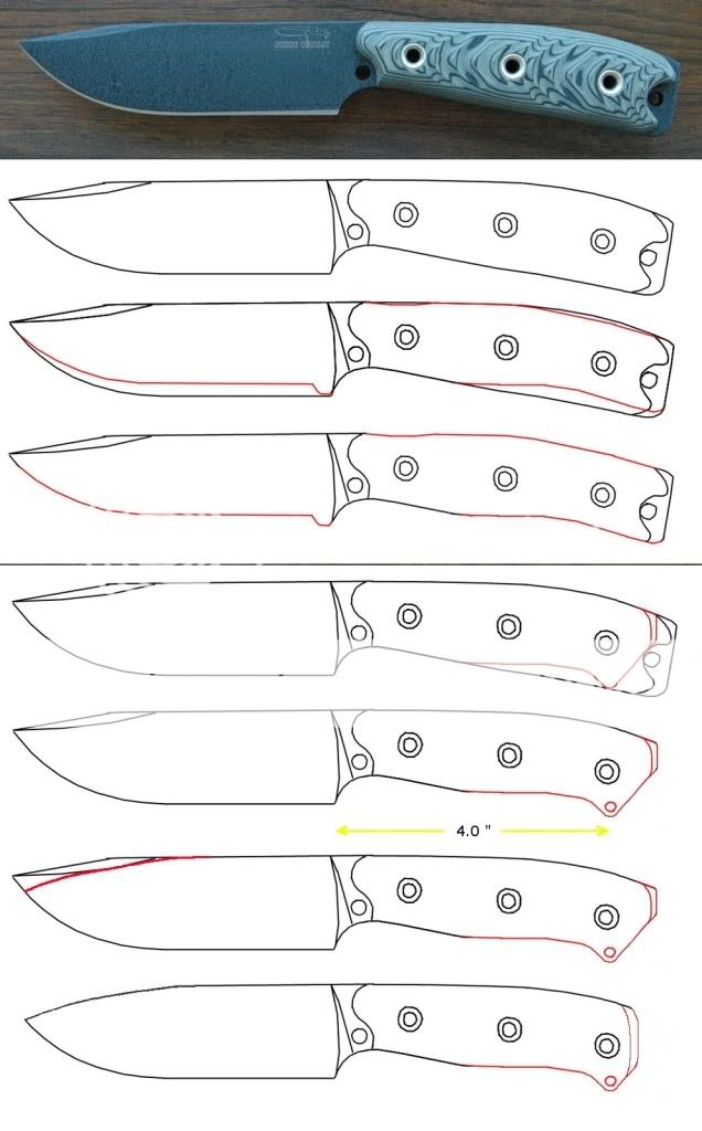

I don't know if you will be able to come up with the exact Bushcraft design you want with it or not with the SAR5 or BATAC, but based on design tinkering LVC and I have come up with, I think you should be able to get a very good Bushcraft design from the SAR5 and possibly very close to what you have in mind. (?????)
I still have some of the photoshop drawings LVC and I discussed. Jerry has requested I not post photoshop stuff. He might come up with something similar someday and wants to avoid possible legal issues. So, I would rather just email you the info rather than post it.

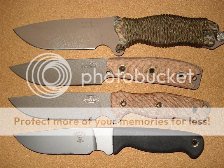

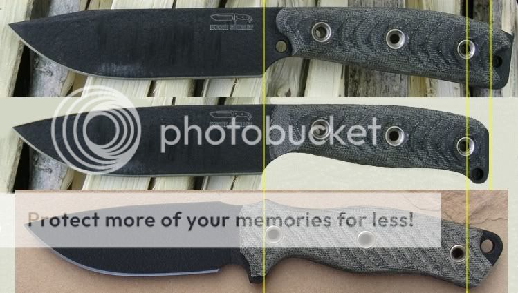

@ Resinguy, thanks for that photo. Could you possibly tell me the exact length, say from the point to the pommel, in a straight line passing though the rear lanyard hole please? Like below. Then I can work out a scaled version.

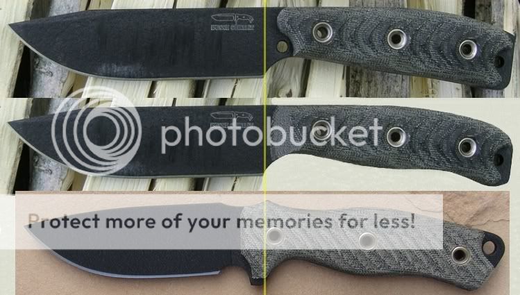

Rick, I just emailed you back with some of my sketches and photo shop stuff. The original base sketch was from LVC. I hope he doesn't mind me sharing.

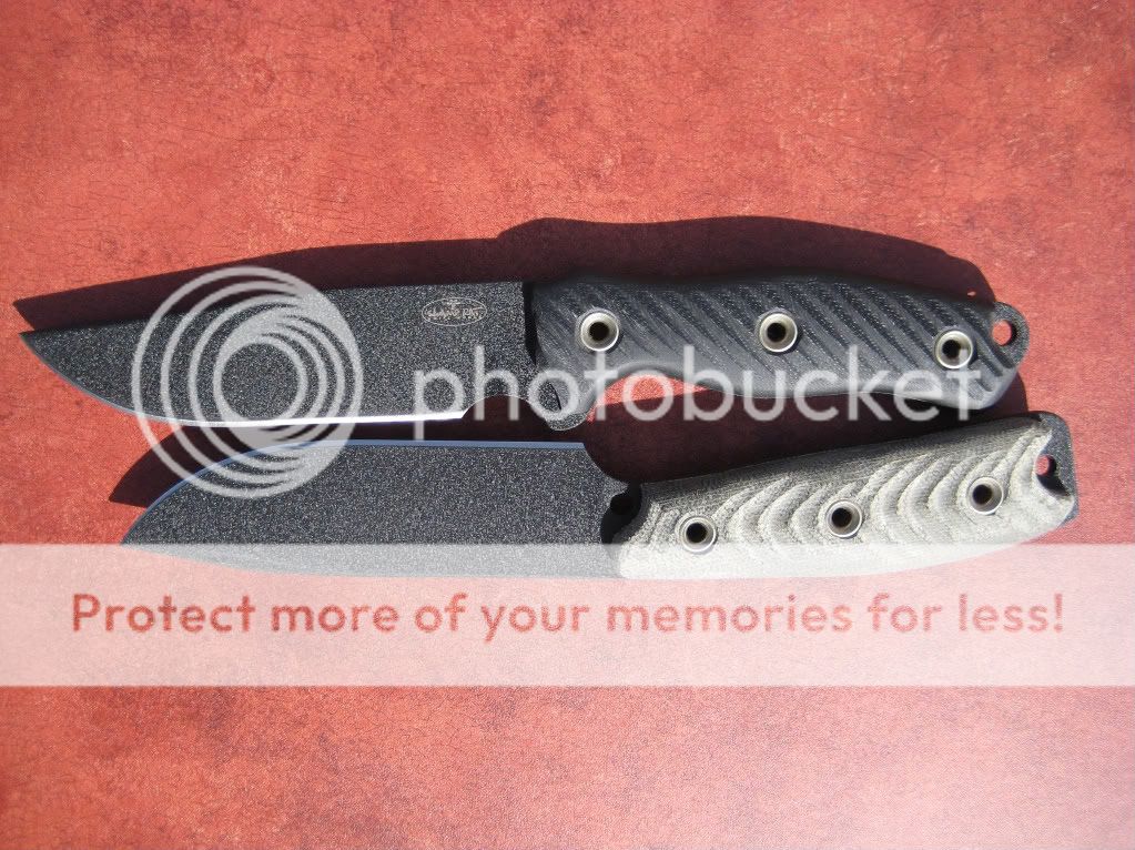

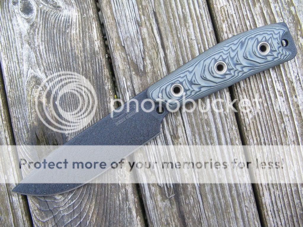

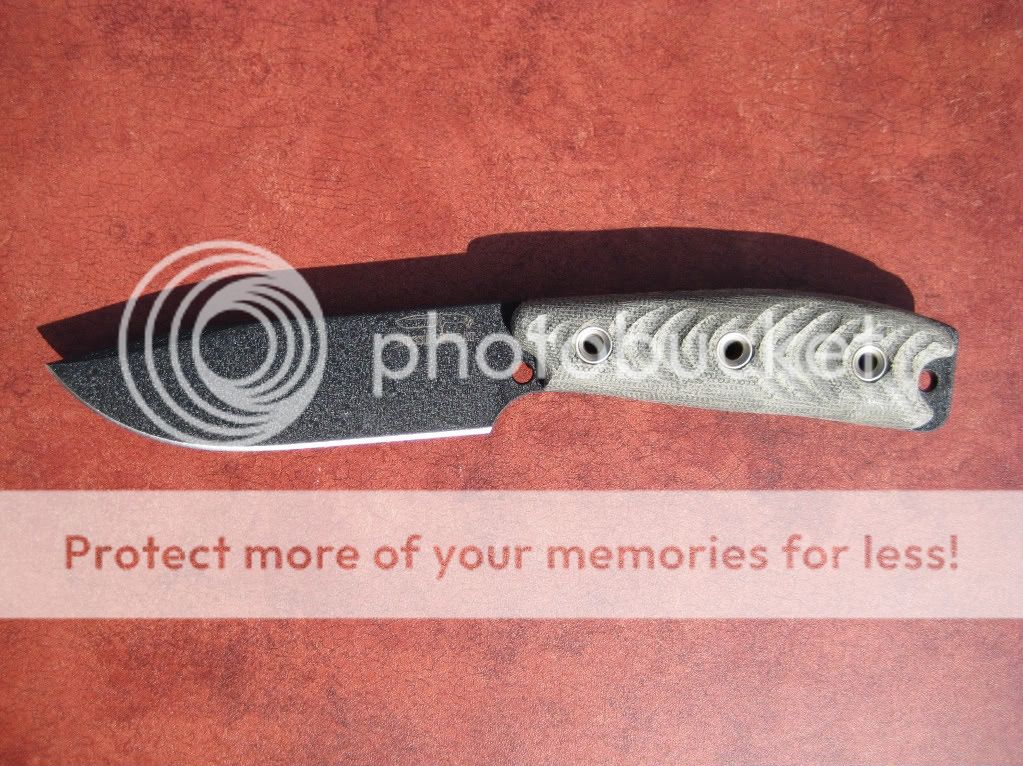

Here are some more pics of the SAR5 that might be usable for photo edit tinkering:

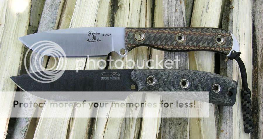

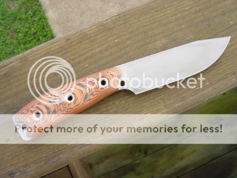

I did a handle only mod (except I did strip the coating off too) for Tony G on a SAR5, here are a couple of pictures.
Wow Ducci. That is VERY similar to a couple of the photoshop sketches I emailed to Rick.
I wasn't going to post the photoshop pics, but what the heck... you posted the actual knife. ;)

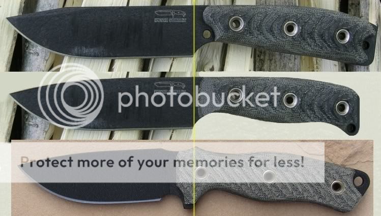

Here are some of my tweaks. I prefer the smaller/shorter handle with a spear-point. I don't think much is gained by having the longer handle.
One of my favorite handle shapes for a 4" - 5" blade is still the RMD's handle.
And my favorite all-rouind utility purpose blade shape is the SJTAC's if the thumb ramp is removed or more like the RMD's Ramp.
