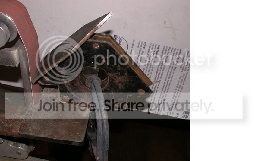

I was all prepared to spend some time fabbing a dovetailing jig
but a few minutes of tinkering resulted in this.
Just make sure your platen is perpendicular to your tool rest.
Clamp the welding magnet with a c-clamp. A scrap piece of
barstock mounts atop the magnet to provide a nice work surface.
If everything is aligned properly you get a nice crisp dovetail
with a minimum amount of setup.
Hope this helps someone.

stupid question. is the magnet strong enough to keep the piece of barstock from moving at all?

It was very stable. I did use the biggest magnet that I had.
