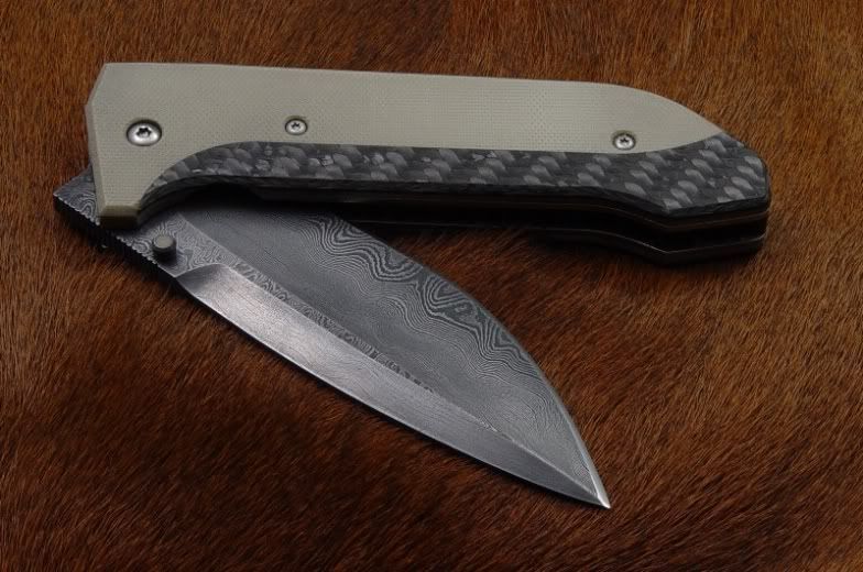

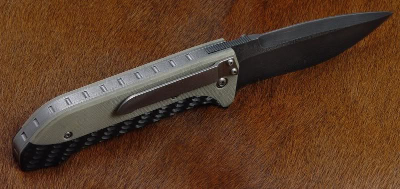

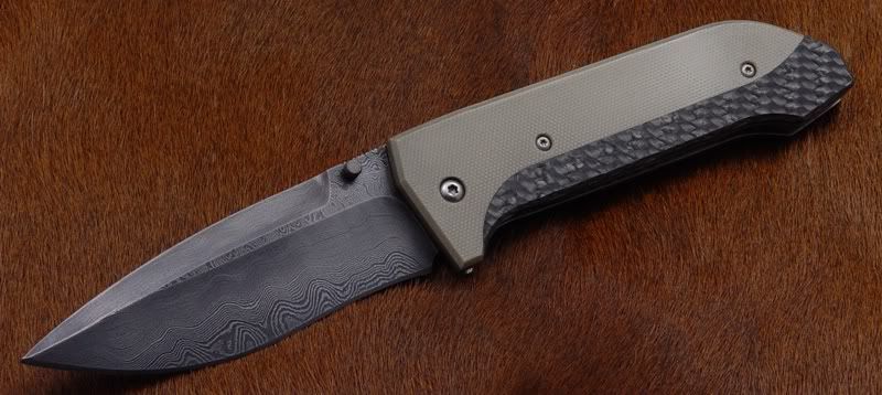

Hey all! This is my first damascus knife using my own steel that I built a couple years ago. Its a 1095/15n20 composit, random 360 layers. The carbon fiber and steel have similar 3-D elements, super clean. And my grinds? Pretty clean too if I do say so myself. What do you think?
This one's on the way to Three Little Indians Custom Knives shop. Tell 'em Frank sent ya.
1095/15n20 360 layers random 4"x 3/16" blade sharpened to a razors edge
9" OAL
damascus thumbstud w/ tan g10 inlay
g10 tan onlay/ cf inlay
ti jeweled frames, eggshell edges
ti eggshell backspacer
ti eggshell pocket clip
Nice work Frank. Your choice of handle materials go well with the Dark Damascus:thumbup:
Wow, who'dah thought such few words could give such an ego boost? Its thrilling to me to here I have a distiguished style (atleast to one person). Thanx!!!
With this profile, it threw off the balance to much when I tried to incoorperate bolsters. So simplicity reigned champion here, well minus the inlay.
The next design though (coming soon)... bolsters & custom onlay w/ inlay, oooo yeah. Keep your eyes peeled for that one.
