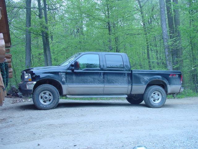

I had a V-10 F-250 for many years, never gave me any trouble, plenty of torque to tow etc. IF i were going to rack up BIG miles on one, I would opt for the diesel ONLY if I could find a 7.3, which they tapered off in 03.
Ive driven a few of the F-250's with the 5.4 and it sure felt a bit anemic to me, and I wasnt even towing!
Here's a beautiful example:
