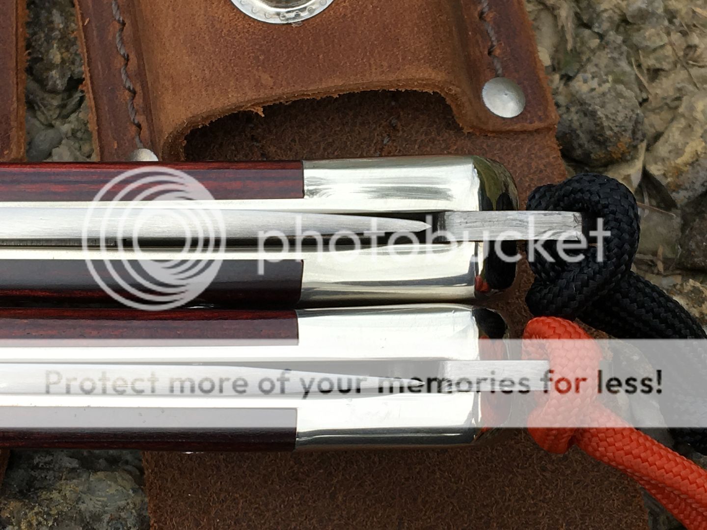

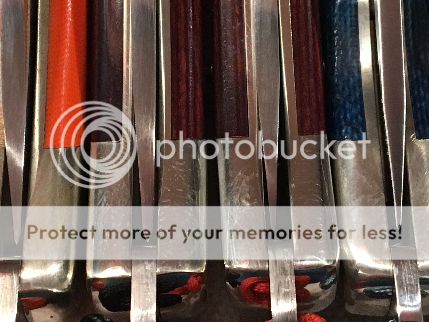

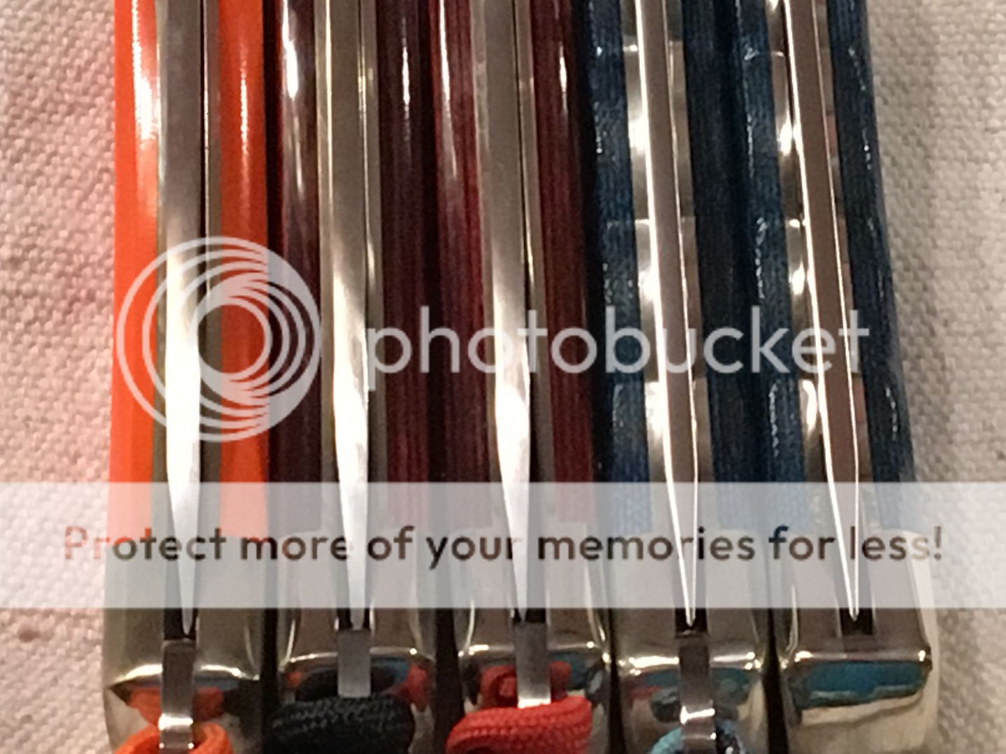

I too have a 112 or 2 that appear to be shorter, but there's no evidence that they have been reground. I think the blade height (edge to spine) is bigger on the older 112s too. I'll see if they're somewhere where I can dig them out when I get time. Here's an example of the grind being different. These are DLT S30V NS 110s along side of some SK versions. All are drop points and the steels are S30, S90 and CPM154 (not that the steel should have any bearing on the differences).

I have side photos, but visually they indistinguishable. I was surprised that they're ground not only different from each other (same batch and build date), but different from the other 3 drop points in the other photos.
In the top photo it's plain to see the one on the bottom is ground more than the one on the top and the second photo shows that it's a hair shorter as well.
