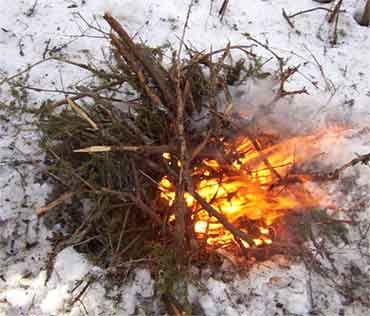

I intended to use the Ratweiler and Heafner bowie to mainly test out some fire logs, this turned out to be a major disappointment. I had basically plastic wrapped a wood shaving, newsprint and wax combination and figured to just slice them open and presto instant fire with no kindling.
In short they didn't work. The plastic wrap was way to slow burning, the flames were about 1-2" in height with a very low volume. It was also about -5 C (dead air) with a 30-40 km wind, and thus my plans to just burn cut and dead wood fell short. The fire log burned well, no problems starting it, but it just didn't produce enough heat, I had to fall back on preparing tinder.
http://i7.photobucket.com/albums/y269/CliffStamp/swamp rat/ratweiler/ratweiler_fire_start.jpg
They would probably work well if it was warm and the wood dry and easily ignited, but it is trival to get a fire going then anyway. I wanted something which would readily burn wet and frozen wood. The plastic was just too thick, it was the remains of a waterbed, fairly flame resistant it turns out. Of course it still made it a lot easier than nothing, a few small sticks, some green boughs and flame.
In no time the fire was self sustaining and could take the wind and both knives were used to cut up some close by dead fall as well as chop up some alders to see how they worked as machetes on springy brush. There was no difference in cutting ability, the Heafner was again heavier in hand, but even it is light compared to larger khukuris or parangs so I don't mind the weight.
