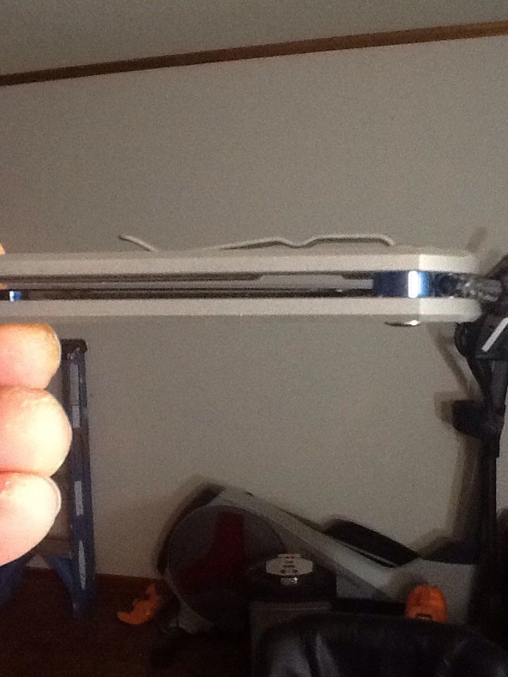

I got it in the mail today, and I'm skeptical as to its authenticity. I posted a similar thread about a Sebenza that I found on ebay (it's a bad habit :rolleyes:), and many of you were so kind as to chime in with your opinions, which were able to help me authenticate it.
I haven't heard of counterfeit Seagrass Sebenzas, something seems fishy to me about this one. The knife is currently completely disassembled, so please ask for pictures of parts if you think it will help identify it. Here's the list I was able to come up with that are points against its authenticity. Let me know what you think.
  • Unmarked blade (aren't these stamped with a letter to designate the blade steel?)
  • Short, untapered screws
  • Unperforated washers, brightly colored
  • Double thumb lug is very blue (almost too blue?), which I see frequently in fakes
  • "Idaho Made" is present, but is not deeply engraved
  • The frame lock-side scale has no engraving on the inside for a manufacture date
  • The two channels on the frame lock side have an odd enlargement about in the middle
  • The overall fit is ever-so-slightly off, and even after thoroughly cleaning and reassembling, I can't seem to get the detent right (a problem I've never had with anything CRK)
  • Looking at other Seagrass models, this one seems to be lacking in color
  • The lanyard pin is very blue, and the lanyard is made with gutted paracord
  • Oh, and this feels quite damning: http://www.aliexpress.com/item/Cust...625-Stonewash-Plain-9Cr18Mov/32279994903.html
Let me know what your thoughts.
Here are some nice images for your looking: http://imgur.com/5e11FHe,TPHit0W,8A2ncNc,pieMpIw,yp7xUTj,tCiegWk,DlvgADG,rxnJM2h,RR4dJZU,op1EDCh
Missing stamps on the blade and the scales.. I'm gonna say it's a fake. Also just looking at the lanyard pin I can tell something is not right. sorry man, hopefully I am wrong but it appears you may have been had
The eBay listing you posted lists the blade steel as 9Cr18Mov. Is that the knife and or buyer you purchased it from or just a reference to other fakes?
The bullet point link is to a website where you could at one time buy knives that look similar to this one. The ebay listing has the knife listed as 35VN. It's also listed as a Sebenza 25, which it obviously isn't. I'm guessing the seller isn't familiar with CRKs.

Can't win them all! I've started the return process with eBay...I guess Buyer Protection exists for a good reason. I hate to disappoint the seller who, I'm sure, didn't know any better.
98% sure the Spyderco military listed by the same seller is fake too.
...The ebay listing has the knife listed as 35VN. It's also listed as a Sebenza 25, which it obviously isn't. I'm guessing the seller isn't familiar with CRKs.
Con artists often play stupid, that way the mark's greed will over ride caution "it so cheap because the owner doesn't know what he has." The mark convinces himself to buy.
FYI - the January 31, 2013 birthcard has been copied a lot. It's a fake. Sorry.

No time stamp on the slab, way too many colors in the graphic, can't tell if the blade is polished or not. Anyway, it looks like a dud. Does the end of the pocket clip turn and is parallel to the knife??? Here's a pic of the real deal.
I have seen that one. Far too leery to pull the trigger on that one. If a deal seems too good to be true, it usually is. Some people do not know what they have, but the fact that this one keeps popping up every couple of weeks makes me leery of it. Will spend my $$$ on one I KNOW is the real deal...!!!
The Birth Card looks copied. With that same bad date. C'mon, you gotta trust a guy named Tony Steel...;-)
Might be wrong but a little research turns up facts that point to these being produced by a Chinese company that is affiliated with Smoky Mountain Knife Works that goes by the name of Wild Boar Knives and they counterfeit damn near everything. Most of the blades are actually D2. There were two listings. This gentleman had sense enough to end his listing.
