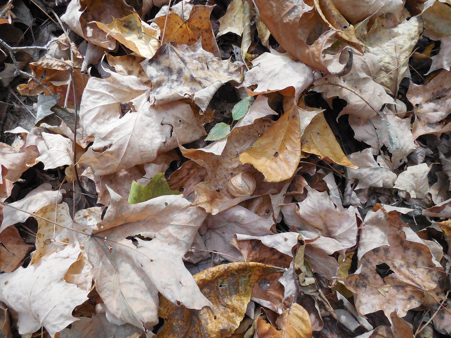

I first feared there would be no hickory nuts as checked out several spots along my path. However hit paydirt!
I want the husk black or better yet out of the husk.

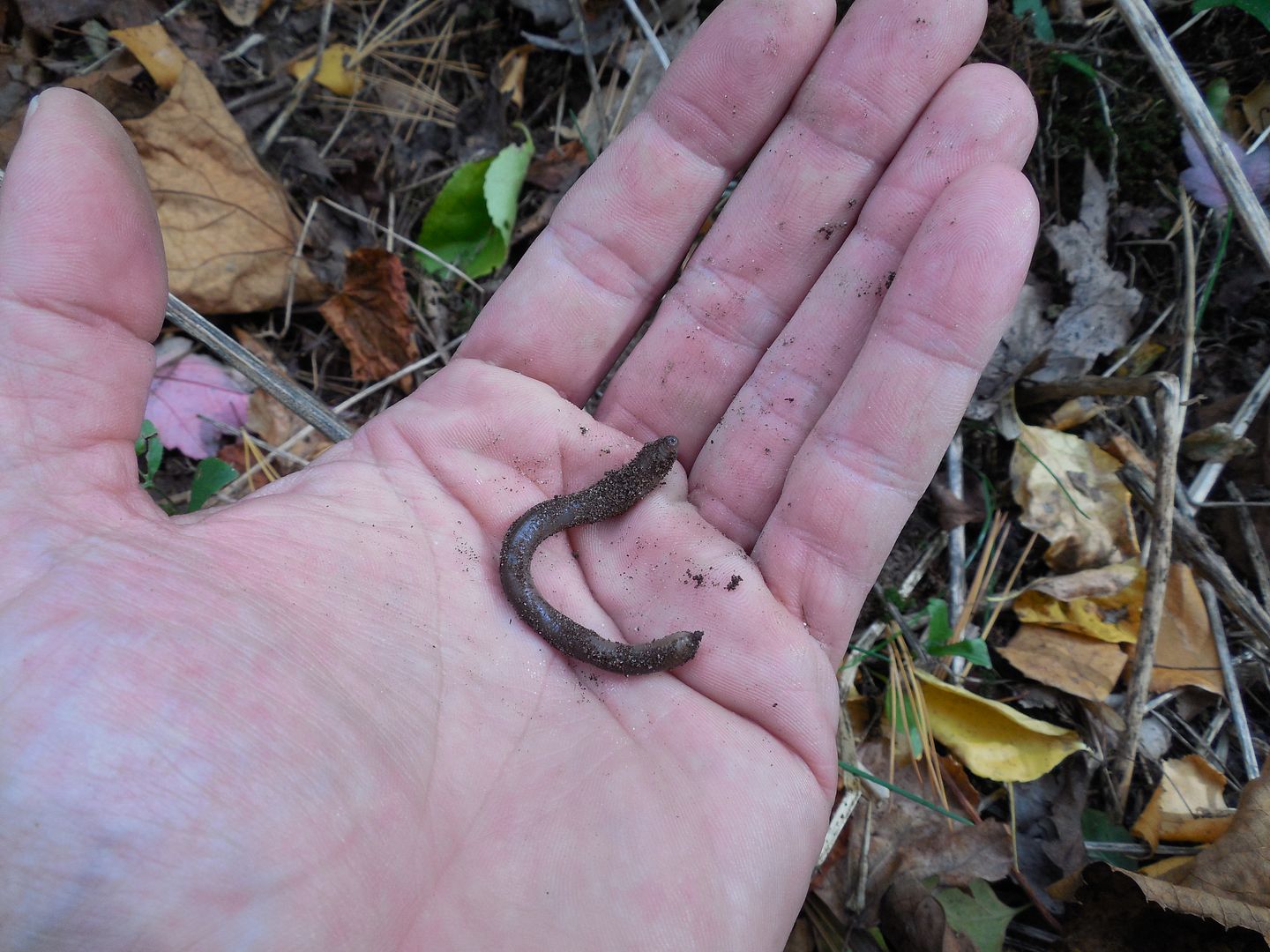

Hey look! It's a worm. No I am not going to be eating worms but they're bait. Found a few during the day without even looking.

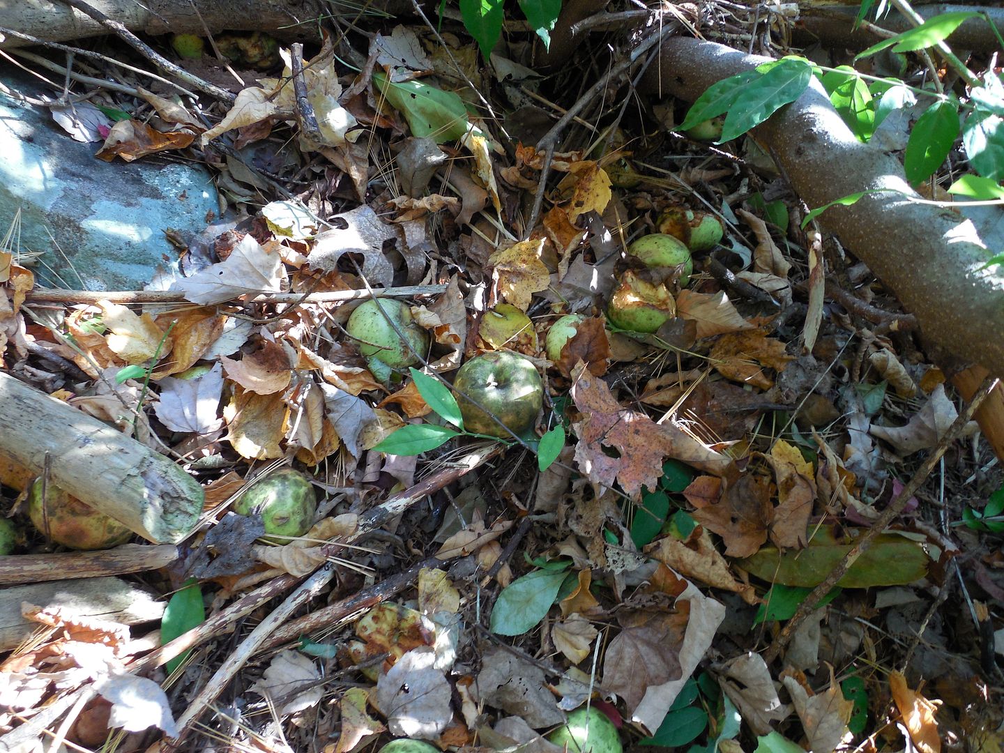

Wild apples. Actually apples aren't wild but were once planted in long forgotten orchards. They might look nasty compared to what's available in the market but they're not bad. It's a BIG score and will forage many. Looks like deer or something else has been chewing on them. Wild edibles is a game with many players, most of which are far better at it than myself.

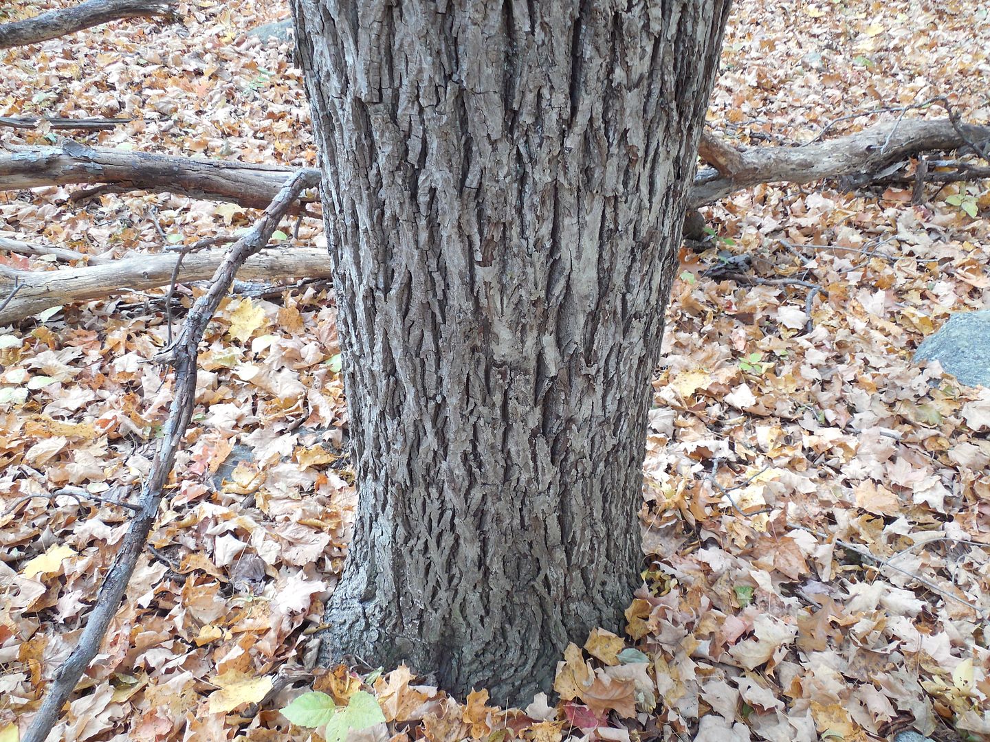

The bark.
Food isn't the only resource I am foraging for. I still don't have a way to start a fire. No fire means no water because I don't have a filter or tabs either. I won't be risking waterborne illness just to test my skills. If I don't later succeed at starting a fire the game is over. Right by the apple tree was a fallen cedar. The bark wasn't prime but seemed good enough for a tinder bundle. The cedar branches might also make for a good friction fire set so took some as well. I started to notice my lack of a saw or axe. The knife did the trick for both jobs.
Even found some dead White pine. Going to take this cedar and White pine for a friction fire set.

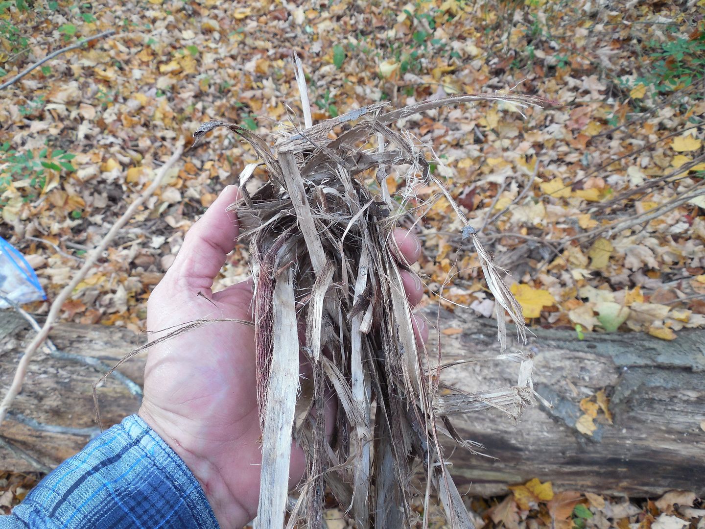

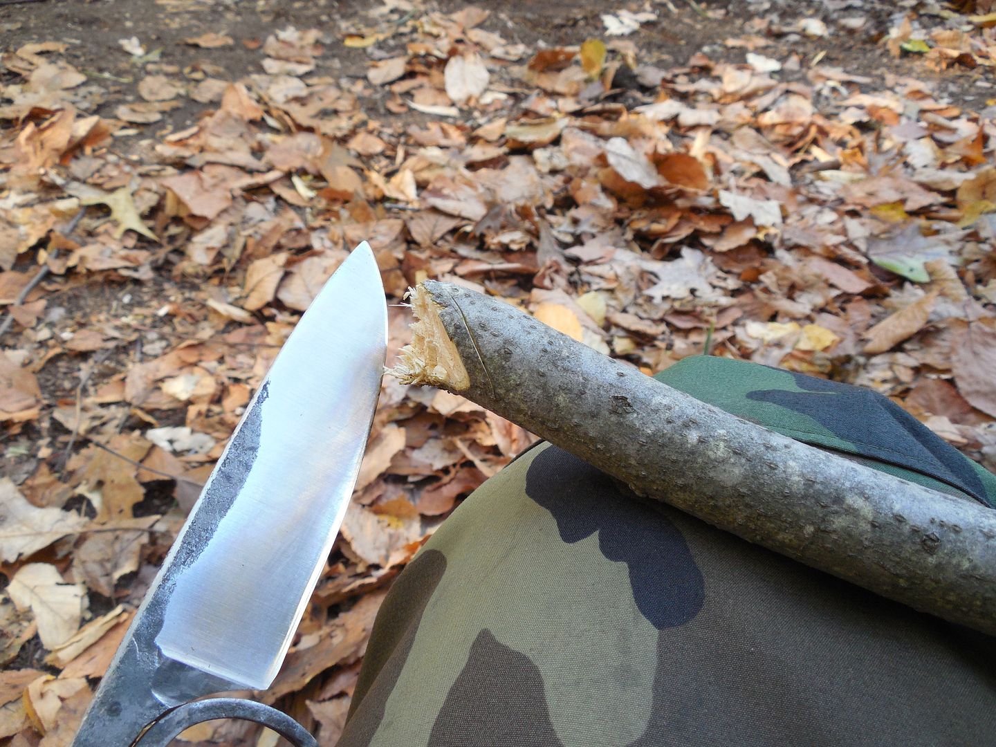

I used my knife to both remove and fluff the bark at the same time. Looks like I am starting to have the makings of two different methods of starting a fire. The more options the better.

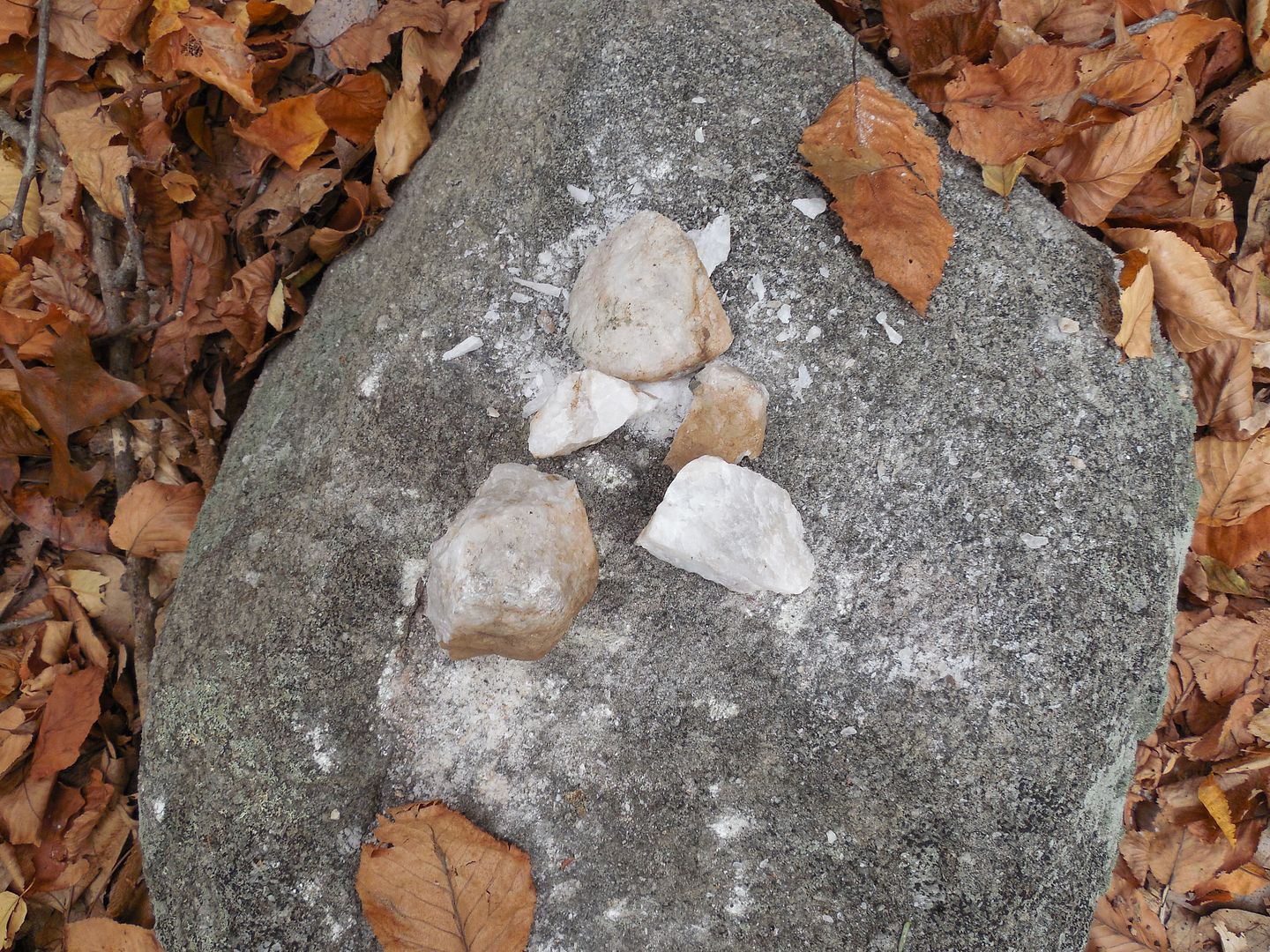

I found this quartz in a drainage area not too far from my pack. The leaves made the quartz more difficult to see but this was a good start.

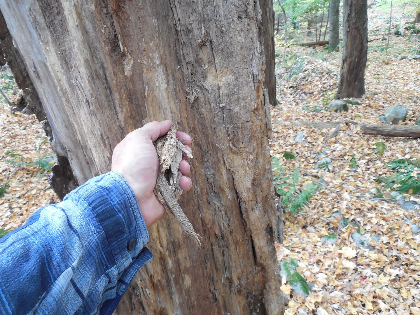

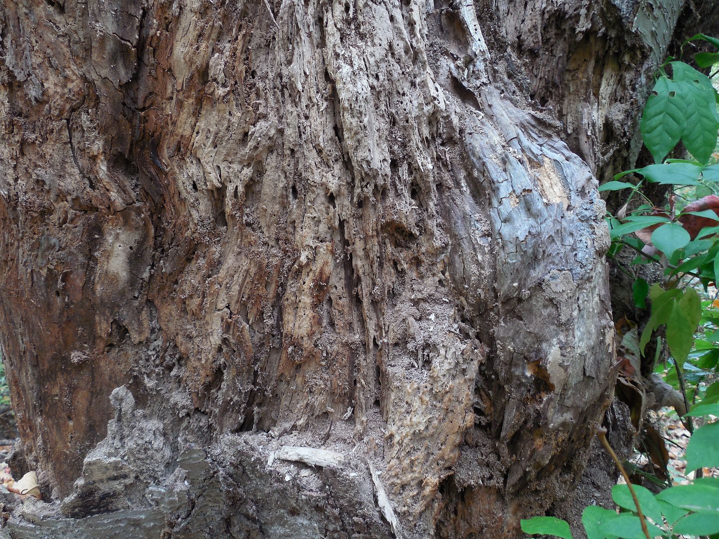

And what do we have here? Looks like punky Black birch. Punkwood can make for a good coal extender and natural charred materials. I found punkwood smoke seems to deter mosquitoes however it was too cold for them.

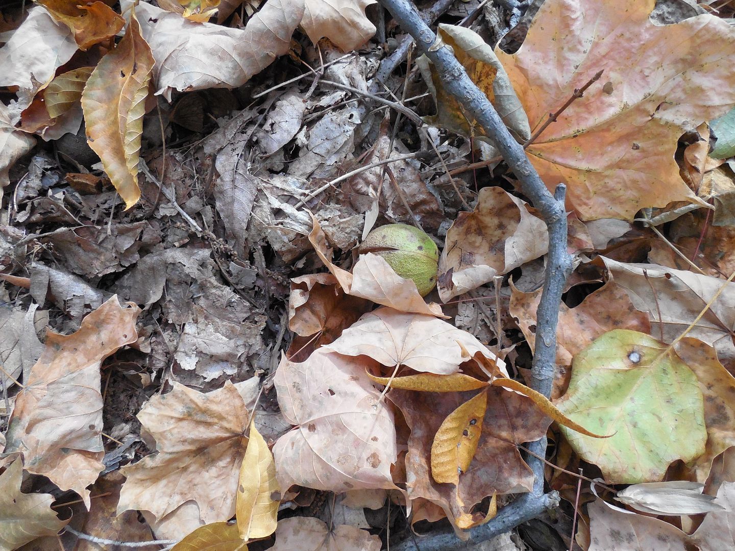

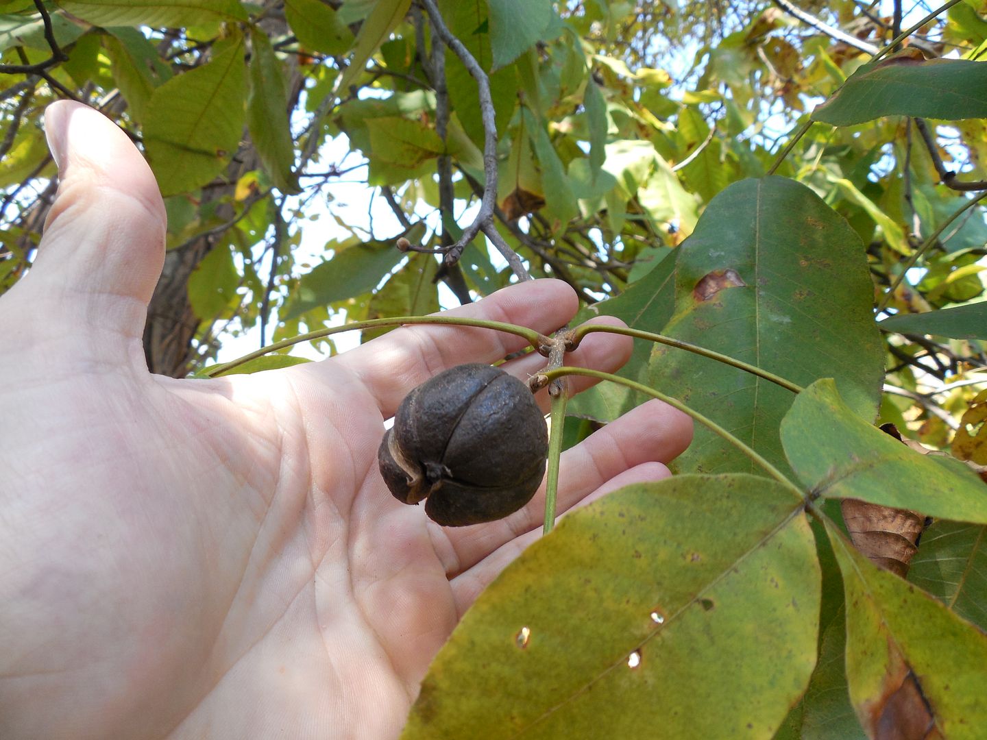

Green and still in it's husk. Green Hickory nuts are extremely bitter. This one isn't ready yet.
Oh nice. Out of the shell!
The green ones are just for show as they're a no go but the rest are perfect!

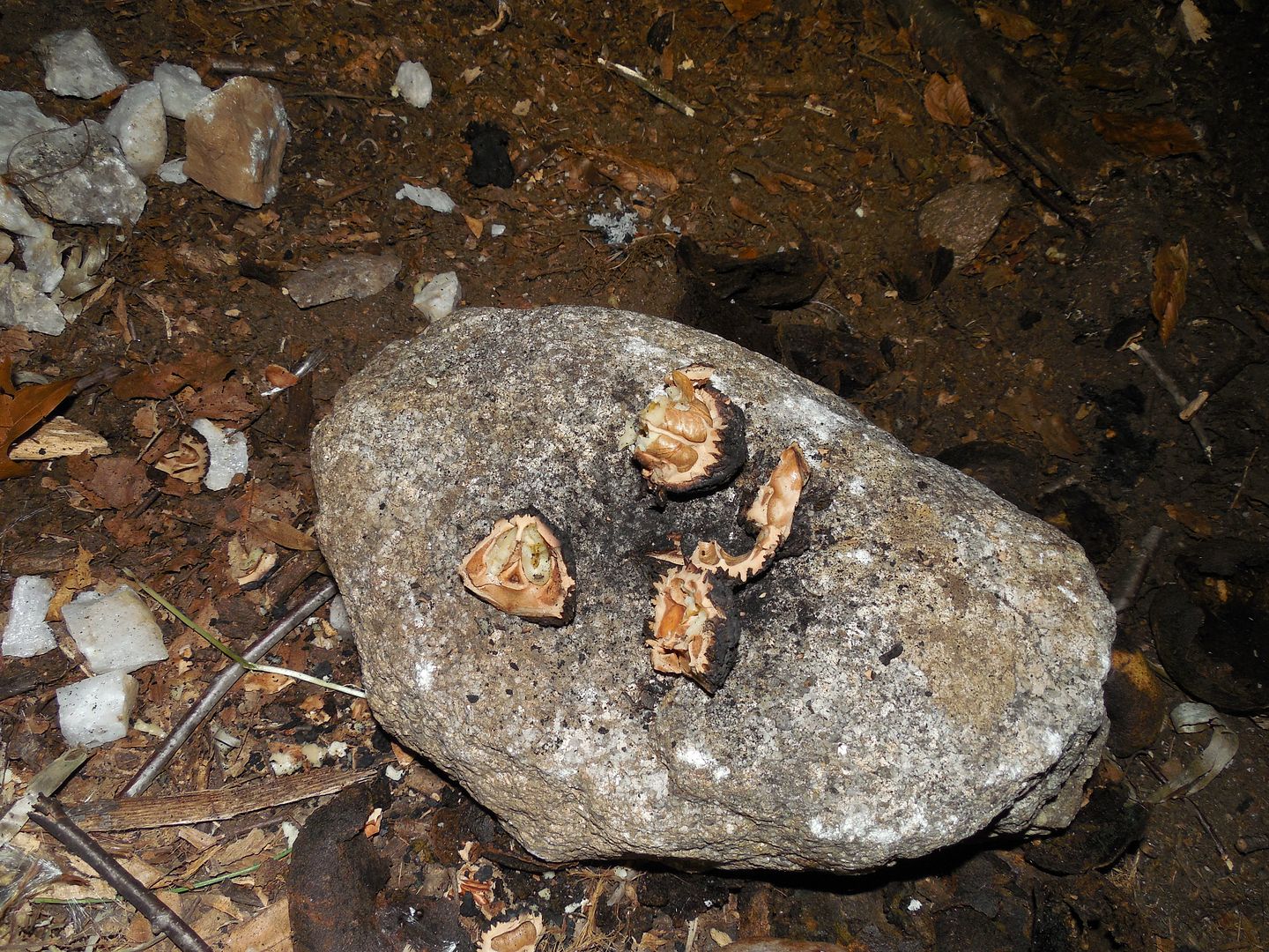

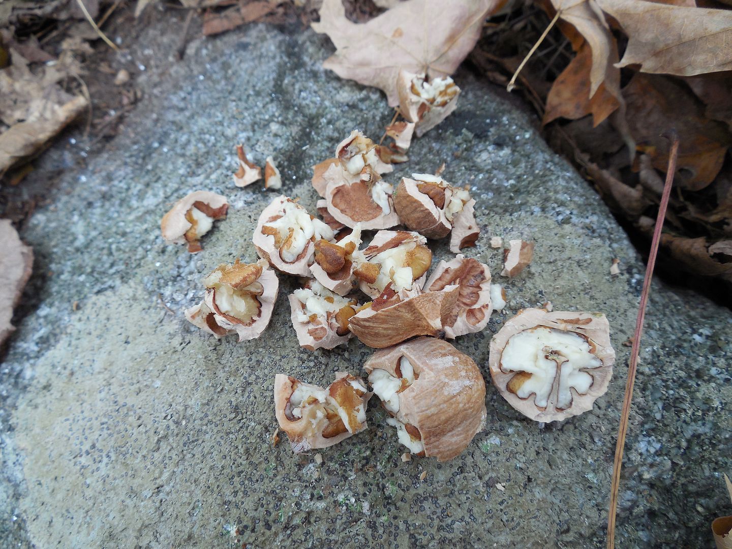

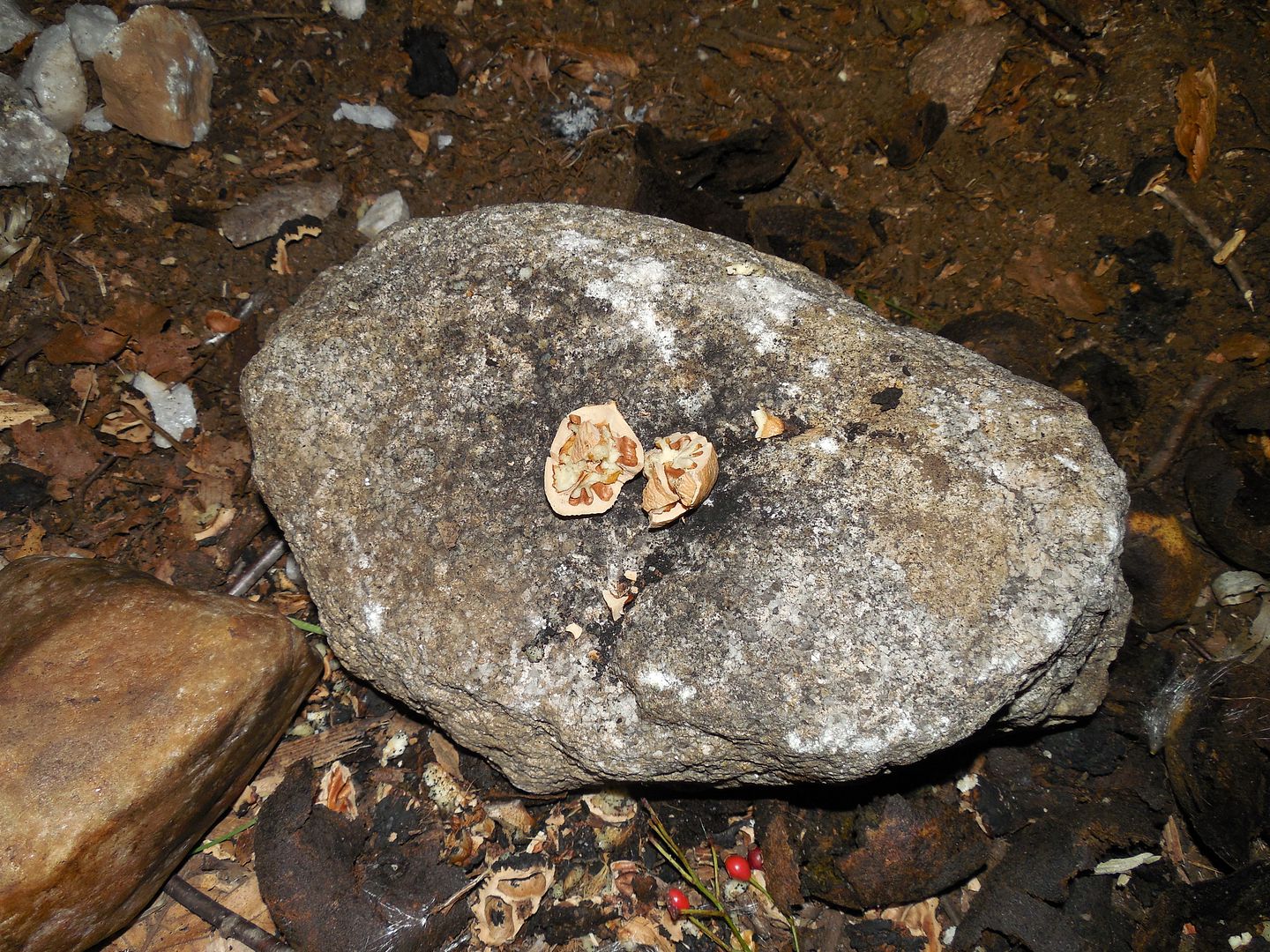

I am hungry so lets have a snack. I find using two rocks is the best way to crack both Hickory and Black Walnuts. It's best not to go all planet of the apes. Tap them between two rocks at first fracturing the shell. Add more force if needed however too much force will pulverize the nut. I think Hickory nuts are some of the best Fall forage. IMHO they rival most nuts purchased at the market. Like many wild edibles they don't run away. I didn't have to set a figure 4 trap or other contraption. I didn't have to fight them. They were just on the ground for the gathering.

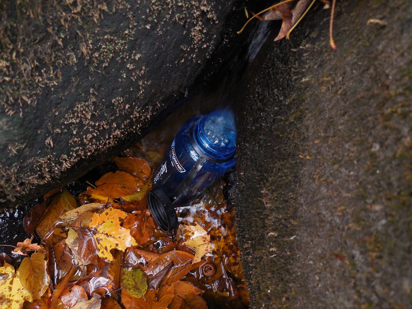

Time to get water then decide on my next course of action. Do I fish or forage some more before setting up camp? For now I had to watch my footing as the leaf litter was covering gaps and openings between these rocks.

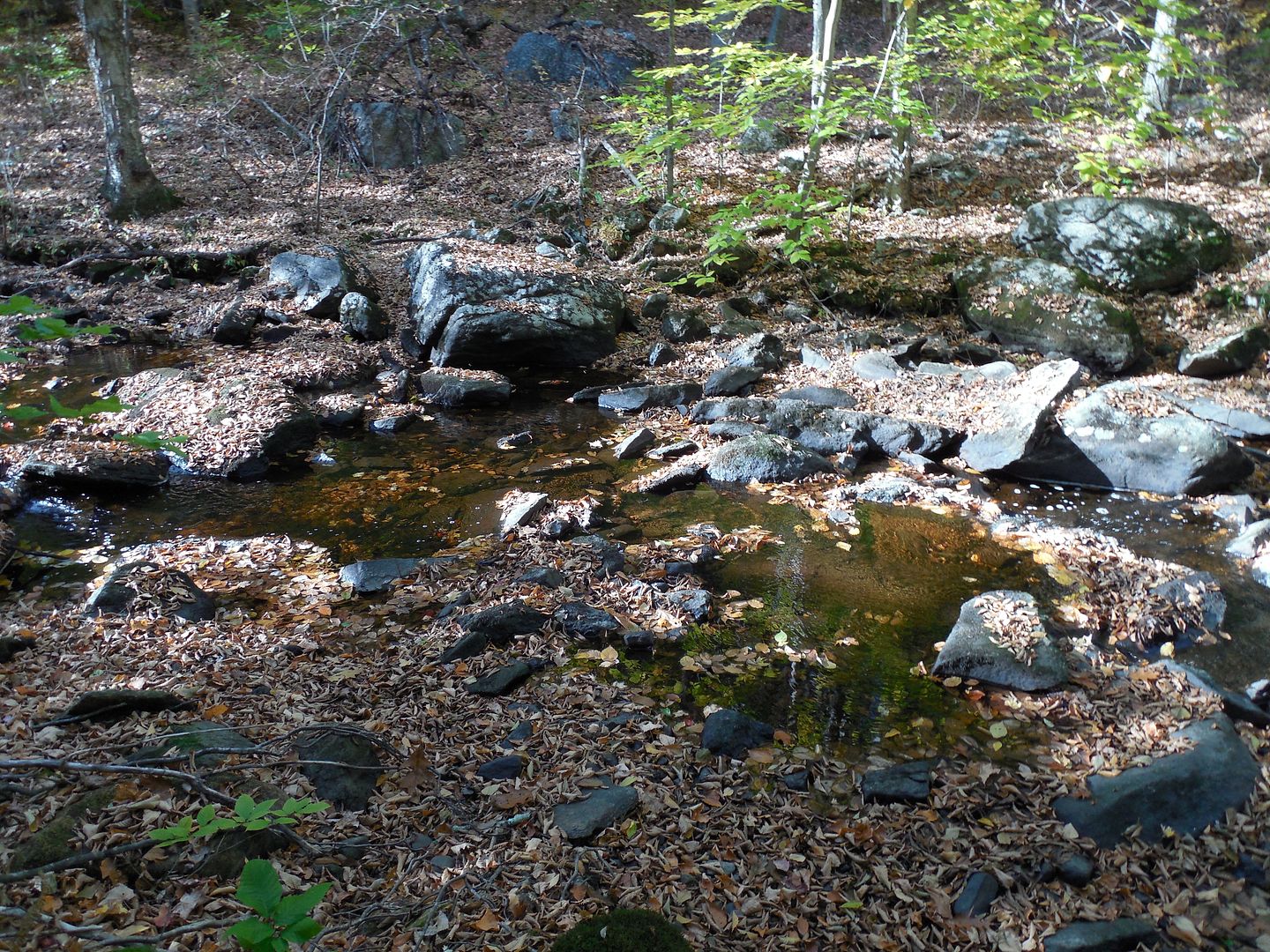

This brook which does hold trout was so low that even getting water was a challenge. I feared this would be the case based on my previous scouting. It was so dry fishing was more of a question mark than anything else. I would have to try my luck the next day in another stream.
Bad news for fishing but at least there was water.
But there is a problem. I only have one canteen. When it comes to foraging containers are a big part. Without something to hold water, food and other forage items you're very limited. I am used to having more than enough water storage capacity so for now would have to improvise. My kettle can hold about the same as the Nalgene so decided to carry it full. This proved to be a pain in the back side. I could do multiple trips to the brook however it's a very rocky area and I don't want to be hiking around from camp at night even with the headlamp.
Decided to boil the kettle water first in camp then worry about what to do with the Nalgene after. Odds are I would dump the water from the Nalgene into the kettle to be boiled once that was empty. Normally I like to have containers designated for just potable water but that really wasn't practical given the limitations. For now I would be walking around with a full kettle.

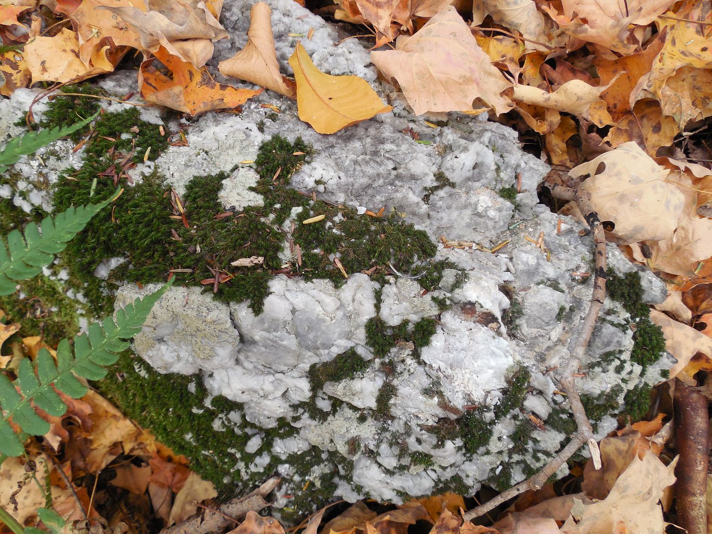

Some more quartz this time encrusted in these rocks. Used a smaller rock to smash a chunk off. Quartz can be inconsistent in it's ability to toss a spark off carbon steel. Sometimes it's great, other times it just crumbles. The life of the sharp edge on quartz tends to be short. As this has just gotta work best to get a multiple samples.
More punky wood, this time it looks like Hemlock which often has nice punkwood for firecraft. In the same area found Yellow birch bark. Happy about that as the kettle was getting on my nerves.

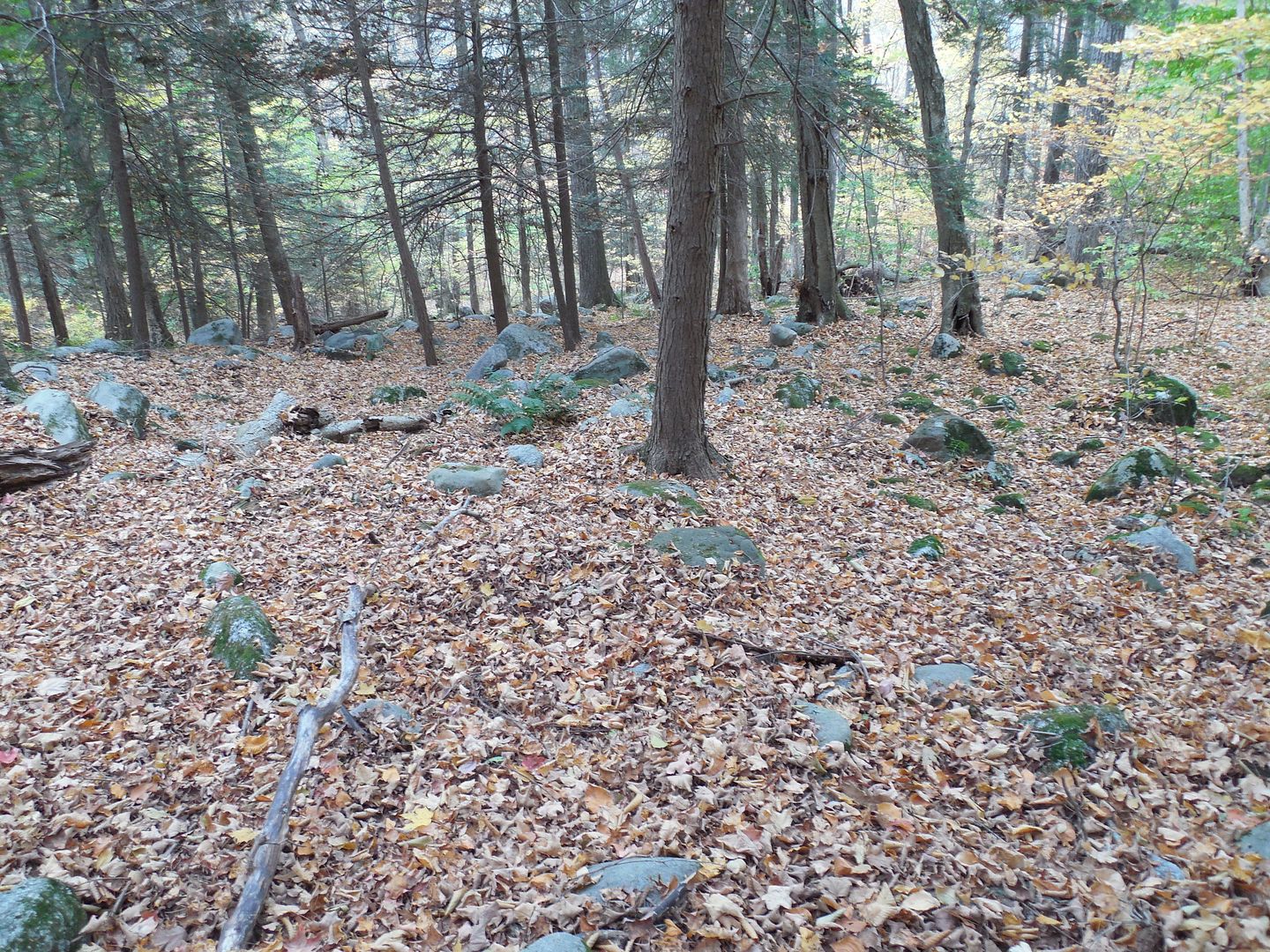

So why was it good? First and foremost the site had properly spaced small trees for the hammock and near as I could tell low widowmaker risk.
It even has some wild edibles. Ate a few partridgeberries found around camp. The location was near more Hickory nuts and not all that far from the brook though the distance was still more than I would like for a simple water run in the dark if needed.
There was more quartz here than any other place during the outing.
Speaking of quartz it was time for knapping. This knapping technique involves years of practice. One must understand complex physics such as objects heavier than air will drop and often things will break into small pieces when smashed by rocks. As stated complex stuff! I am looking for sharp edges. The leaves ate up many of the smaller broken pieces but found enough after during the smashing session.

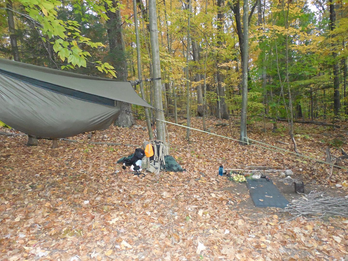

My camp. Nothing fancy but then again there is really nothing fancy going on. Just what's required to get the job done.

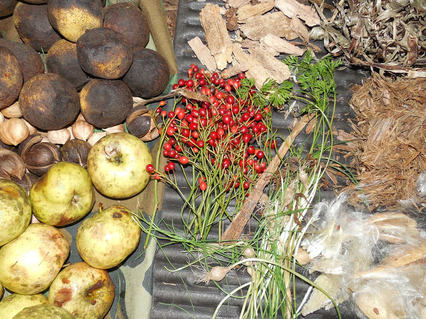

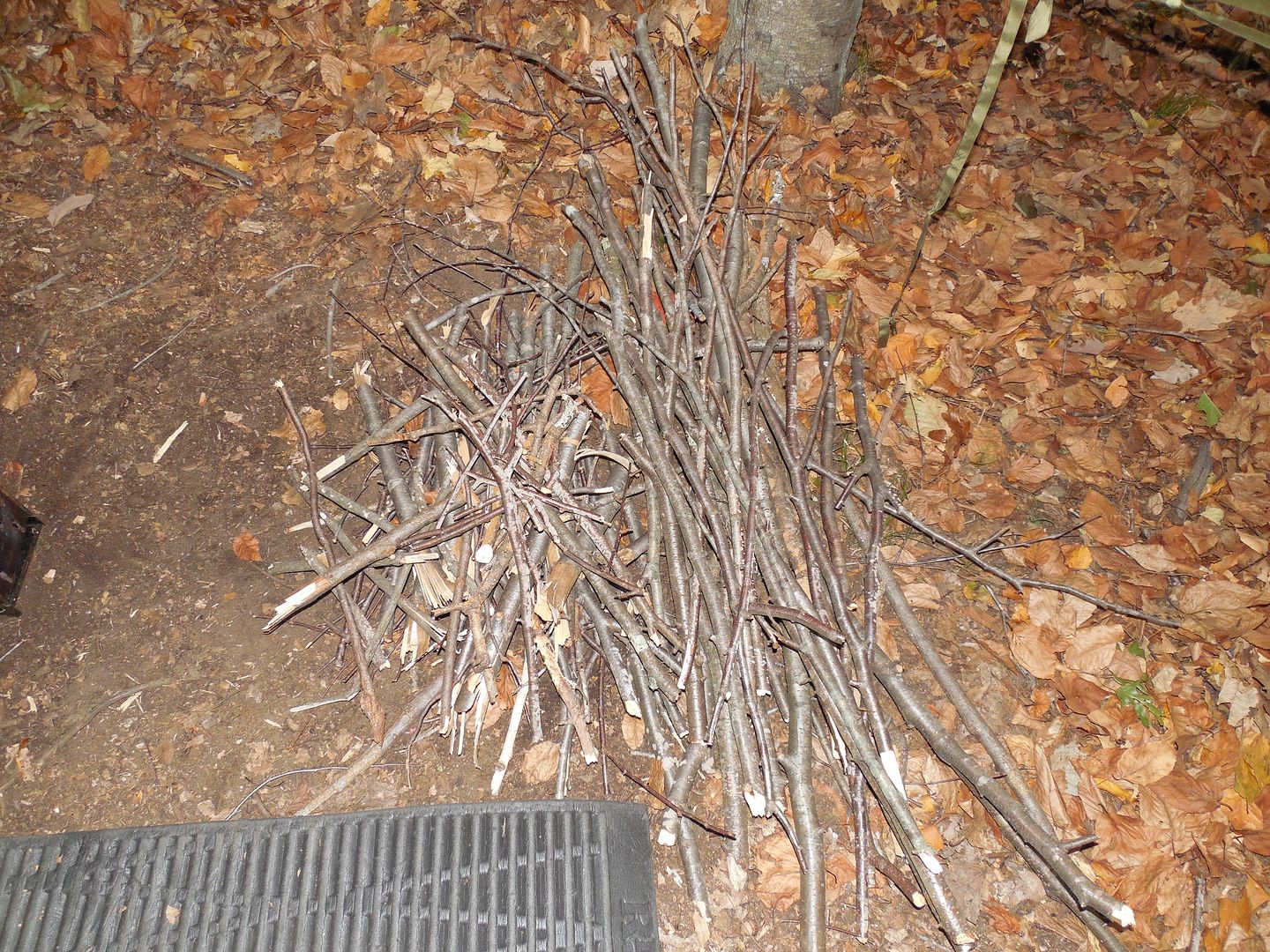

The harvest. My foraging including the friction fire woods and water.
The area had plenty of easy to find and process wood. The conditions were very dry. Lots of rocks to make a fire ring but decided to use the hobo stove for safety. It was that dry and with all of those leaves around it just seemed like the smarter play. There would be both pros and cons to this decision. The immediate pro being a hobo stove doesn't burn much wood.
Camp rocks to crack nuts and for other uses as well. The quartz is ready to GO!
Wild apples, hickory nuts and Black walnuts.

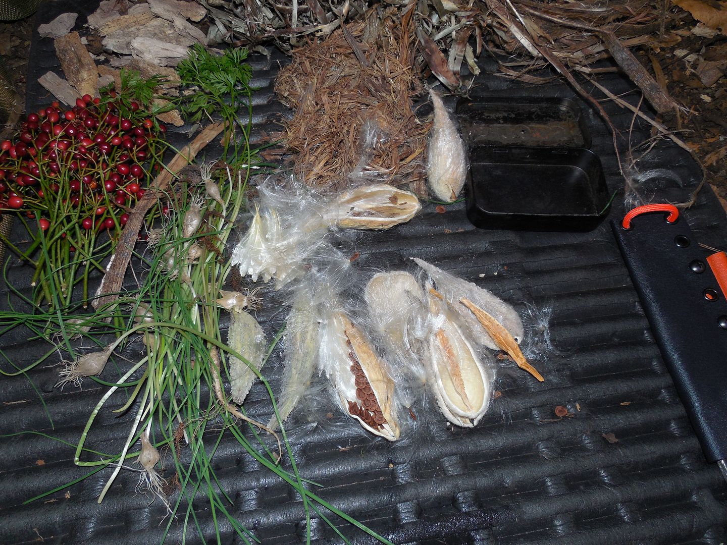

Wild carrot, wild scallions and onion, rose hips, punkwood, cedar bark tulip poplar bark and milkweed.

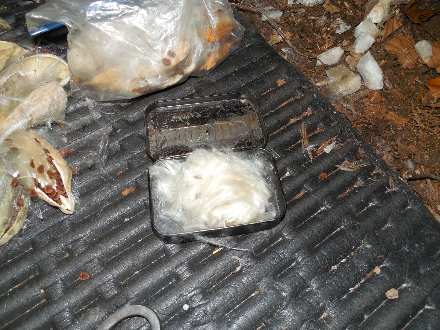

With the foraging done and camp setup it was time to start a fire. My field made options included making a bowdrill set or attempting a natural flint and steel fire using the foraged milkweed ovum, broken quartz, cedar bark, milkweed fluff and my knife. The 100% natural flint and steel fire using only items foraged on the same outing with a carbon steel implement, not pure dedicated striker is the holiest of holy grails of flint and steel. Well this is maybe a bit less holy as I am using a full sized striker knife but it's still darn holy just the same. LOL! The real question is will it work?
From the left to right. The first milkweed pod is too small and green, the next is larger but still too green, the third still has it's fluff so the ovum could be damp, the fourth pod is open with ovum exposed which is good and the last is just an ovum which is ideal. I forged more than what's shown in the picture. Milkweed isn't very common in my area and wouldn't want to depend on this firestarting method. Much of foraging is about opportunities that present themselves and should be taken within that context. You can be in the right place and season yet still not find with you're looking for. In this case the place was an open field and time Fall. I was fortunate.
I am not taking any chances. Made a layered tinder bundle to ensure any coal would hold.
And it worked but just. Took me longer than expected. As stated flint and steel with natural materials foraged during the same outing is an iffy proposition. To see the action you will have to watch the video for part 3.

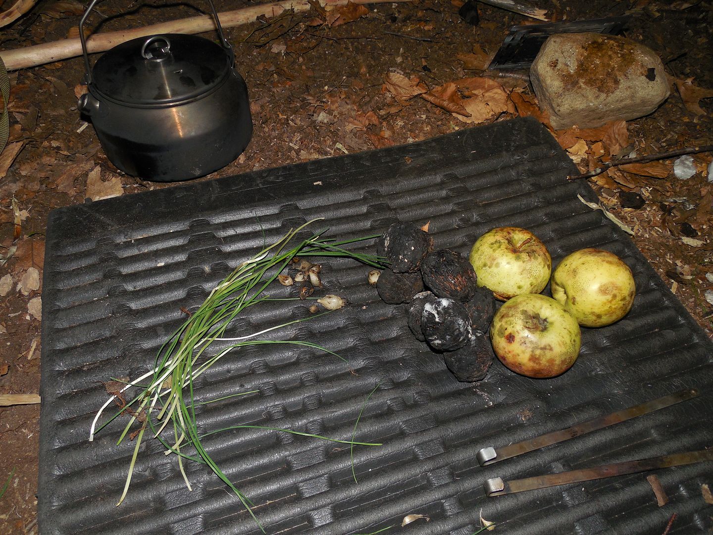

Put the grill on for the next step.

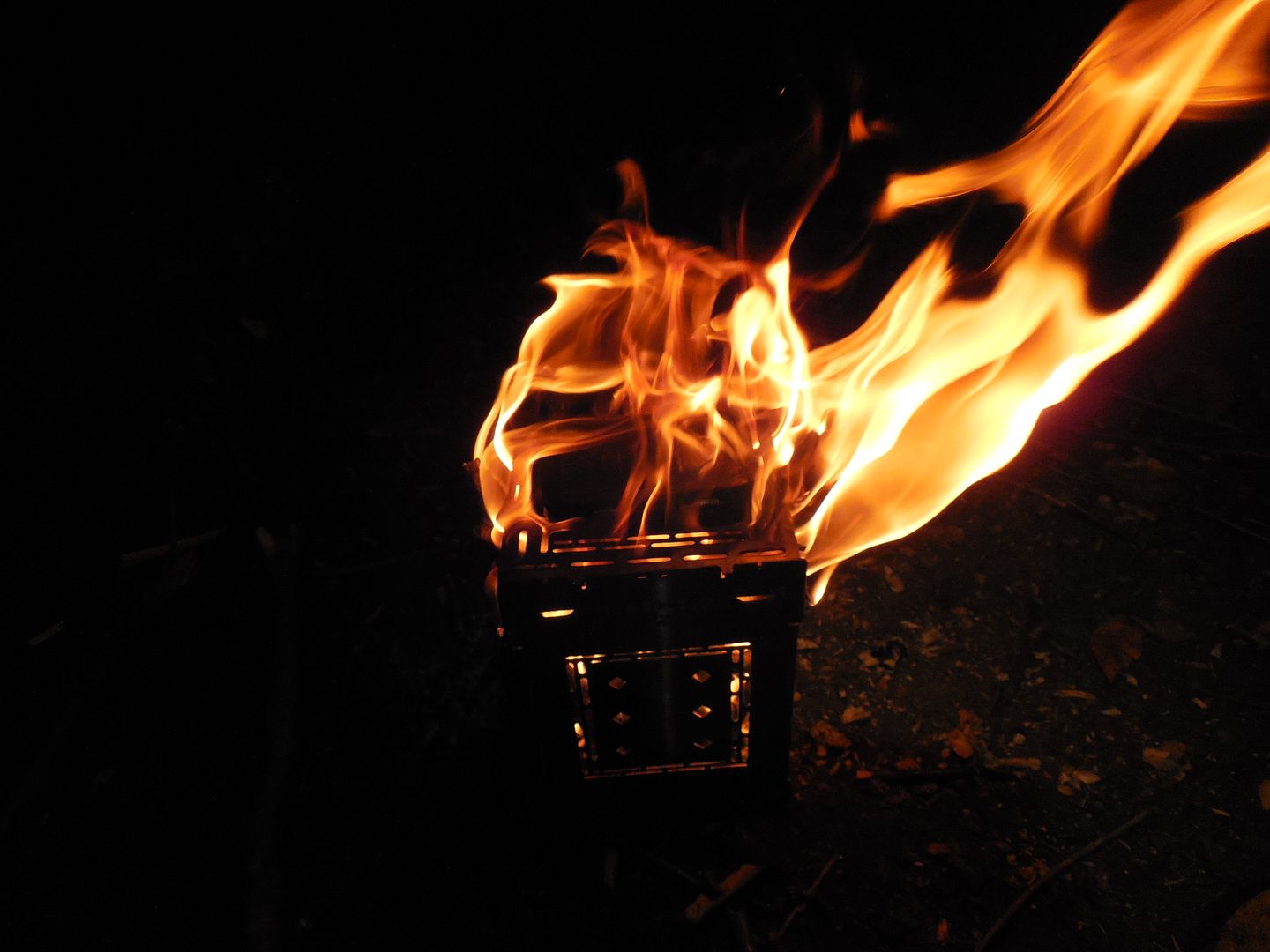

I really need fire for the rest of the outing but my hobo stove won't hold coals all night. The available methods are the remaining milkweed ovums, packed foraged chaga fungus and as of yet hypothetical bowdrill set. I gotta be honest here. That sucks. There is a reason why people carry lighters, ferro rods and matches. Modern methods aside the next most reliable and easy would be flint and steel using charred materials. This was the primary method of starting fires for generations. That said I don't want to cook my bandana and don't have any cotton clothing. But that's not necessary and I question if people really charred their clothes back in the day. What I did have was plenty of annoying milkweed fluffy flying round, punkwood and bark The solution was a fire chain. The initial fire is used to char materials for subsequent fires. Let's start with the milkweed fluff.
It works so much easier.

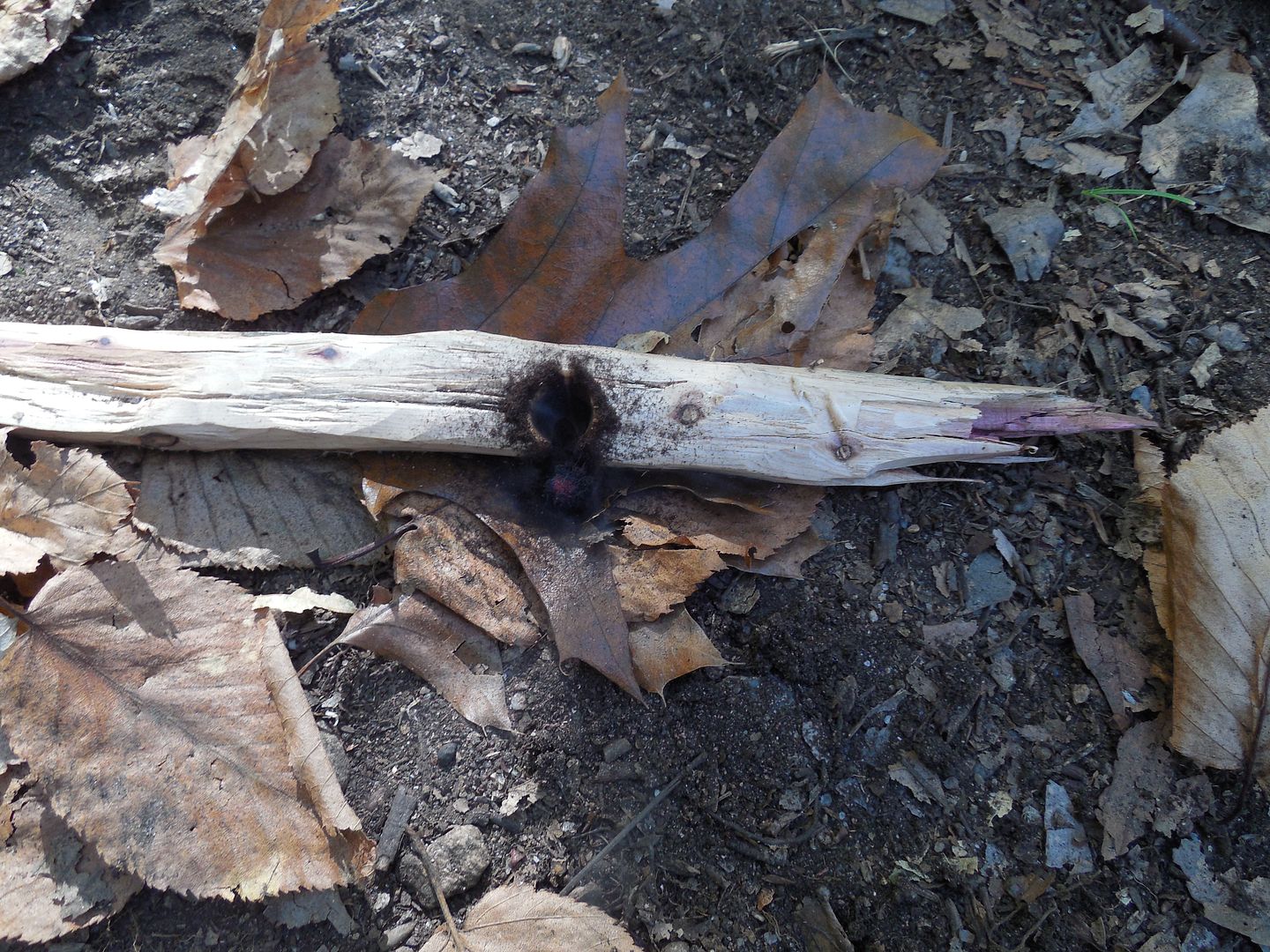

Now the punk.
Bingo.

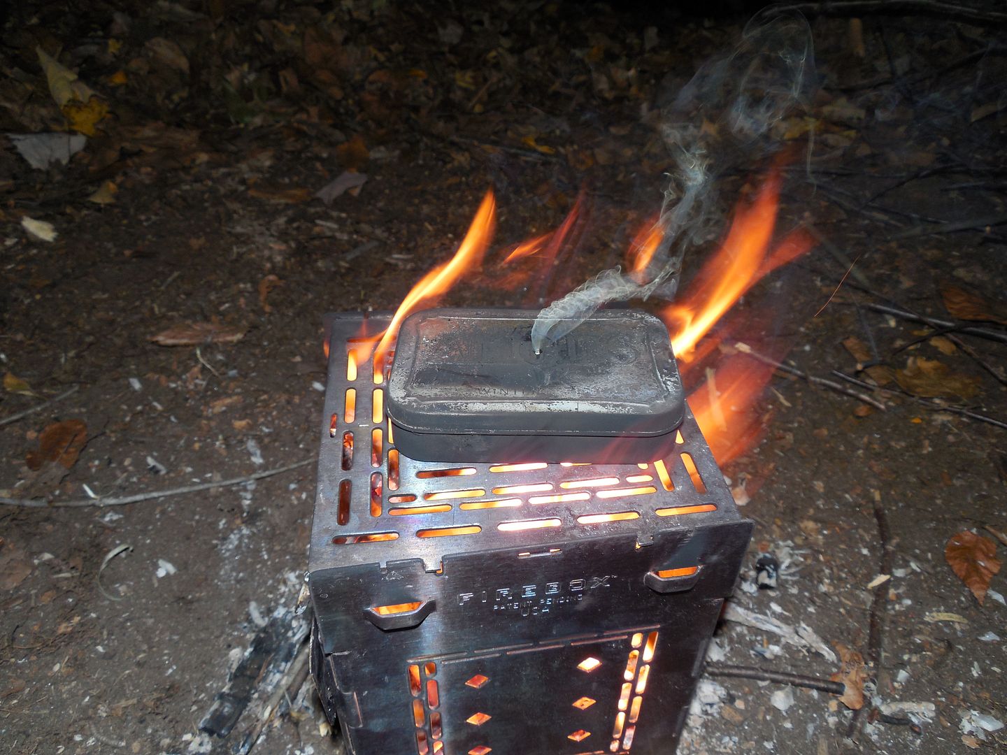

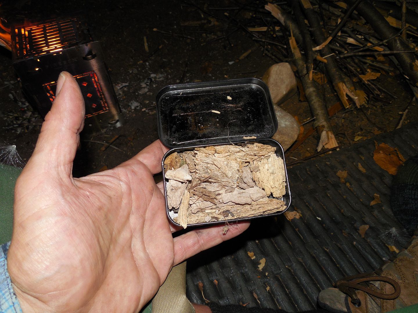

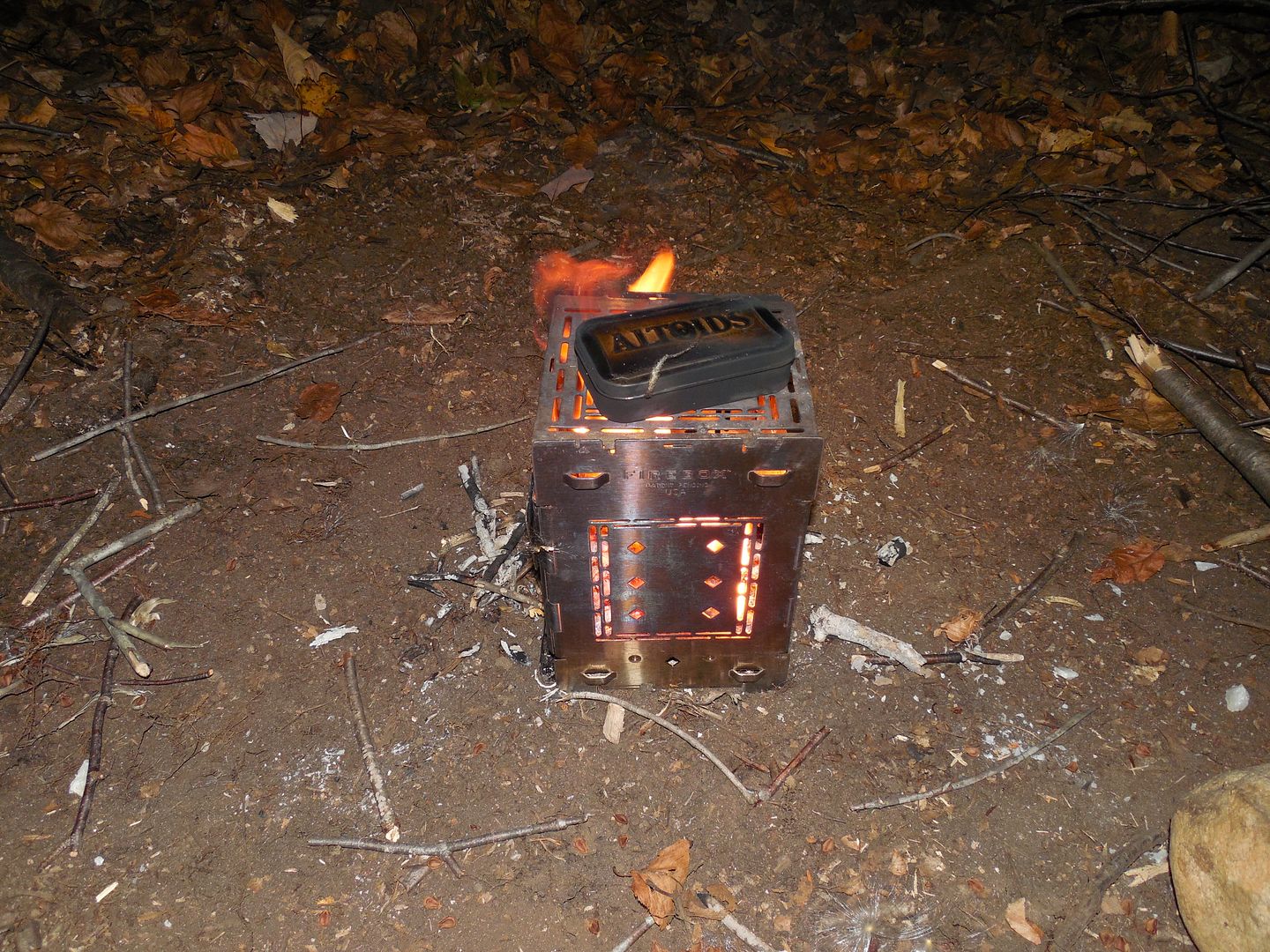

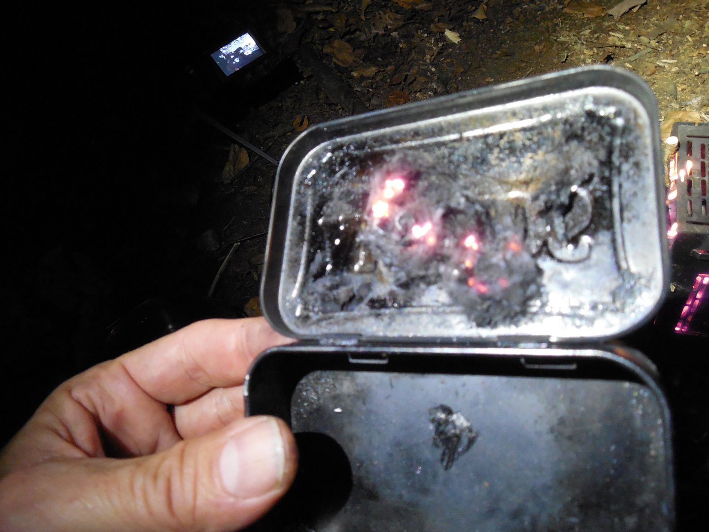

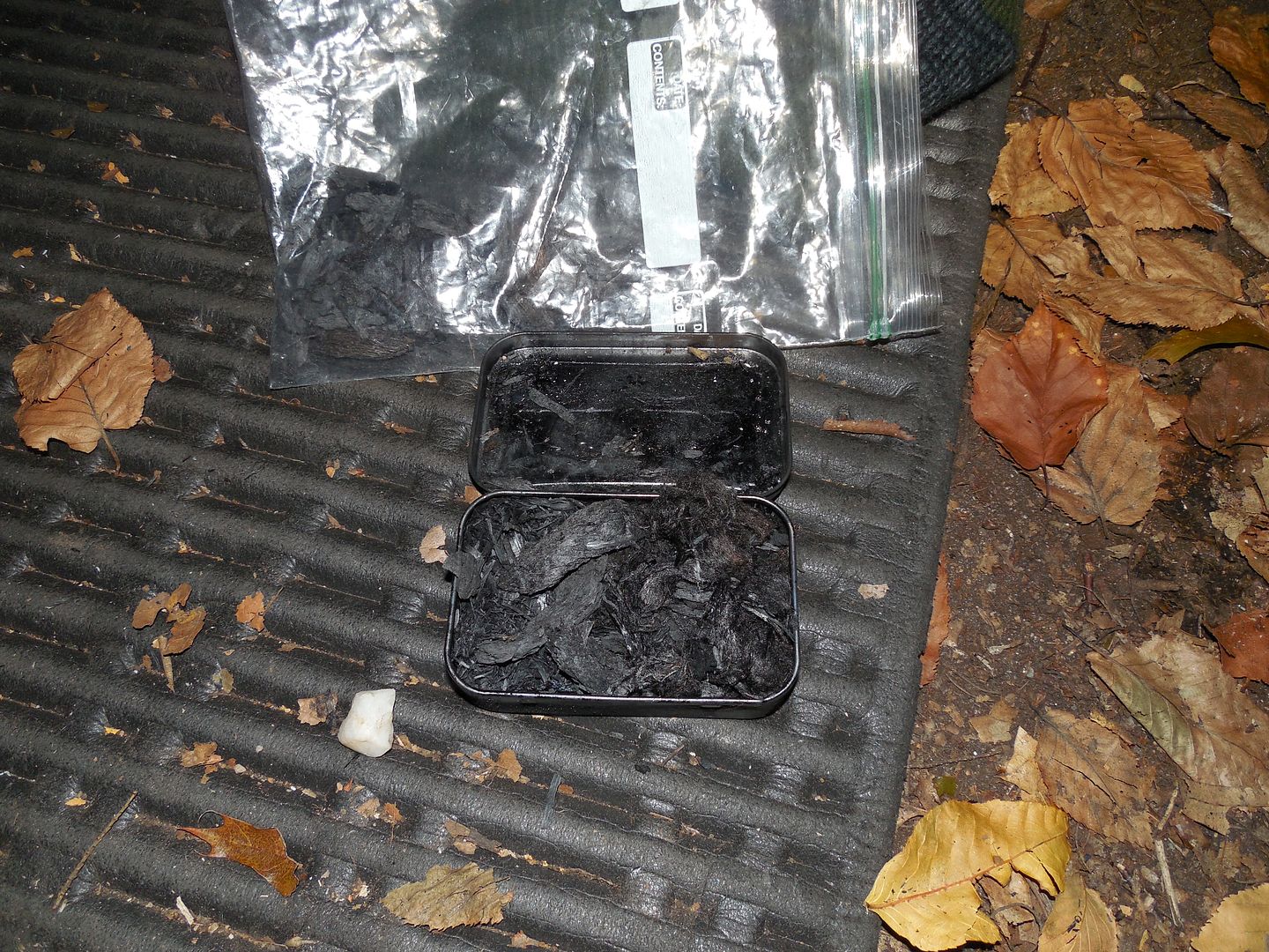

One spark coals are totally possible. Clearly charred materials offers enormous advantages compared to other marginal methods.
I also charred some cedar bark. Ended up with enough charred materials to stuff the tin to capacity with overflow in a plastic bag. I will be using this charred materials for this and future trips. When the charred materials gets low I will make more adding links to the chain. I now had two field made means of starting a fire.

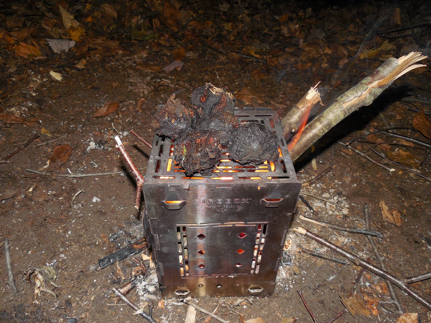

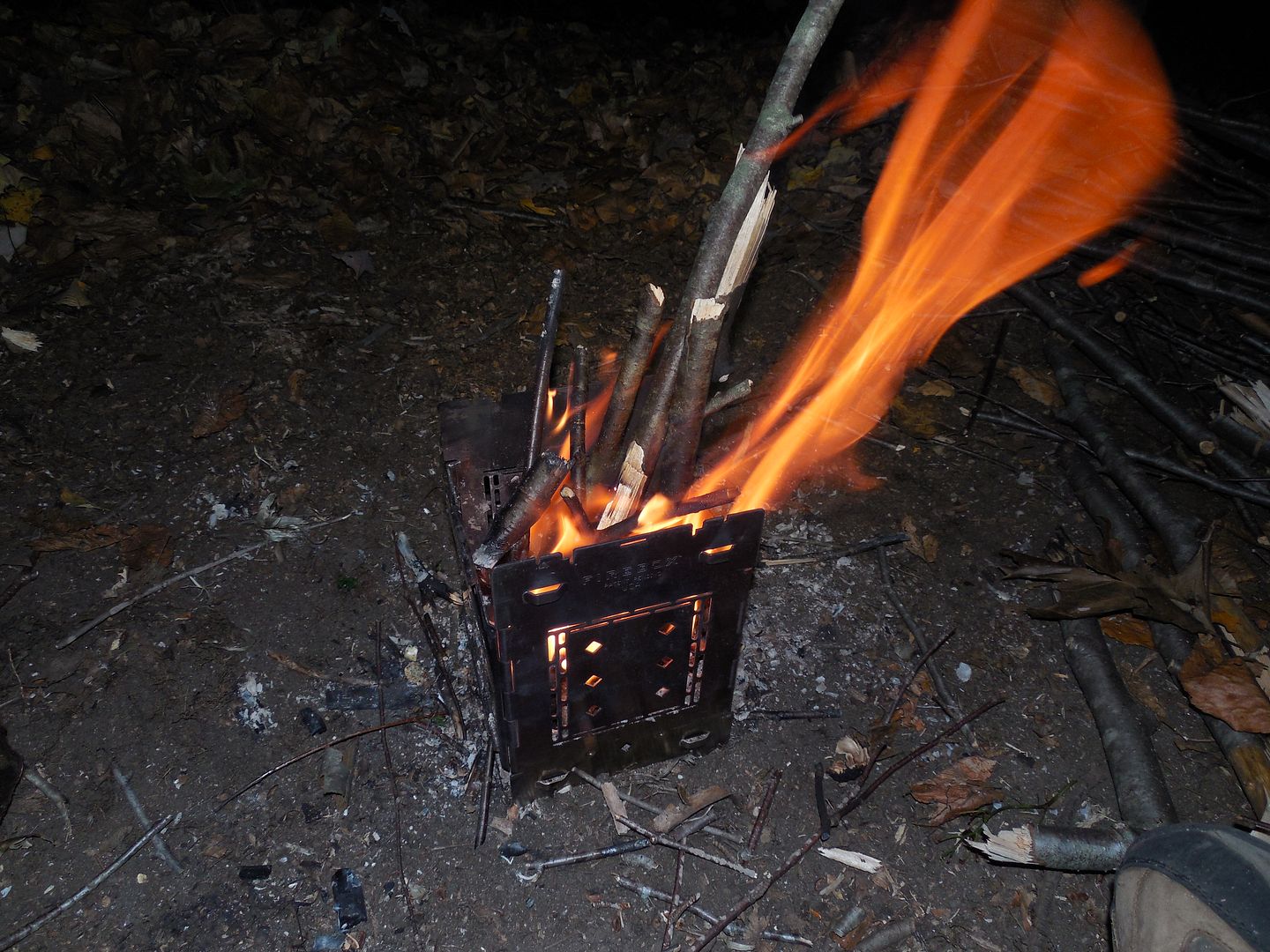

Tossed in a good amount of wood to get a nice coal base for cooking. Hobo stoves often require more fussing around than a traditional fire ring.

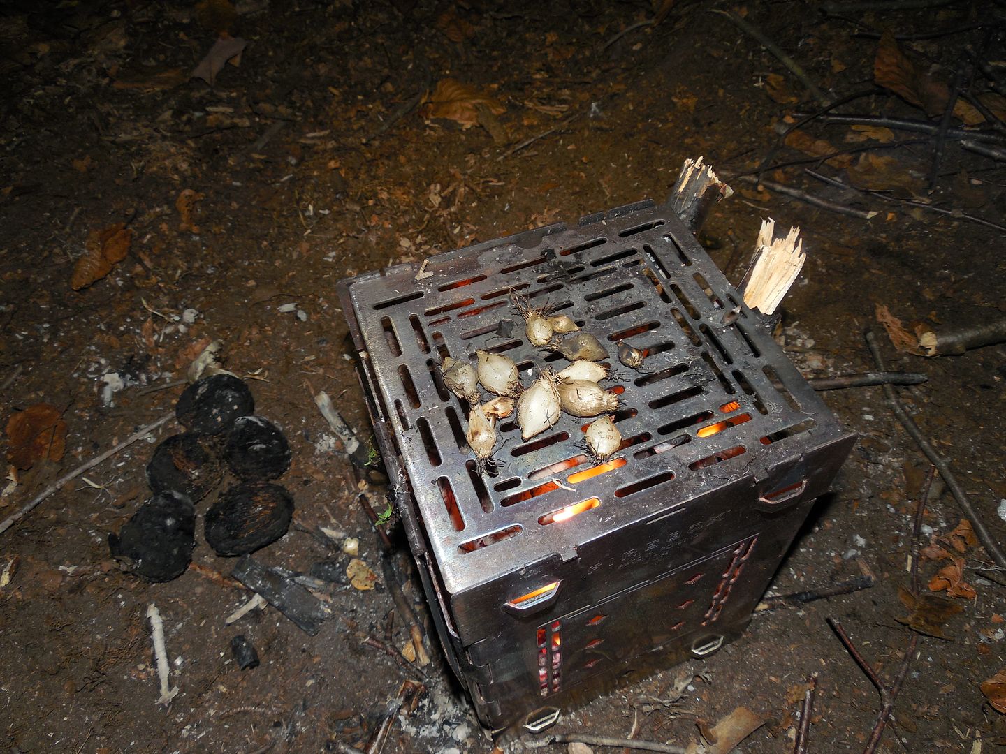

Roasting them over the coals 5 at a time.
Time to roast those wild onions.

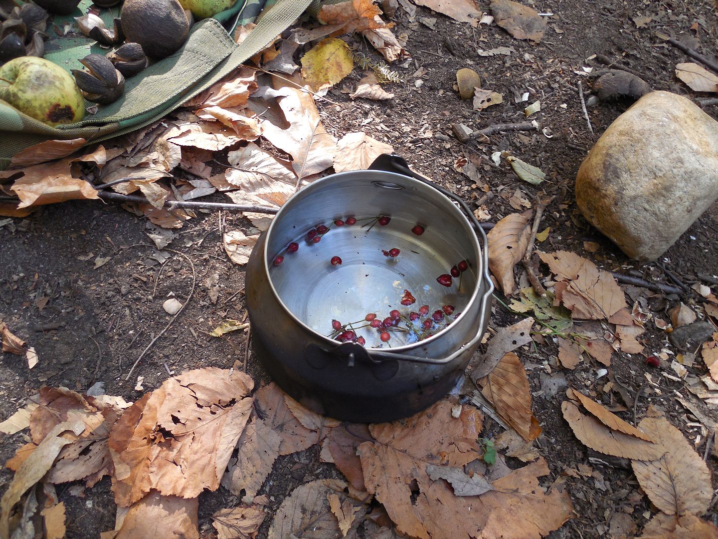

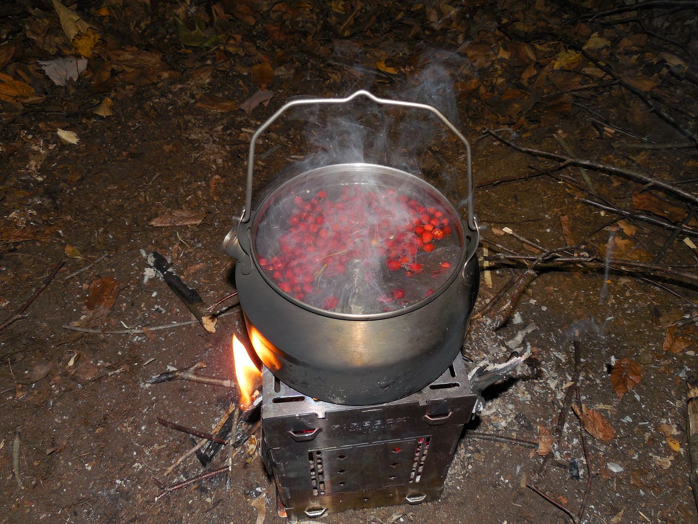

Let's put the tea on!
Looks like the tea is doing well.
All done. It has a nice color and dang am I thirty. One of the downsides of not drinking all day and moving around. Oh well it is what it is.

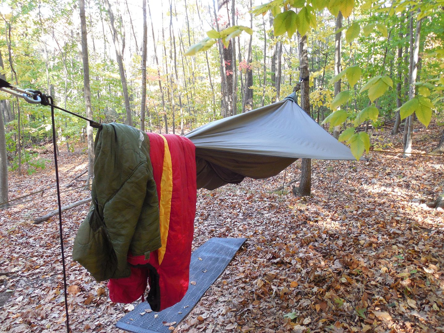

It was a good if not a bit chilly night. I like to hang out my bag and other insulation kit if weather permits.

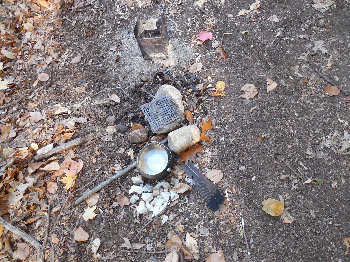

Looks like a wild party. Broken rocks, turkey feather, shells, husks and ash among other things. Crazy times for sure.

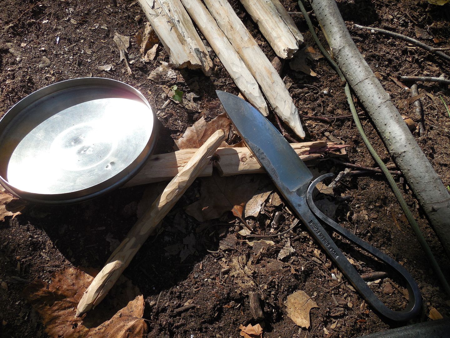

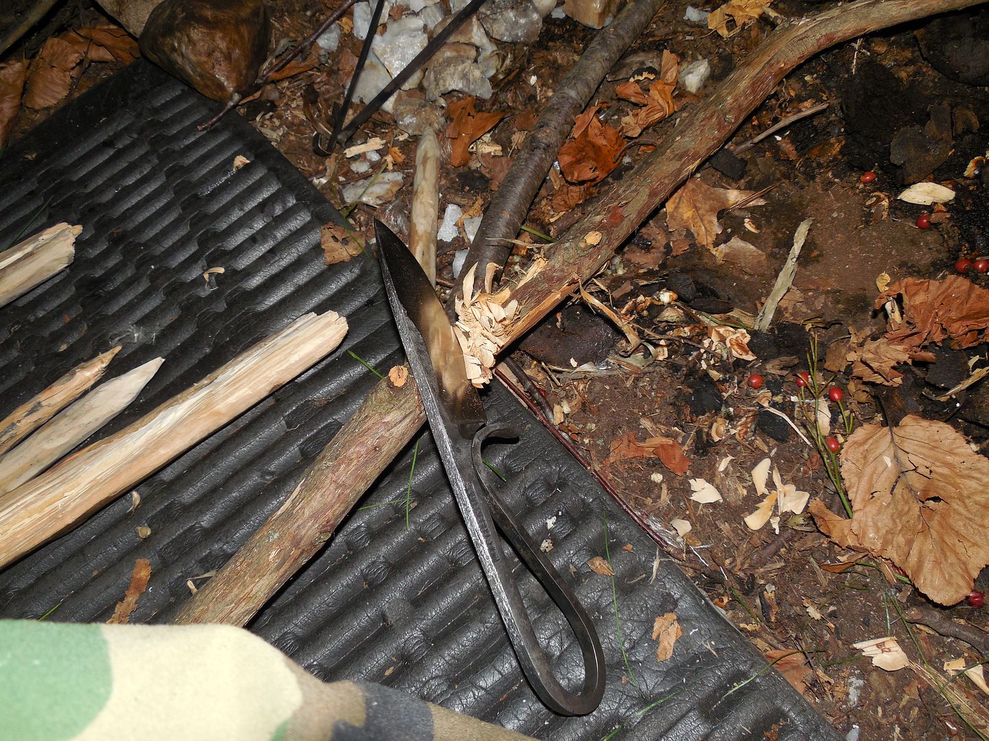

When out and about I picked up a bow for the set. Gotta start that fire for the tea somehow.
Why am I working on a bowdrill set? I already made 2 methods of starting a fire so far on this outing? Simple. I want 3 reliable methods and a proven set in some ways is really good. I wanted to try the lid of my kettle for a bearing block. I would use the bandana as a heat shield for my hand.
Ready to GO!
And it was a no GO! The spindle was too small or maybe the idea just sucked as I am no master of anything. I am going to revisit this idea again but for now would be using the oyster shells foraged a week before.

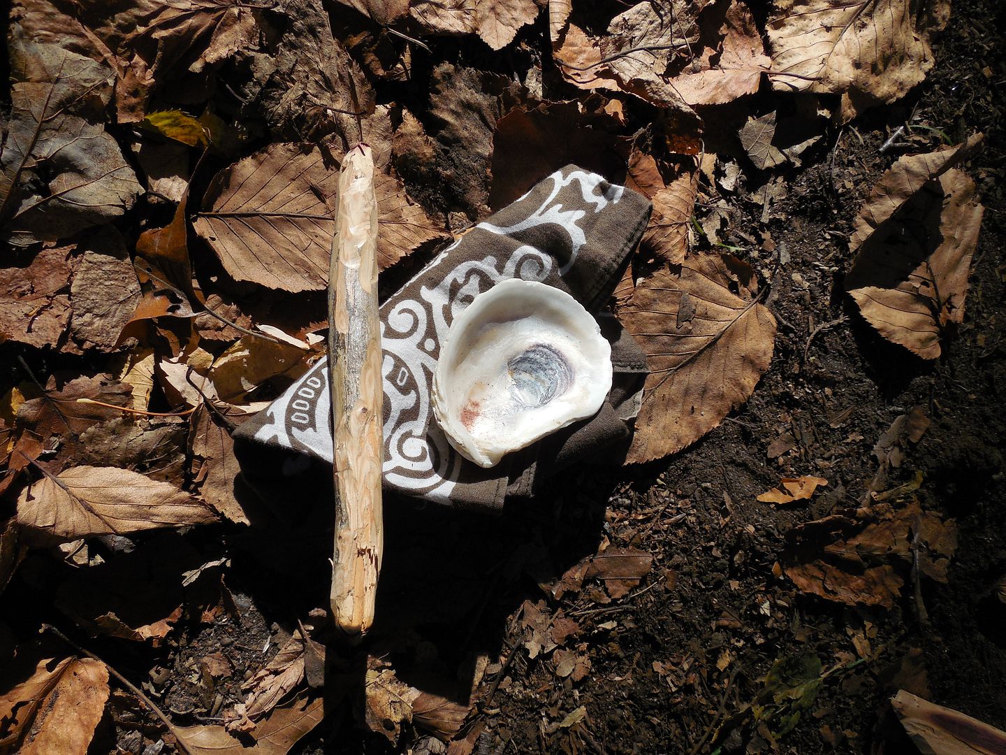

The shell bearing block did the trick.

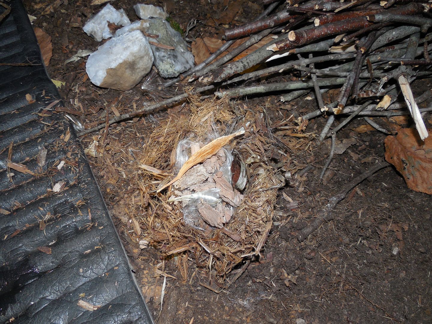

Used some of the left over bark and other tinder bundle materials to blow that coal into flames. I nearly lost the flames when putting the bundle into the hobo stove. Found it harder to ignite the hobo stove using a flaming tinder bundle than a twig fire with a raised back platform. Still results are the ultimate arbiter as to success or failure in firecraft. Once again I had success.

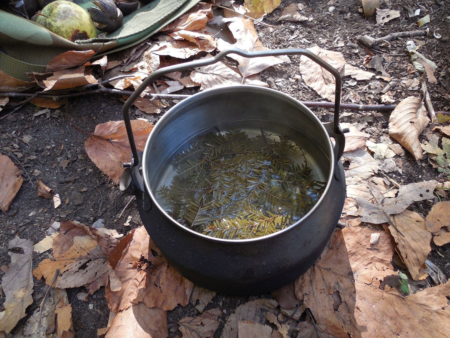

Once the water is brought to a good boil it's removed from the heat. Then after a minute or so the Hemlock needles are added then allowed to steep. My experience says not to boil the needles as the tea develops a turpentine (for lack of a better word) taste. The amount of needles and steep time are up to the individual.
Yup more nuts. I am starting to feel like a squirrel.
Might as well finish off the rest of the hips.

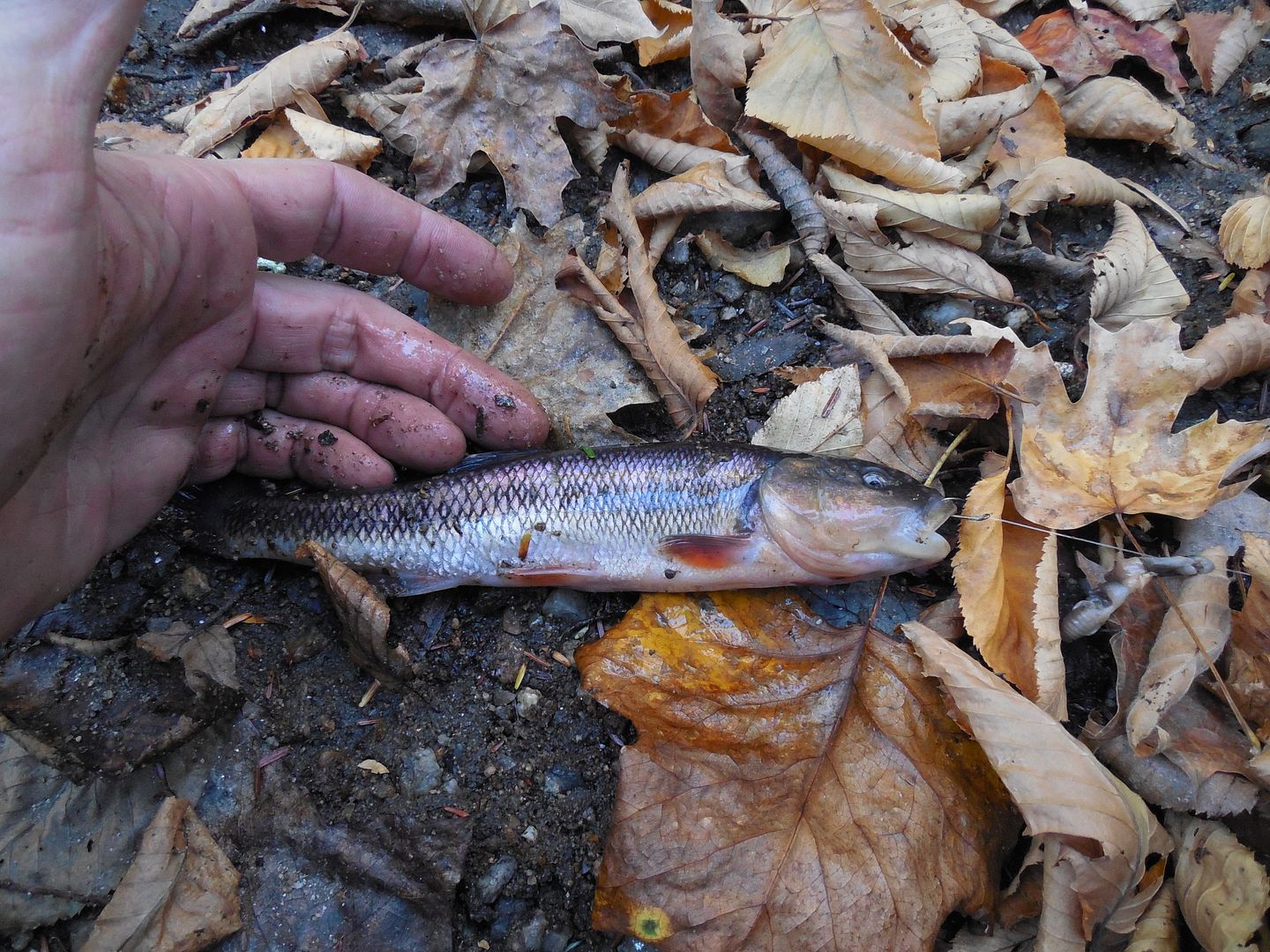

Hold on what's this?
Ok, it's not a trout and I never ate one of these but at this point beggars can't be choosers.

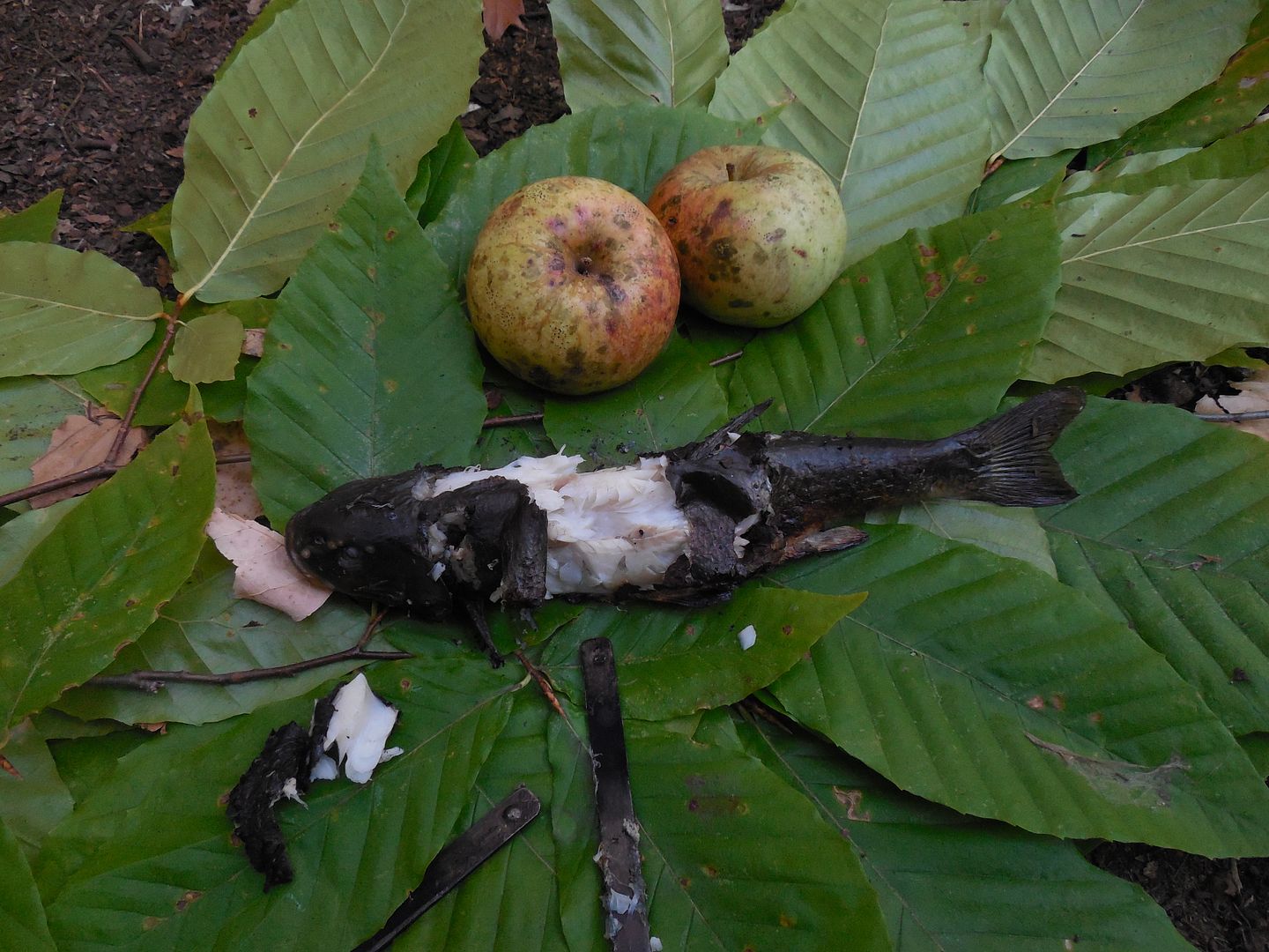

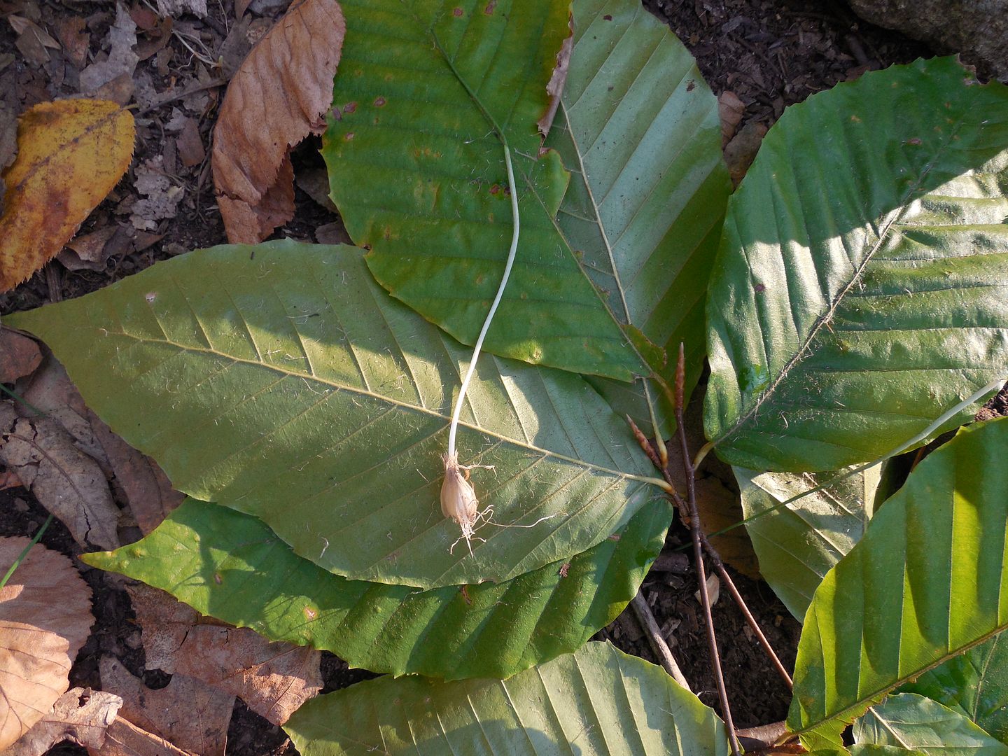

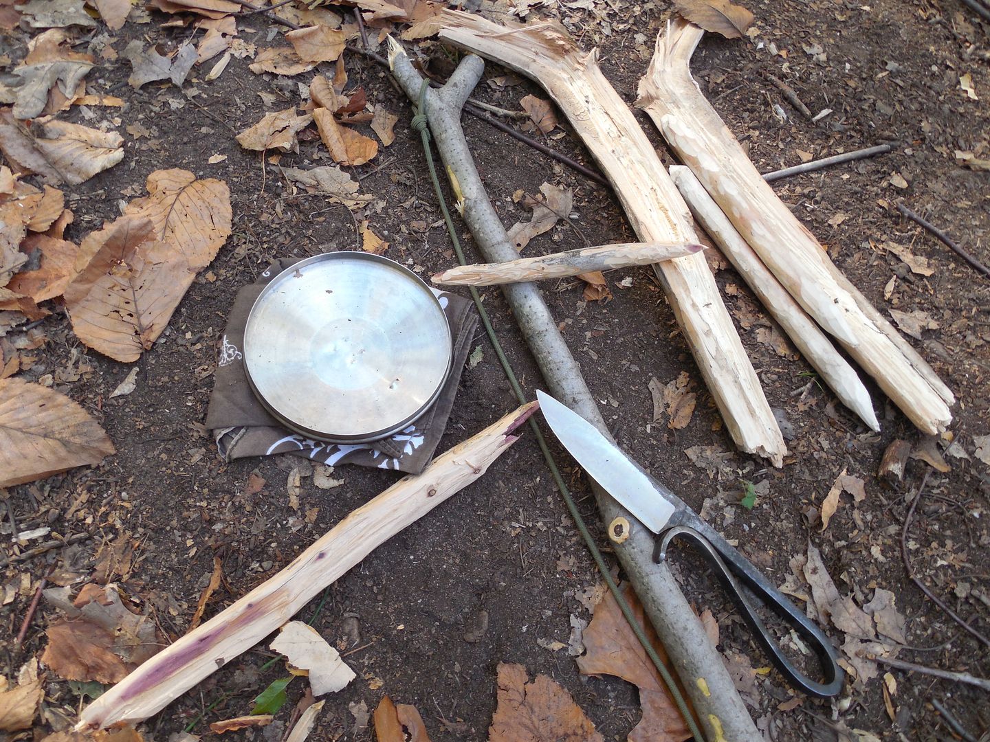

Back at camp. I don't have plates so made one out of leaves. Time to clean my catch.
I don't have much for condiments or other niceties but do have a wild scallion.
Hey it's something. LOL! Stuffed it into the fish.

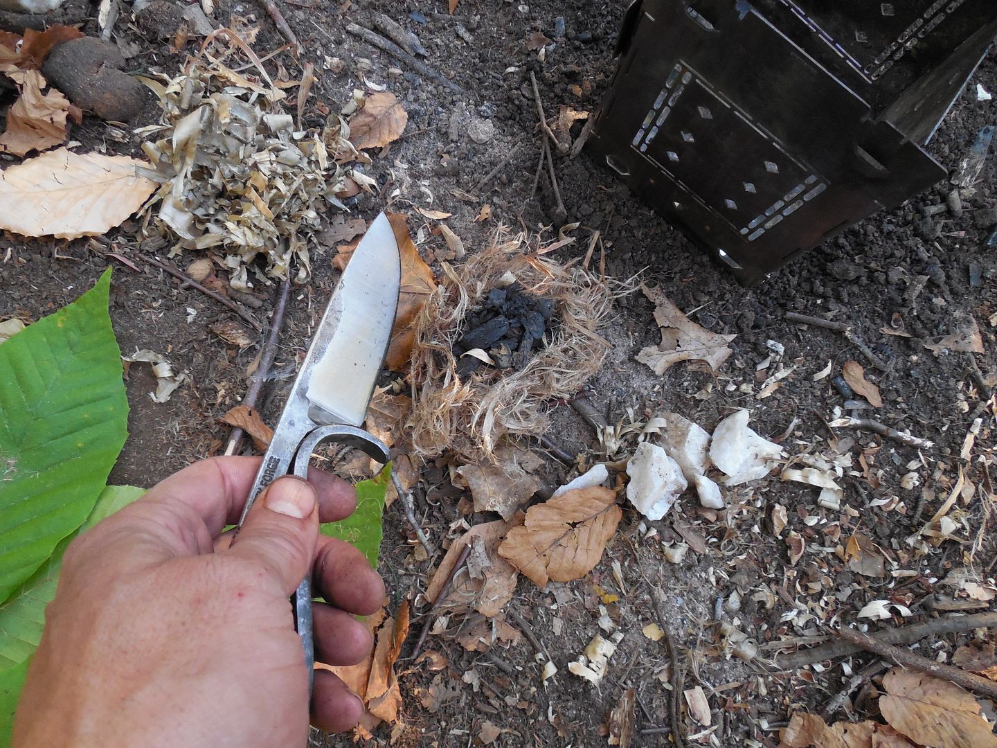

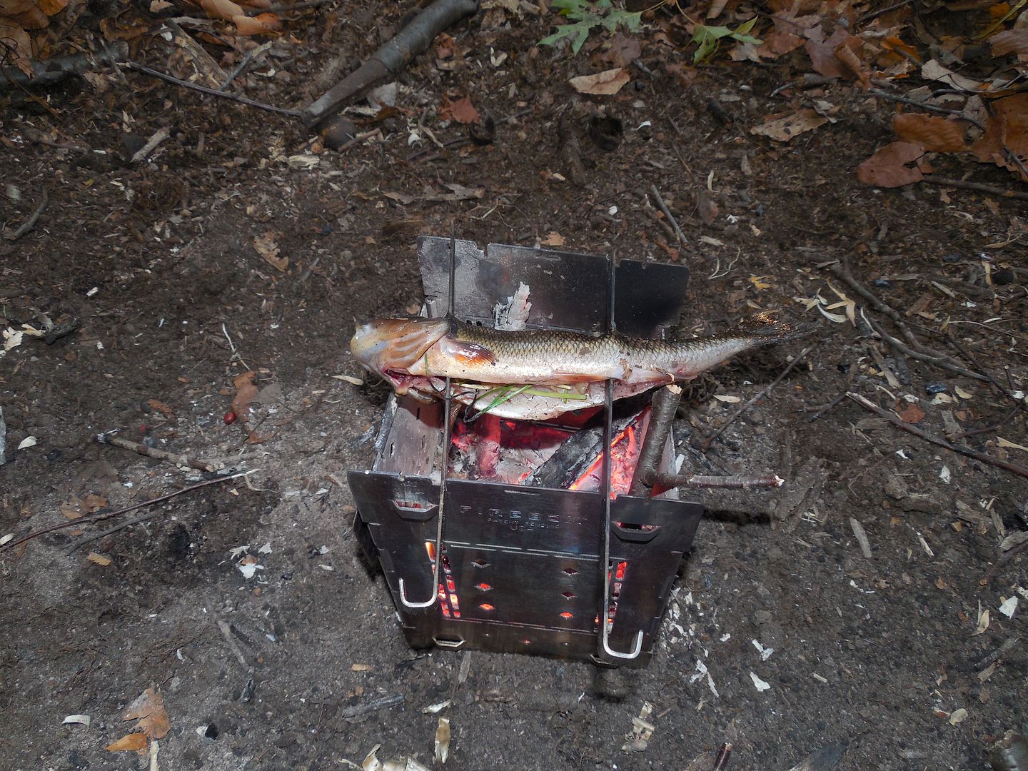

So it's time to see if all that charring of natural materials pays off in the field. I used more than was required but had plenty and wanted to take no chances. I think foraging among other things is about mitigating challenges and taking advantage of opportunities IMHO. Also it's just fun and that's really what this is all about.
The second link in my all natural flint and steel fire chain. With luck one of many.
I think it caught the first actual spark off the spine of my knife or maybe it was the 2nd or 3rd but who cares. This was so much easier than spinning a coal or trying to eke out fire from a milkweed ovum. If memory serves me correctly I was all out of cedar bark but did have the tulip poplar bark. Fluffed it up for the tinder bundle. There was no need for a coal extender or layering.

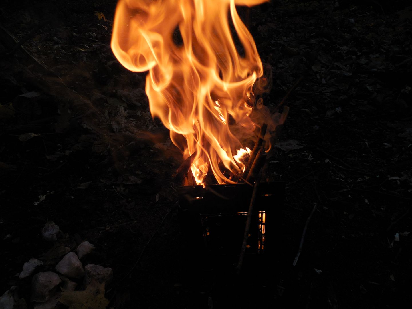

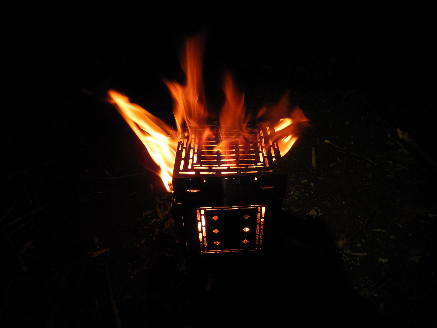

Flames.
Cooking!
Dinner. Yup it's a little fish and a few funky apples. No hiding that but it wasn't bad however it wasn't a nice trout either. Ultimately foraging is also a game of chance.

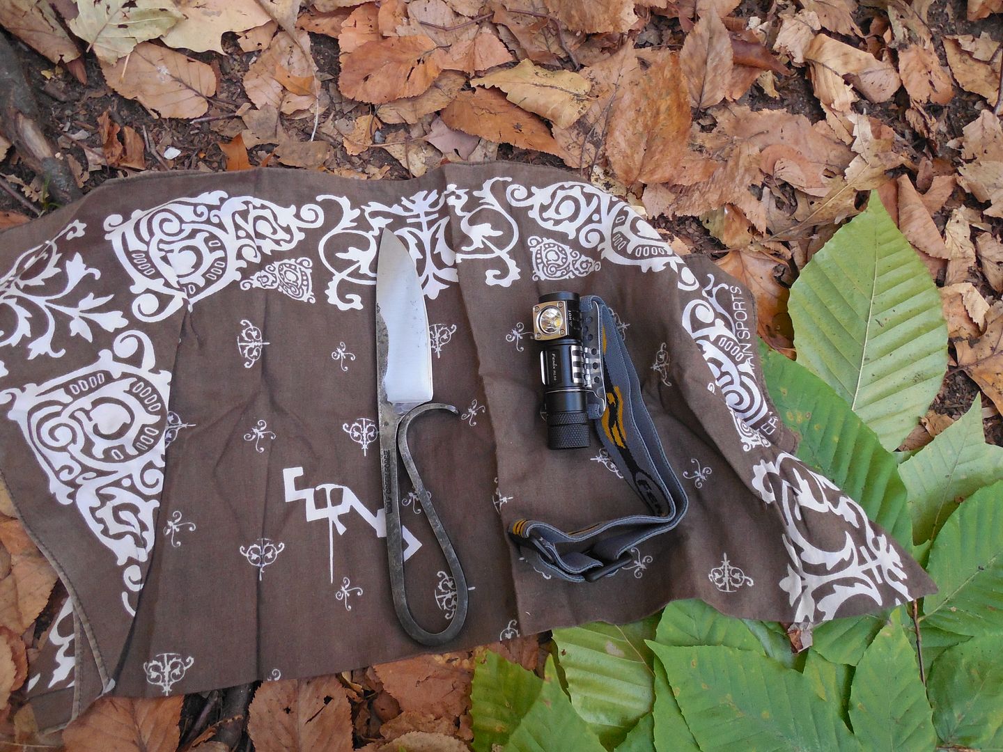

Some stand out gear items and missed opportunities. Everyone likes knives and lights.
The Wolf Creek Forge large custom striker knife was amazing. It held a good edge. I beat on it to split and cut wood for fireboards and spindles. I beat on it with rocks, literally dozens of times even striking the side of the blade by mistake more than once. I am no knife maker but to make a knife that can hold a good edge without chipping yet have the spine hard enough to toss lots of hot sparks shows an attention to detail. Not only that but the edge was relatively easy to touch it up after the outing. It shaves smooth. The Fenix HL50 so far has proven to be a rock solid performer. All metal construction, good runtimes, output and neutral tinted LED. There is much to like.

Wow what a great post, really enjoyed this and now I know which headlamp :D
The Fenix HL50 is a great headlamp. I am working on a comparison report. HL50 vs Armytek Tiara A1 Pro.
What a great post! It looks like you had everything covered and even a little extra. We don't have any of those nuts up here,but make up for it in the fish department. I would love to try something like that except I would have to bring a lighter for back up. Did you ever figure out what kind of fish that was? Anyway thanks for taking us along. I'm off to watch the videos.
Some kinda creek chub thing. Normally I pack at least 3 modern means to start a fire. Beating on rocks and rubbing sticks is on the edge IMHO though fun!
Thanks everyone for looking. :) The knife is a Wolf Creek Forge and it's a winner as well.

Thanks for the great post and videos! The fish you caught and ate is a Fallfish.
