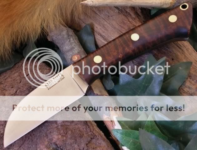

This was my BR TUSK originally:

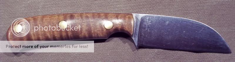

This is after adding a choil, reducing the butt and some other stuff you can't see:
A2 BTW-- just wrapped paper over a copper pipe of the right dia and had at it. In its orig config it was (to me) quite awkward. Now it "fits like a glove"!
