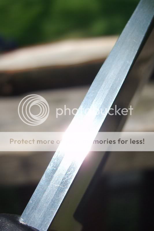

The logo on the blade will say Lam VG10 if it's laminated.
You'll also be able to see the lamination on the spine:
The blade that you're asking about is most likely laminated. I guess it's possible for a dealer to have some non lam. blades left,but it's doubtfull.
