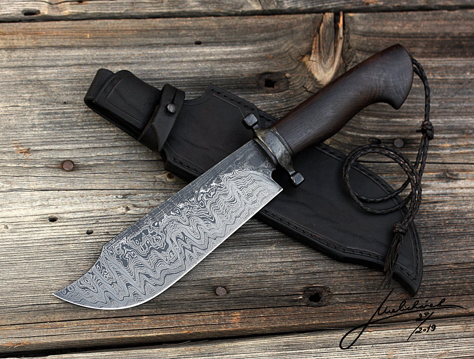

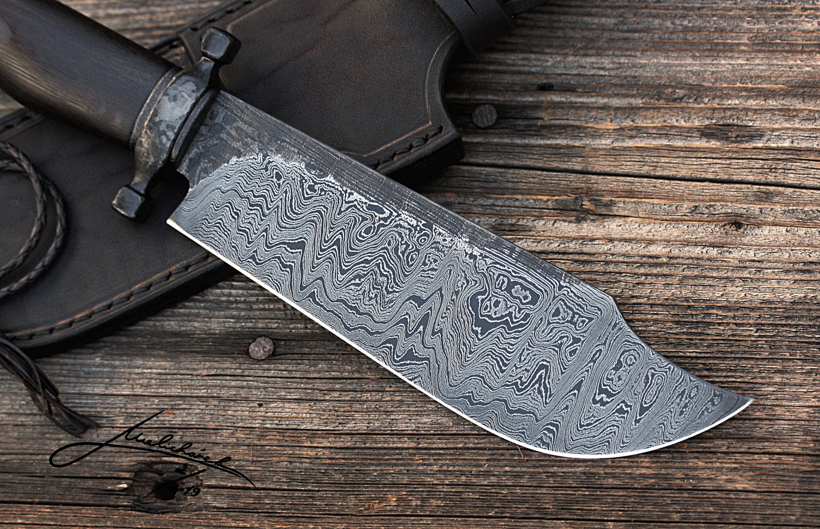

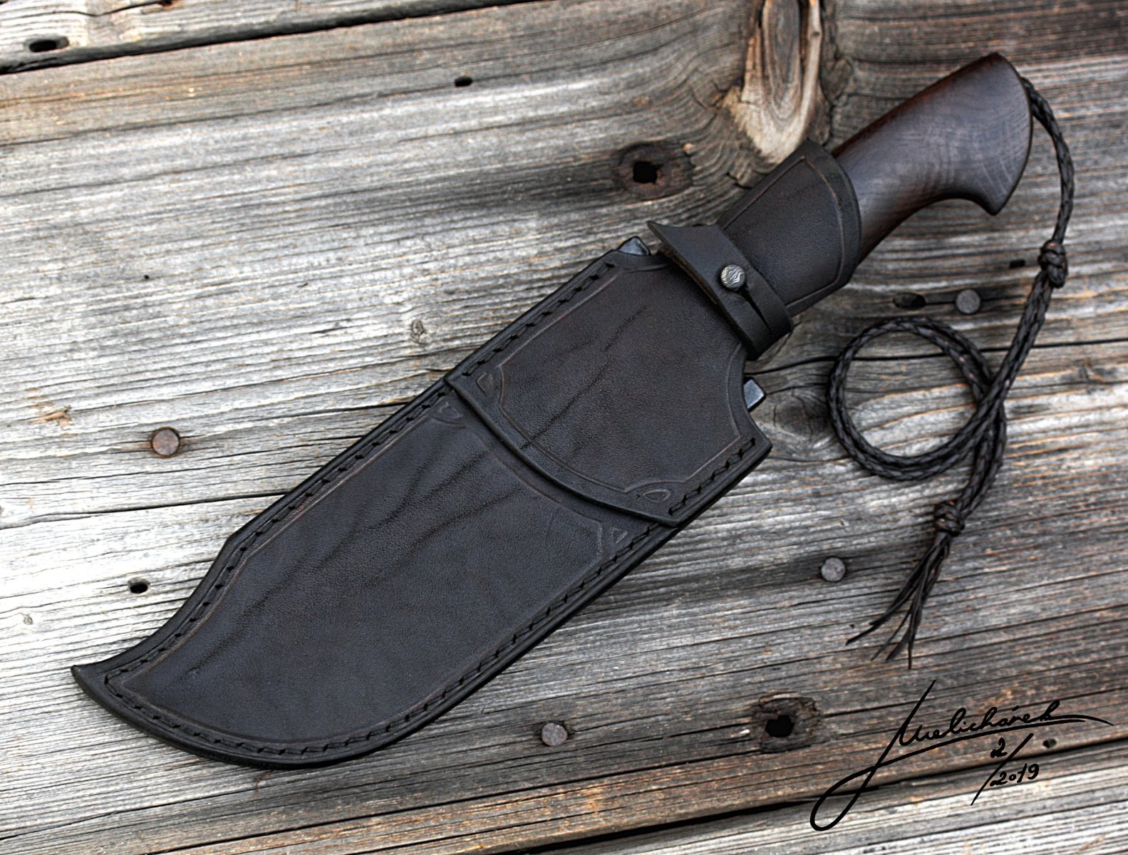

Today i finished this chopper bowie in "wild west/frontier" style :) I hope you will like it :)

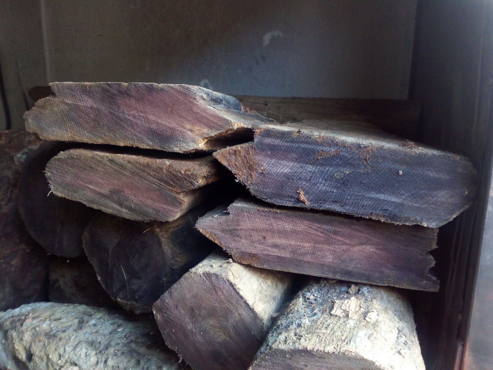

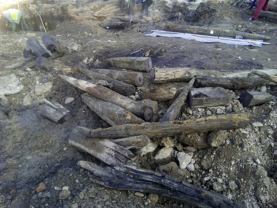

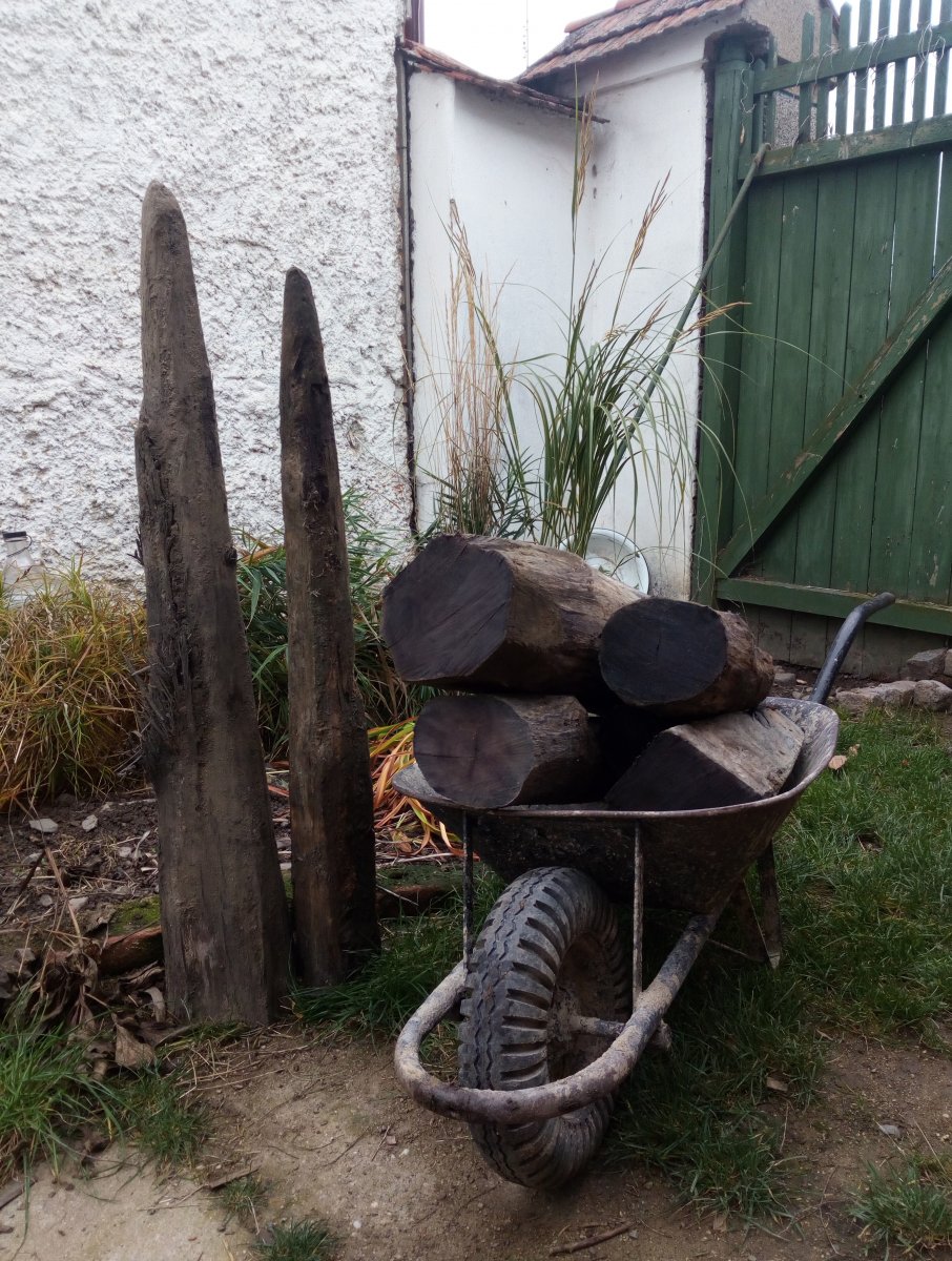

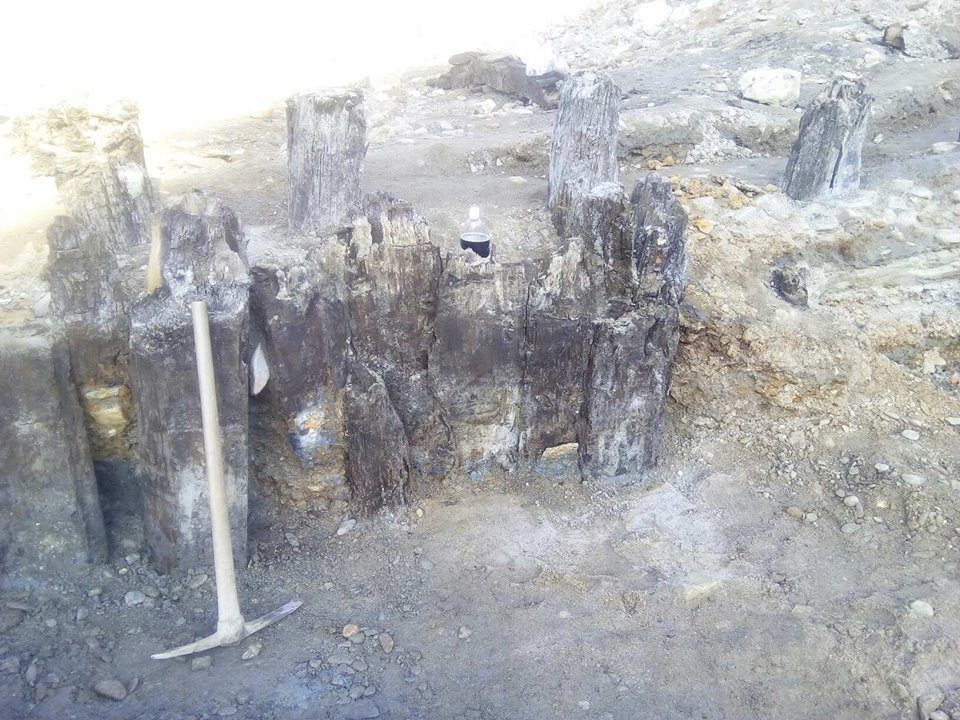

Last year, I managed to “re-cyclate” a pretty big pile of bog oak, that was originaly part of the medieval bridge . The wood comes from the channel of the Morava river and was discovered during the reconstruction of the bridge at Gorazd square in Olomouc city. The dating of the bridge is determined by silver coins around year 1300 AD . The wood is very hard and compact. The color vary from the brown/ very dark chocolade brown to the black ones :) Such a small treasure!
See you with more knives soon :) Petr
FARU

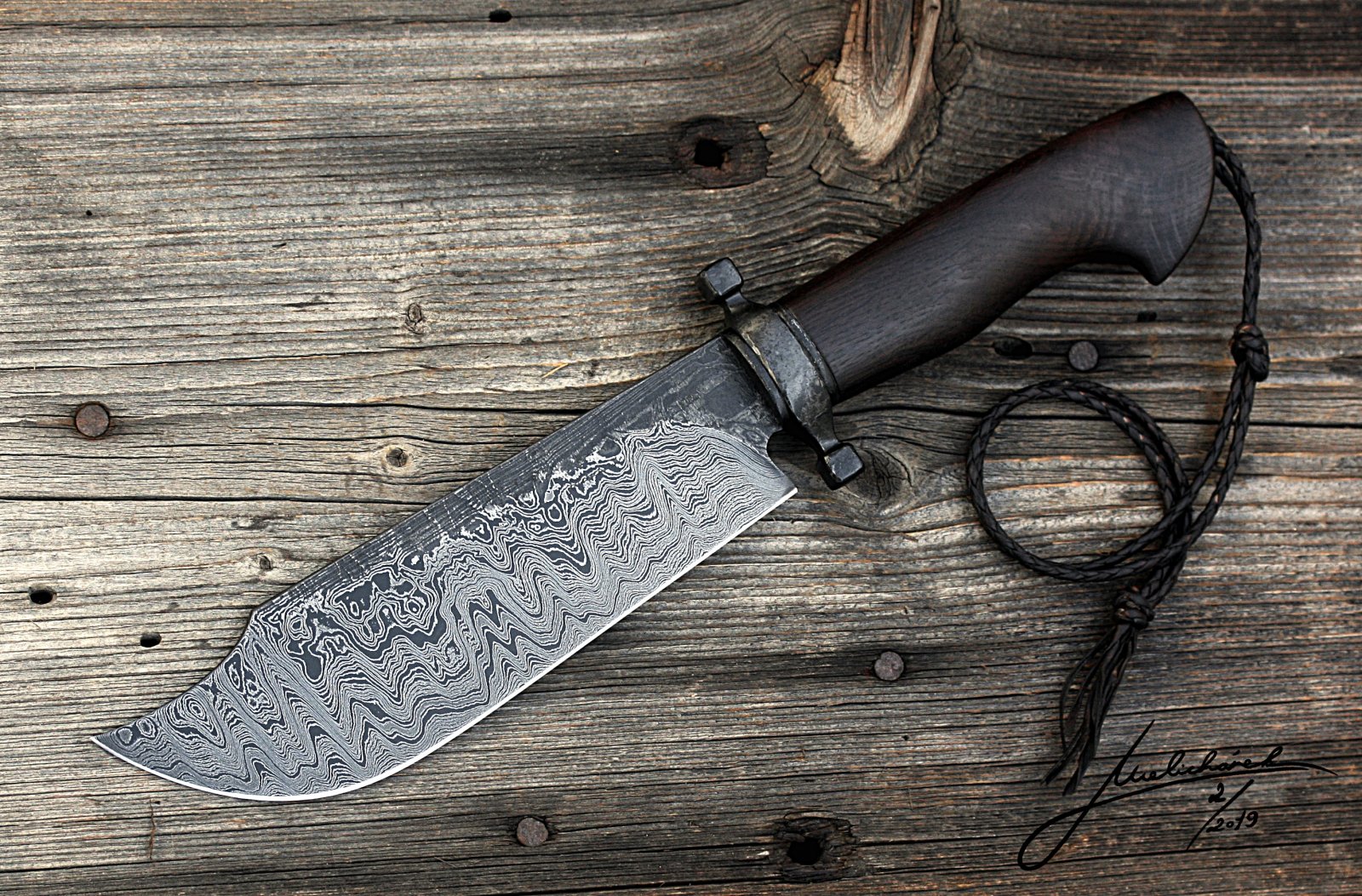

Blade - Damascus steel 1,2842 (O2) + 75ni8 Uddeholm (15N20)
Guard/pommel - patinated mild steel , central part of the guard is hardened steel 1.2767. It is something like L6 steel but bit stronger .
Handle - Ancient bog oak, originaly base of mediavel bridge , around year 1300 . You can find some more info and pictures on my FB or instagram :)
Average length - 33,5 cm (approx- 13,2 inches) , blade - 19 cm (approx- 7,5 inches).
Blade width at widest point 53 mm (approx 2,1 inches )mm , blade thickness max 5,5 mm (0,217 inches)

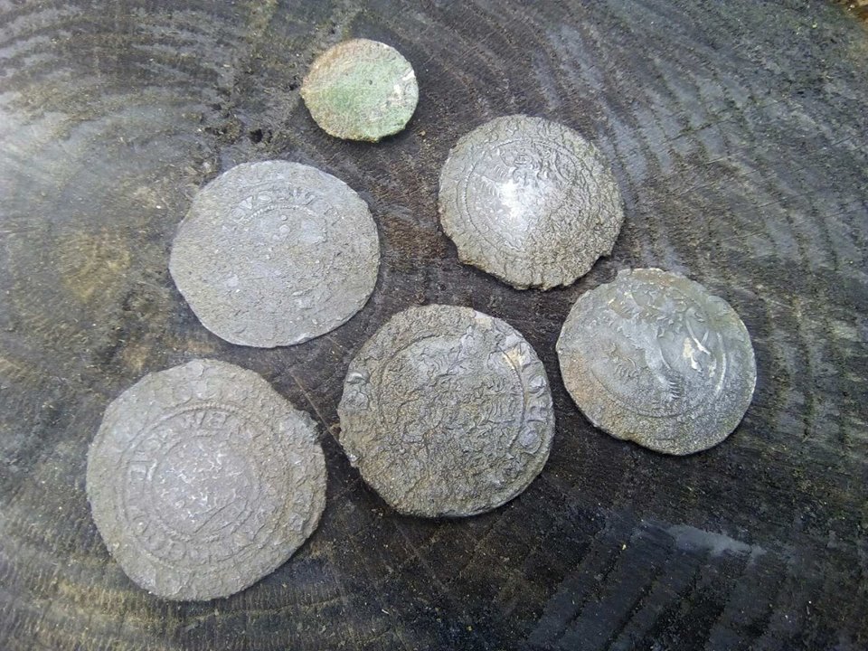

Thanks for showing the reclaimed wood photos also....
And the old coins what a treasure !!
Thanks a lot guys :)
Your work is Very Nicely Done !!

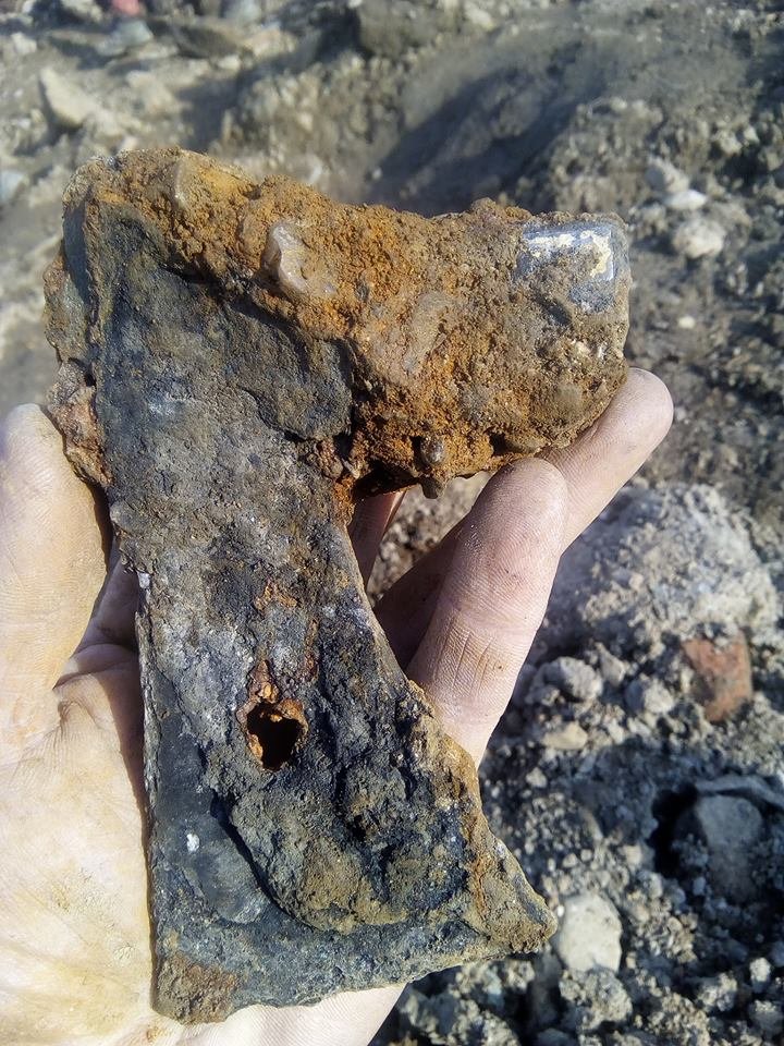

Thanks ! The coins are very cool but i didnt get them :) The Prague groschen coins and this battle axe with golden and silver inlays of course ended in muzeum! The specialists in restoration are now working on them :) I got just the wood :D :)
