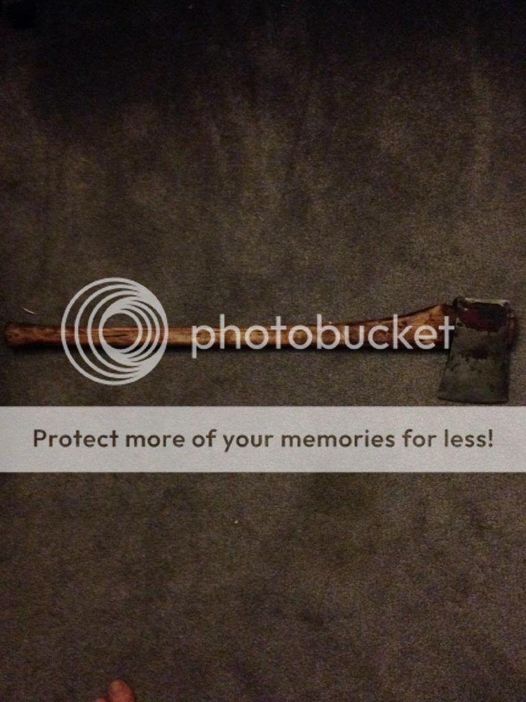

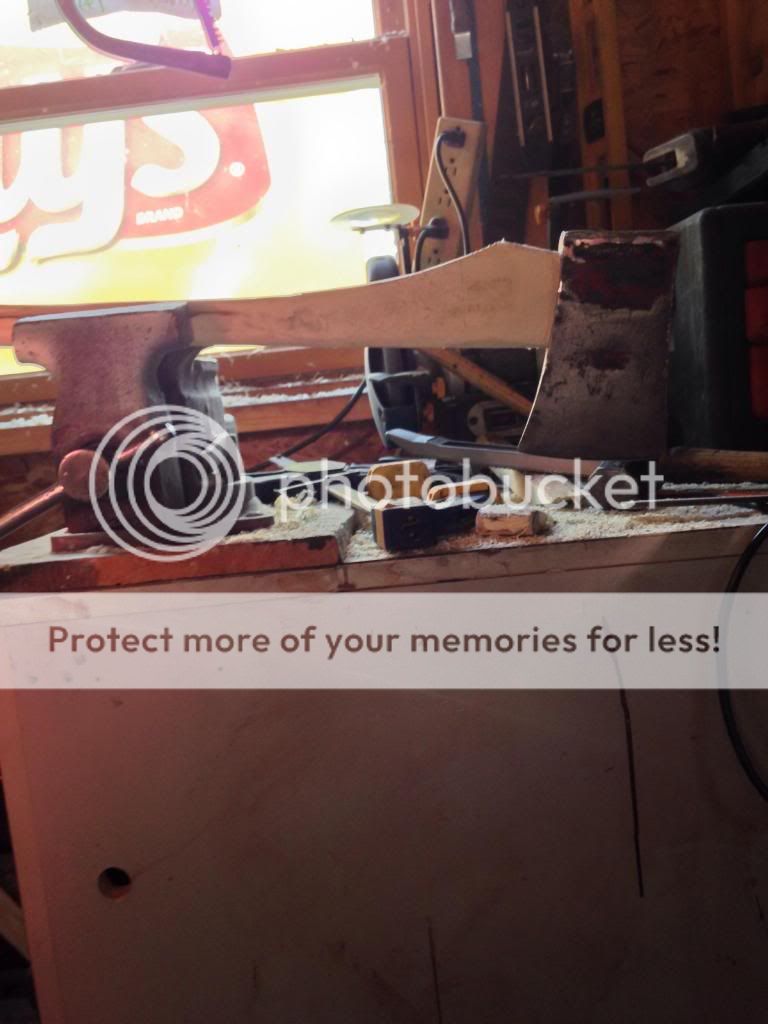

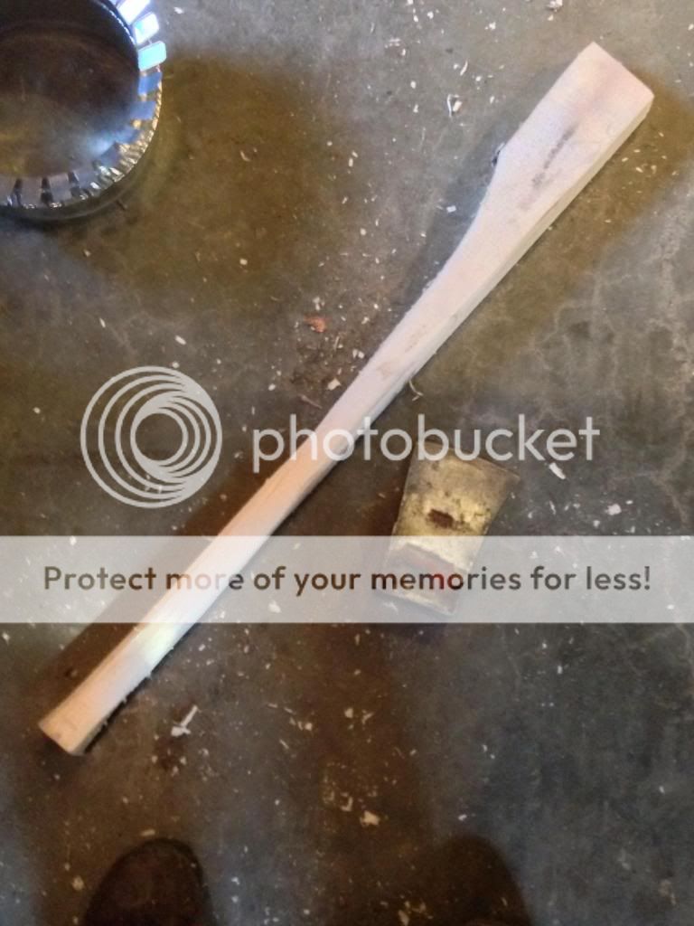

I'll keep this short for now. I started making my own haft for an ax without one (go figure Darth!). I started with a section of Maple I had cut down last year that had been seasoning for a while, and this is what I have thus far. Obviously not pretty, but it's on it's way there.
Not bad. And maple makes a good axe handle. While not as good as hickory it might still last for decades.
I like very a large swell or knob at the end of a handle. It's makes the grip easier and a relaxed grip let's me generate more snap with the wrist.
Personal preference.
WIP! Once you overcome the fear of whittling wood for practical purposes the rest is history. Have fun with this. What Square_Peg says is good advice; a swell at the end of the handle is generally a useful tactile feature that reminds you where your hands are and so that nothing slips when you're busting things with it.

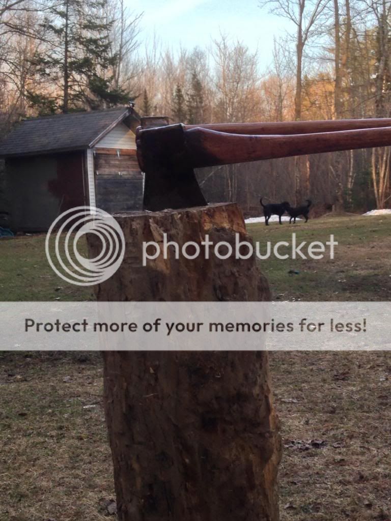

Almost done! It's been about eleven hours between yesterday and today and it's all coming together. Now I just need to stain the son of a gun, and stain the haft.

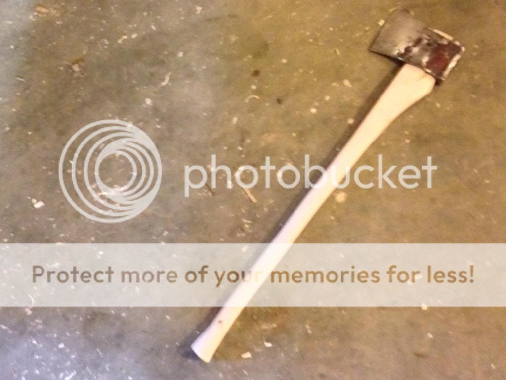

After 12 hours total, she's finally done!
Don't you love the satisfaction you feel when your axe head slips onto your hand made haft? I know I sure do.
I was happy that it didn't all come crashing down when I was cutting the slot for the wedge. Nothing was more satisfying than the first hit with a new handle.
