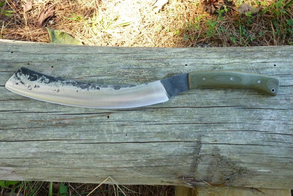

I've been making a few of this design lately.http://
It's about 20" overall with 12" or so of blade.The blade is about 2" wide and it's forged from .262 stock tapering to about 1/8" at the tip.It's a big heavy blade for larger hardwood chopping.For me the design seems to reduce felt shock and IMHO a curved blade is a more efficient chopper.It's just sort of my twist on a traditional Golok.
I like that one, very cool !:thumbup:

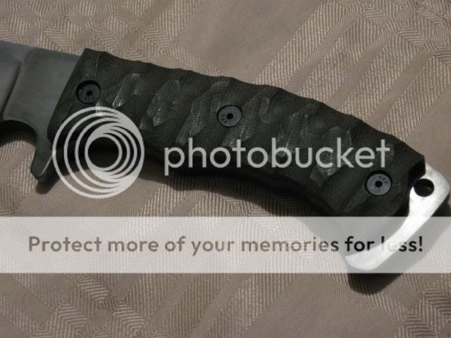

This is about as large as I'm prepared to carry, have not yet found the need for anything larger.
By pitdog2010 at 2010-09-02
Shown next to a TOPS Tracker:
I prefer something in the 8 to 10 inch blade length, 3/16" to 1/4" thick, 1 3/4" to 2" wide. Handle length, 5".
