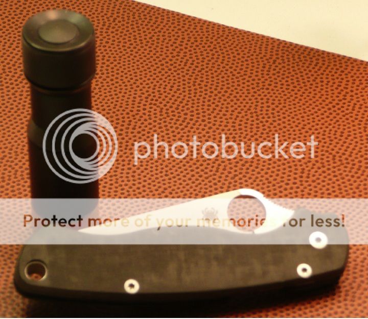

I do love me some Titanium. And have nothing against CF.
I thought I really liked wood on FB's and sought out G10 on folders, but each time I buy/make/change I seem to go Micarta.
So I guess that's my favorite for use.
It offers great grip, doesn't get slippery when wet, provides the benefits of both natural and synthetic materials without the drawbacks, is easy to shape or modify, looks good, offers texture without fatigue or pants-shredding, and doesn't cost an arm and a leg.
