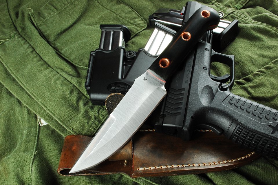

I like full flat, myself -
best
mqqn
But, the most gorgeous grinds I have from Kaydish are the ones that are on my two XD's - They are awesome looking and my favorite for aesthetics.
Just look at this beauty!
Now order one!
