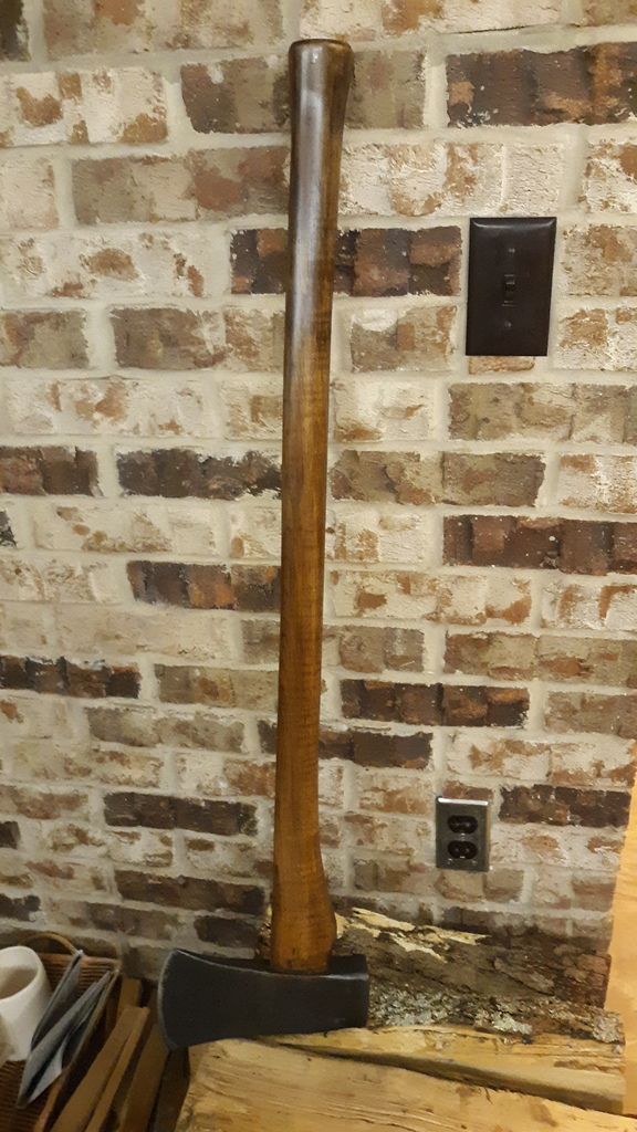

4lb ATCO W. Germany axe my little bother got. It's on the best darn 36 inch curved haft I've modded. The palm swell is huge and the haft is slim, just like it should be.
