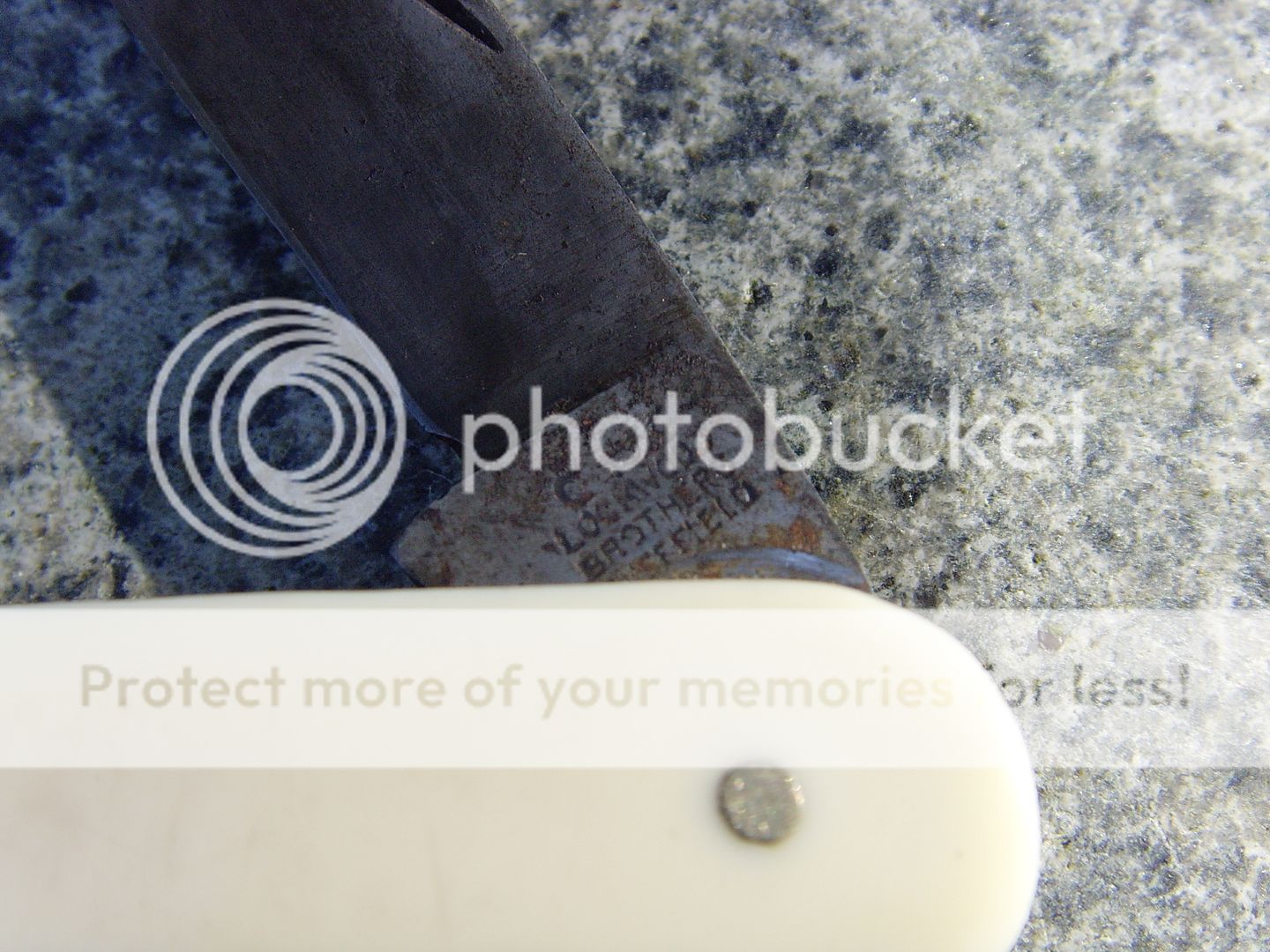

Thirdly, my grandfather used this for everything. Gardening, food, the lot. I was given it after he passed away. Long term EDC... No problems.
Don't fret about it, just use it :)
