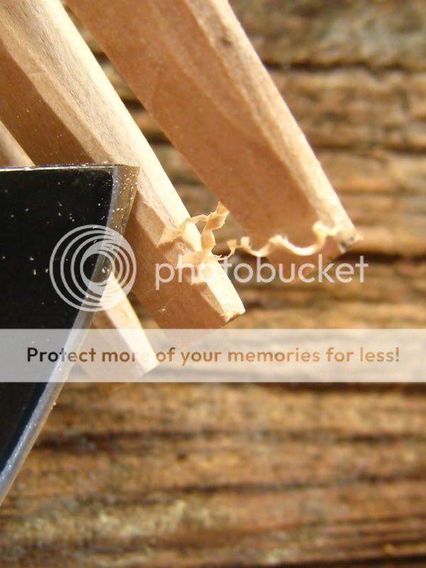

I did a semiformal test on feathersticking with the Ontario RD7, BK7, BK2, KaBar Bowie, and the Esee 3.
I used willow and another type of wood that I don't know the name of. I stripped the bark off two sticks for a couple of weeks and two sticks got stripped and tested immediately.
All knives were able to cut hair off my arms so sharpness was not a factor.
With each stick, each knife got a dozen or so swipes to shave feathers, so I got a feel on how each knife would do on the same pieces of wood. This cut out a variable on a bias of different knives on different pieces of wood.
The best performer was the BK7. With a combination of just-enough-weight plus a slick finish, the control was superb, and slicing was easy. I felt like I wasn't fighting with the knife for control. Second place went to the KaBar bowie, for similar reasons, weight of knife plus a slick finish, but the Bowie finish is not quite the same slickyness as the Beckers. Third-Esee. With the reduced weight, the thin sharp blade really did great. I just felt like you needed more muscle to push the lighter knife. Fourth-BK2. Despite the same finish as the BK7, the wider blade forced you to cant the angle of the knife to bite into a shallow part of the wood, and the weight of the knife doing finer work became a slight liability. Fifth, the Ontario RD7. I had great hopes for this one with it being heavy like the BK2 and having a FFG. However, the finish on the Ontarios seemed to drag and create traction that was detrimental to fine feathersticking work.
Ok keep in mind that I love all of these knives and they all shine in a particular arena, and many overlap into other areas that make them all outstanding. I have no plans to get rid of any of these knives and am glad I have them. Just as there are some who feel that the measure of any knife is its ability to baton thru a big log, there is other tests that examine a knife's usefulness and I tried to illustrate that with the featherstick test.
If any of you have similar testing done, post it. Hey, and no making fun of my lame feathersticks!
