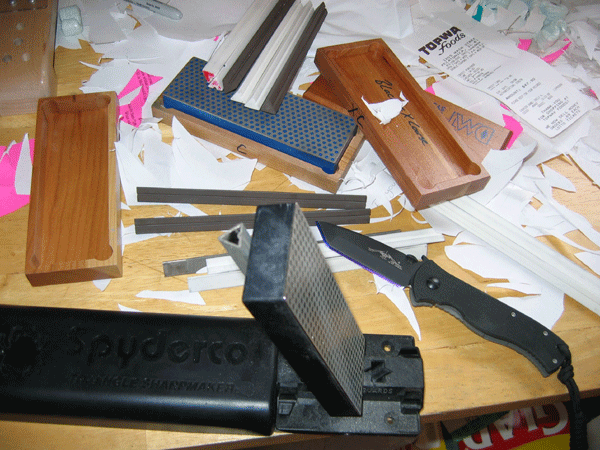

For those that recommended using a coarse DMT stone and the Sharpmaker, how do you estimate and control the bevel on the DMT stone?

The Edge Pro doesn't clamp the blade, it just has a platform for it to rest on. When using a coarse DMT angle isn't important, as you are just shaping with it. If you do want angle control with the DMT just lay the stone against the Sharpmaker rods in the appropriate slots. That's how I applied my microbevel to my Jess Horn last night and it worked like a charm with my DMT and Spyderco benchstones.

You cheat like this:

Just as Oilman showed. I have some wooden wedges cut at my favorite angles that I can touch the blade on, to see how well I am holding the angle while freehanding. On the coarse stone, it is not necessary to hold a precise angle anyways. Even if you are using the Sharpmaker, Cliff's advice is very advisable :D.
oil
That's exactly how I cheated. You can leave both rods in at the same time to speed it up as long as you don't let the sharpening surface of your DMT hit the Sharpmaker stone when you are switching sides. With the Spyderco benchstones you simply flip it back and forth between both of the rods, without having to flip the benchstone around like you do with the DMT. It is fast and prevents one side from loading up too quick by honing each side of the blade with opposite sides of the benchstone.
