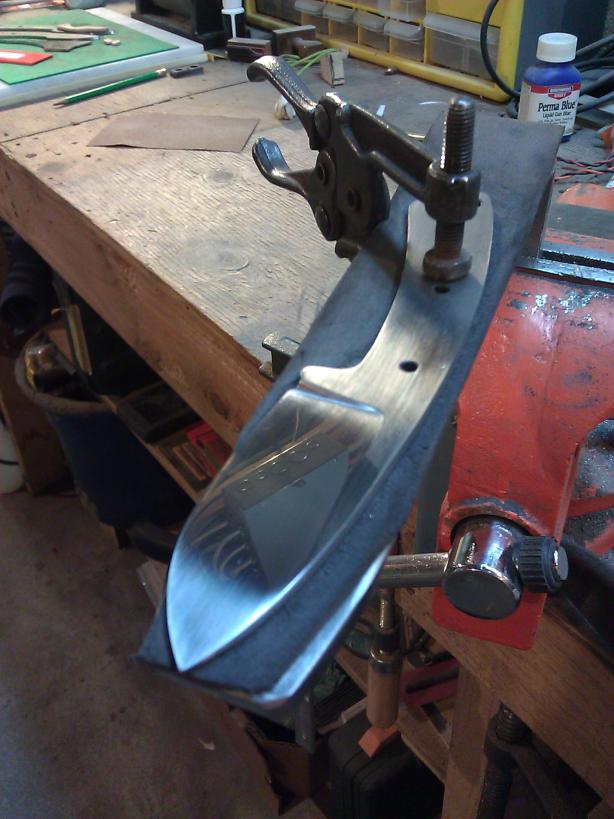

Thanks! Bad news? I've been using my hand, not a block. Spoon-like? Not to my eye, but who knows. :eek: Good news? Like six hours in and I've only just switched up to 600 (I should note, looking at other threads it looks like good polishes were achieved starting at 400, but now I wish I'd started lower -- so much pitting it took me forever). Anyway, I don't have any g10 so I'll grab some maple or plexiglass tomorrow. The edge is pretty much shot right now but whatever, if I can't fix it when I'm done I'll send it to Richard. Hope not using a block didn't screw me, but either way, it's getting somewhere. I'll do your 45 - 45 - hilt-tip method starting now.

For encouragement:
This knife was sanded to 360 before heat-treat, so there are no pitting or deep usage scratch problems.
It's small, and only about 2.5-2.6" of blade will be exposed - only polish the exposed areas (blade, spine, ricasso).
Then it was heat-treated.
I cleaned the scale off with 280grit and then sanded 280, 360, 500, 1000. This took about 45min-1hr.
That's a 1000grit one-directional surface in the picture. Pattern on the bevel is from the plunge to the tip.
Immediately after taking the picture I put blue tape on that side, trimmed to fit, and put it away. I'll finish the other half tomorrow or the next day.
Check out the reflection of the ceiling in the blade flat.
My point is that although you project has much more area to cover, with the right protocol you can move reasonably quickly.
Switching directions on a regular basis and with a regular pattern means you're taking the peaks off the surface scratches by sanding across them instead of just dropping your grit into the troughs along the direction of travel. MUCH more effective!
-Daizee
