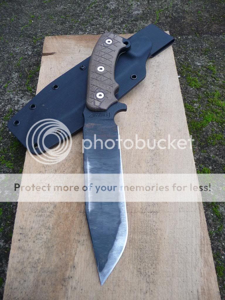

From my experience 3V rusts if not properly cared for. I used to have a satin finished peace maker that I used for everything including food preparation. I had to unscrew the handle slabs from time to time to clean the steel under them from some superficial rust. Nothing really bad but quite annoying. Larger fehrmans have rubber between steel and hanlde slabs. It prevents water from getting under the slabs, so it should be better. You are considering a larger blade - if it is for use, I'd choose a coated blade. The coating on the blade will wear off the blade from use, but it'll stay intact on the handle and protect it. Here's my first strike - excellent blade! I'm really amazed how much 3V from Fehrman can handle!
