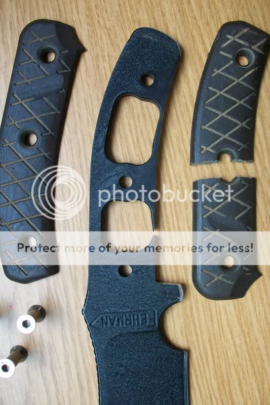

I was always thinking that Fehrman knives, at least Last Chance, First Strike, etc., were a full tang knives. As a matter of fact, they are. However, they have, at least one of them, a strongly skeletonized tang.

1. Have the First Strike and Last Chance the skeleton tangs too? the same holes?
2.How the skeleton tang reflects on the sturdiness of survival knives in question? Could one hang on the knife (imagine a survival situation on rocks) without a fear the knife would break?
I am sure Eric would give us answers that support my confidence in Fehrman tools although I must say I am astonished with a fact that the Extreme Judgment has a skeleton tang. Whatever the answer were - with a really full tang a knife should be stronger.

Obviously with any piece of steel, the more metal you remove the more strength you remove, but I wouldn't be concerned with breaking a Fehrman knife unless, like the picture you posted, I modified the tang to what appears to be the thickness of pencil lead.
Franco
The Fehrman LC, FS and FJ have an identical skeleton handle, I have used these models for several years and I never encountered problem .

In my experience makers only skeletonise the tang to improve balance and also to remove weight. There is a thread over on the Busse subforum about the new design of the light Argonne assault. Jerry discusses why he has dramatically altered the tang.
This is the tang on my Peace Maker
The tang is just right. It provides extremely balanced feel for this size of the knife. It is as strong as you may need and it is a 3v.
It is me who is interested to get answers to some questions I quoted. I believe there is a reason why Eric makes these holes - I doubt it is because of weight.
Actually, It's almost entirely because of weight, or more importantly where the weight is. A large part of making a good knife is the weight distribution which effects the balance and the feel for the knife. Until very recently in knifemaking history full tang as we think of it hardly existed. Swords and knives were generally Rat-Tail peened through the pommel. This normally leaves a lot of the weight forward and by the time you add your handles creates a nicely balanced blade.
I would say that more blades than you imagine are skeletonized. if not skeletonized, then Tapered tangs. The only time I ever leave weight in a handle by leaving it solid is if the blade size or weight is large enough that I need the weight in the handle, which saves me adding a bolster, or pommel weight to a chopper etc.
As to strength.. If you over-skeletonize then certainly you can get a failure, as was shown by this example of grinding it down. In-General though, drilling holes, or taking out a centre chunk wont weaken the integrity of the knife in any way that will matter. How thin I'd leave the side walls would also be dependant on those side walls thickness. Steel is a lot stronger/Tougher than many think. Its kind of like an I-Beam in construction. Certainly an I-beam is not as strong as a solid bar, but its a lot lighter, and its Stiffness does not change because thats based on thickness. so a skeletonized tang wont bend laterally any easier than a solid tang. it is more suceptible to Twisting stresses.. but by the time a handle is secured and bolstering the tang its almost moot. Also, most stresses on a knife are not in the handle, unless your technique is wrong.
While a Tapered tang can look good, I'll take a skeletonized one every time. This is because the forces on any normal knife will not be great enough to stress the blade in the normal direction of use, but a tapered tang in prying is far more flexible than a solid skeleton tang which imposes higher stresses on the Glue, and the handle scales..
