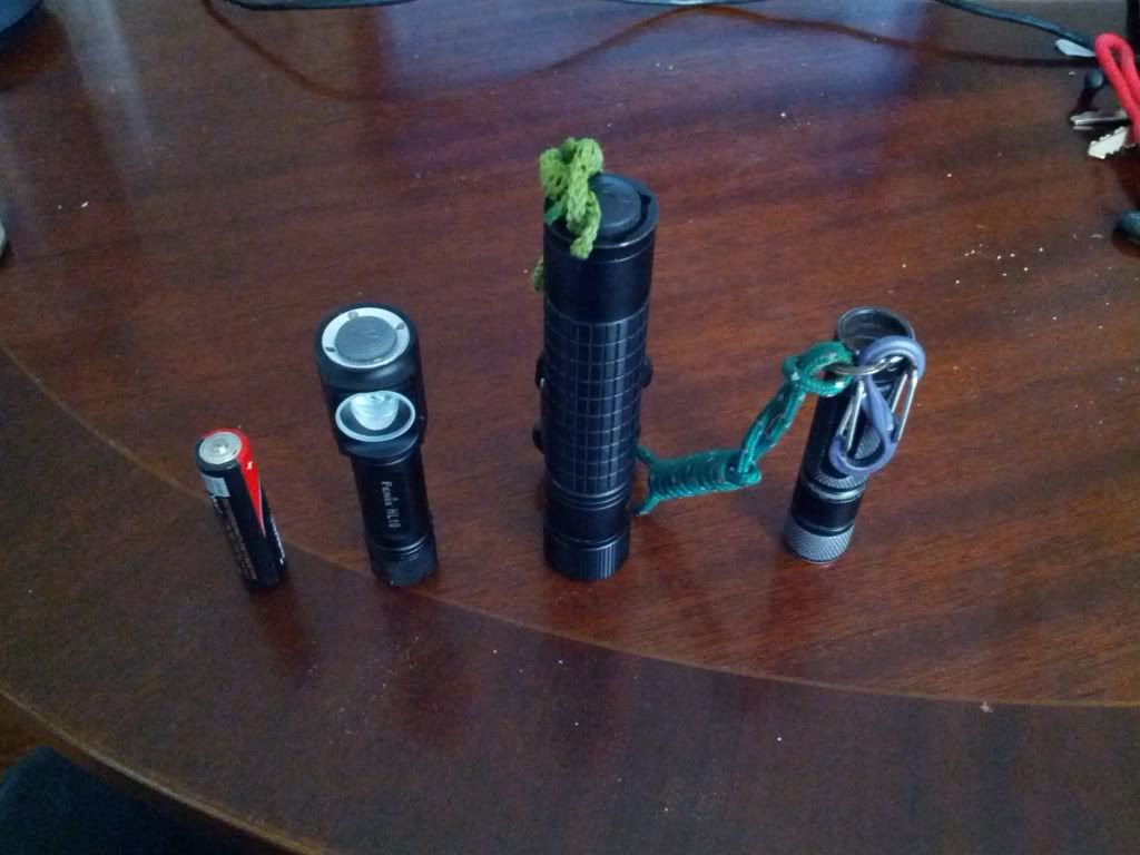

So I've had the Fenix HL10 for a few days, and I've got some thoughts on it. first off, a size comparison
So in comparison to a AAA battery, an E11, and E05.
So from a pocket perspective its just a 90 degree E05. The added material in the head, and the larger circuit do add a touch of weight, but in the hand, its hardly noticeable. The base has a small hole for a lanyard ring, but its pretty tiny, and would probably interfere in the headlamp holder. It also lacks the notch that allows the E05 to stand with a ring, so I'm not sure how it would be best used. As a handheld flashlight, it takes a bit to get used to, but it certainly works. Holding it in my teeth just doesn't work at all, (but thats what the holder is for....

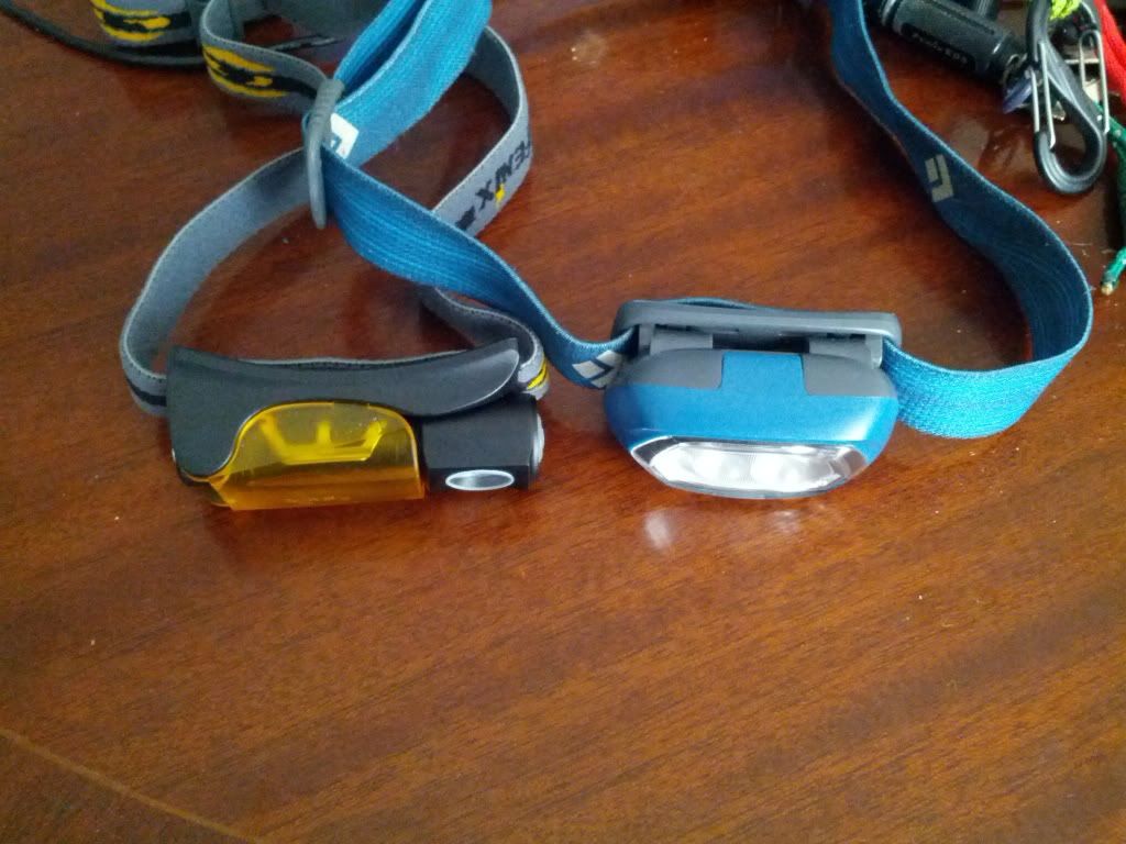

For comparison, I'm benchmarking against the Black Diamond Gizmo. It's the closest light I have, and a common enough one to make sense.
side by side

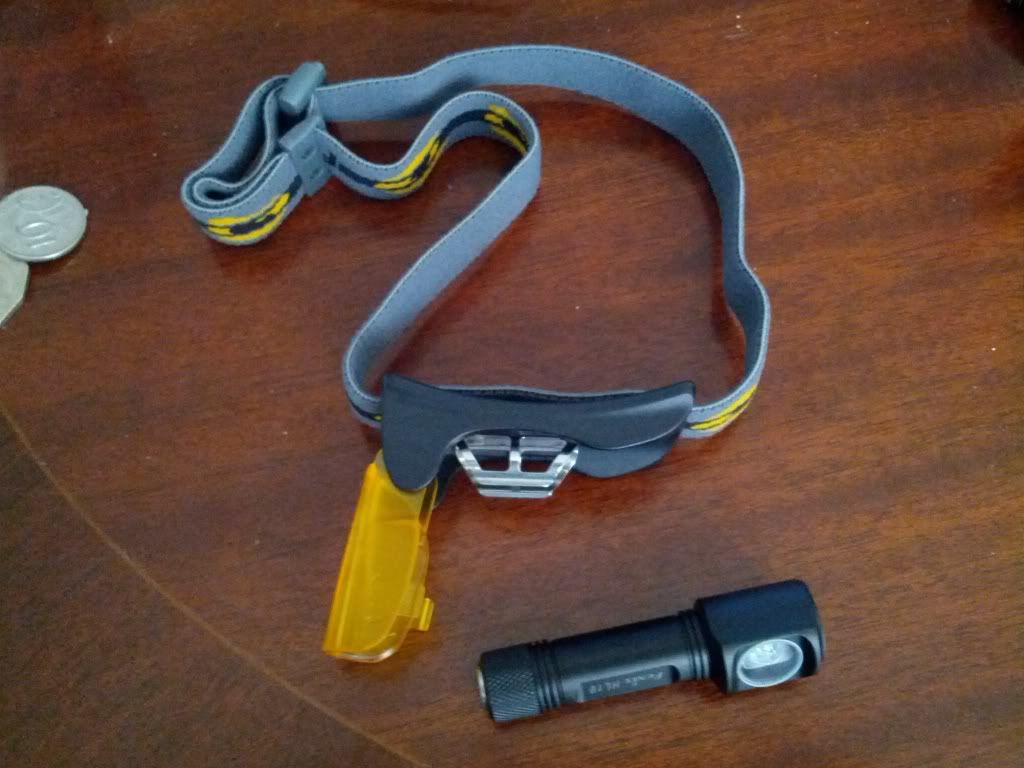

So they are pretty even in size in headlamp mode. This is one of the things I don't much like about the Fenix. the Gizmo is a 2xAAA light, and it only slightly larger than the Fenix. (58g compared to 45g for the fenix) Now, the major part of the trade off here is the fenix's aluminum body and consequently its waterproof rating(IPX8 vs IPX4 for the Gizmo) I find the orange cover a bit gimmicky and fiddly, it doesn't hold the light at all, and if the steel clip somehow fails, the rest of the holder probably went with it, so its not a backup at all.
The steel clip gives very good up-down adjustment, meaning that the light can be worn either way, and quickly brought into line. The strap is simple, and comfortable enough, and the curve of the holder is wide enough to fit most heads I think. The clip will scratch the light over time, but as a fast and secure way to hold the light, I think its a fair trade off. Beam-wise they are apples to oranges. The Gizmo is a wide flood that just keeps going. It gets right into the peripheral vision with the edges, which is good for a general use light. The hard edge of the HL10 means it is better for focused work. But thats about as close as you can compare a singe cell singe emitter light to a dual-dual light.
