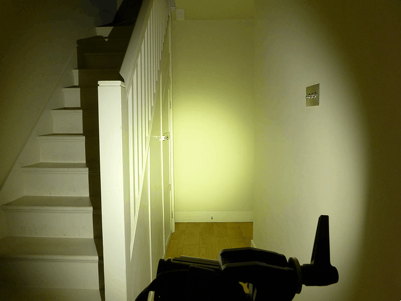

The beam
The HL55's beam is combination of flood and throw, and doesn't overdo either. There is a hotspot, but it is not so pronounced as to make the beam uncomfortable at close range, but gives it a bit more punch when looking further afield.
