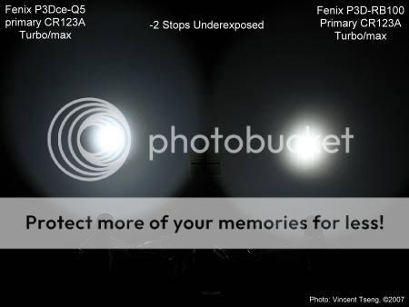

White wall comparison -
the Q5 seems brighter in comparison - but the Rebel 100 has a smoother beam and nicer tint - also the overall coverage by the Rebel 100 is wider/larger - so it's spreading its light more.

Wow, thanks for the shots. I have the 200 lumen Rebel, the one on the right, and was lamenting not getting the 7 percent brighter cree. Now I know the rebel is smoother in the middle, and I'm not sorry now.
