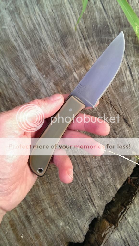

FeCl can discolor anything that is lighter colored. Especially those vulcanized spacer materials. I switched to G10 BTW... So no, I wouldnt suggest dipping the whole blade. I have used a q-tip to etch the tang on a full tang knife before, just use care...
It does apply a rougher surface which can help to hold more of s protecant coating on the blade, but it alone will not add corrosion resistance. I have had decent luck etching 1095, cold bluing the steel, hitting it with 0000 steel wool, bluing again and then putting on a liberal coating of oil. Then when wiped down it seems to give it a pretty durable finish. It can be touched up easily, but I find the bluing on the etched blade is very close to the natural patina coloration so it doesn't really matter. I like a worn in blade, and this combo gives what I consider to be a good treatment for an easy to maintain carbon steel finish that will only look better as it goes.
This blade has the above listed treatment. Very light etch, just accentuating the quench line, etc. I see the new owner fairly often, and he honestly carries it every day, uses it a lot, and it Is wearing nicely. I etched the blade separately from the scales. I get to final finish or at least very near prior to glue up.

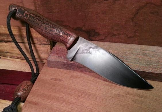

This is what I do.
Make sure the knife is CLEAN.
I dip the entire knife into ferric chloride, I use G10 and epoxy for my handles and the acid doesn't hurt it. I use a pvc tube with a cap on the end and constantly move the knife in the acid, maybe 15 seconds or so. I have a large container with hot water and baking soda to nuetralize the acid. I then rub the blade with 0000 steel wool and wash it again. You can dip it again if needed - this is what it looks like when I'm done -

Wow that came out beautiful! That's exactly the look I'm trying to achieve when it comes to the blade. Thank you for the advice I appreciate it very much.
