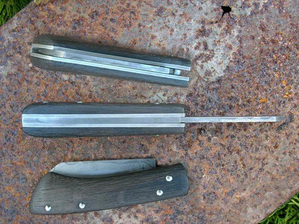

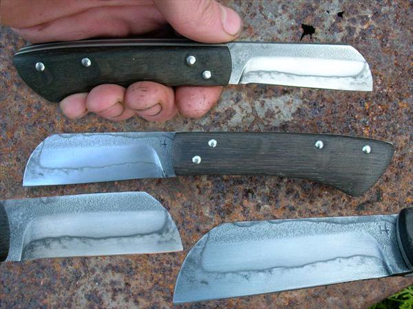

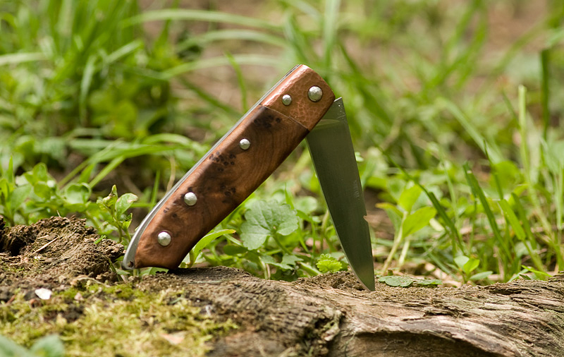

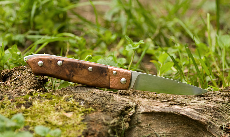

This one is Parcial 19 191 (sorry don't know Your number equivalent) with muddy oak.

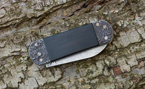

Tiny 440C with Thuya and Cuprum :

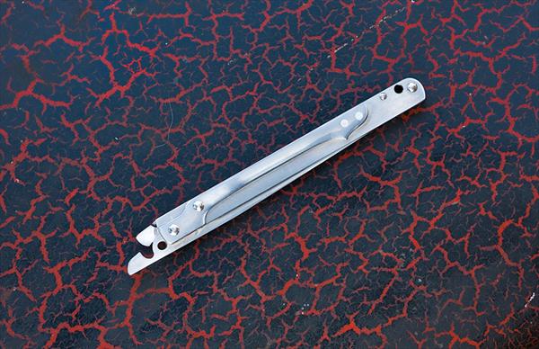

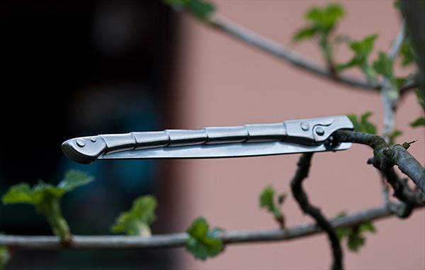

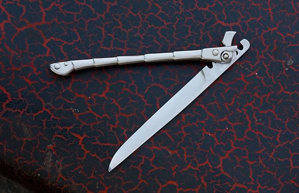

Prototype Ameba knife
Don't know if it is new in wordl of knives. But it is my idea and I call it Friction lock support.I try something new based on classic friction lock which was typical for region where I live for hundred years ago
The friction lock support is locking blade in close position too. When You pull leaver up, the outer spring with rivet go to the side and You could close/open the blade, very simple, but a lot of laws and step by step You must hold to make it without free motions.

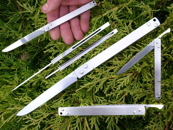

The serie of steel gents is made full of AK9 (17 042) quenched on 58HRC, scales tempered on blue colour.
little video: http://www.youtube.com/watch?v=B9d5ihl8PEw

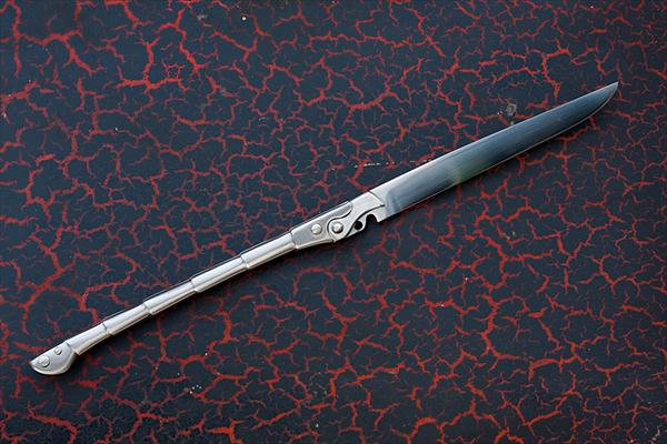

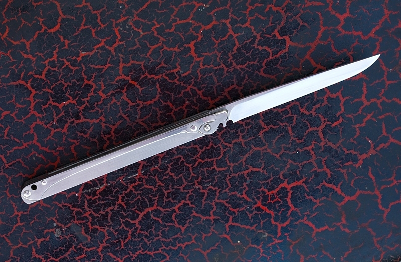

Dragonfly... full AK9 again
Simple friction folder - AK9 58HRC
Wenge friction lock support N695 / 59HRC

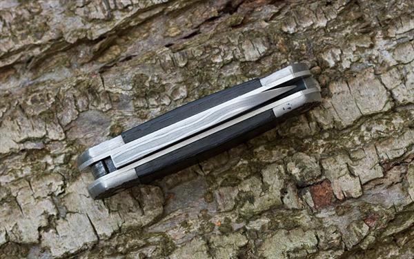

and my own Muddy slipjoint
Few layers sandwich 1.2767 and 1.2842, muddy oak more than 1000yrs old and
bolsters are made of old hinge from one near castle build more than 300yrs ago. The rust on it is authentic made by rain for hundred years. Photographed used after few months carry everyday .
All comments welcome.
