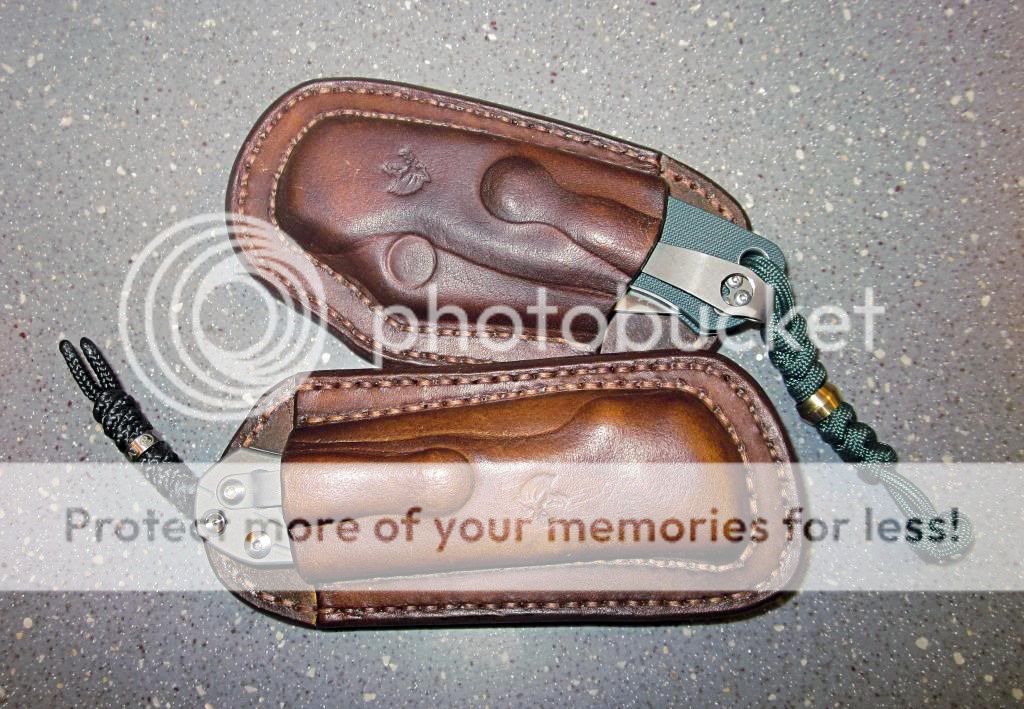

Hello.
Once upon a time showed nothing which does not mean that nothing is done.
I throw only photos.
As if there were any questions I will gladly answer.

Marek, those 2 sheaths look like left hand PM2 and Umnumzaan. Beautiful:D

Wow, very nice work. I always really liked the look of leather sheaths.
Please excuse my ignorance, but how did you get the sheaths to form around the pocket clips like that? Is there a way to mold the leather to the knife like kydex?
Thanks.
Thanks for kind words.
I would like it to be like with Kydex.
But it is not hard just more laboriously .
It's just like sculpting in wet leather by a tool for molding .
We used of course knive for form .
First, a rough form, and dried.
Later, more precisely, dry.
At the end of finishing up almost on dry leather.
That's all.
One comes with a better, second worse.
But everyone can try.
