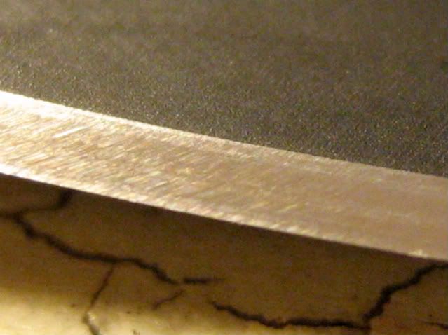

Holding the angle when sharpening free hand is the most important part but you must also remember that you will end up with mulitple micro angles creating a micro convex edge. No matter how hard you try it will always be this way unless you are using something like a edge-pro or like sharpining device. Raising the burr and making sure you keep flipping it from side to side while sharpening is good on coarser stones but when you move to the finner stones I find it better to use one stroke per side. Doing it this way (for me) seems to create a better/sharper finished edge.
Here is a pic of a knife I was sharpening with a DMT UF 1200grit stone. when looking at the edge with the naked eye it looks perfectly stright but under magnification you can see all of the other angles.
