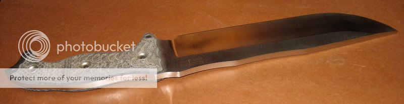

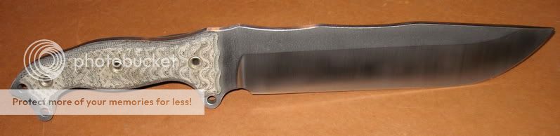

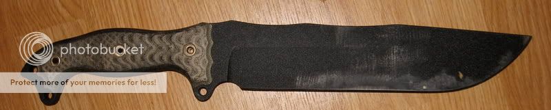

Well I decided to strip my FFBM. I just like satin the best. I still have some detail work to do but, come on, she's a user. :cool:
Before:
After: (chemical stripper & some scotch-brite)
Now it's time to see if the smoother surface of the blade makes a performance difference. :D

I liked the feel of the handle before. But after sanding the spine, and the edge of the micarta slabs, it feels even better.

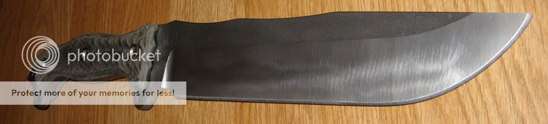

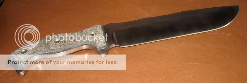

Here are a few more pics. I used one of those scotch-brite drill attachments. Works great.
And the best part is that the Busse logo remains this time. You can see it a little in pic 3. :D
so you did not use any stripping solution? only scotch bright drill attachment? or did you use stripping solution then run cleanup with the scotch bright attachment?
Either way, I think it looks great. I love stripped, I even love the dimples.
Thanks man. I started by applying a chemical stripper called Strypeeze. Ijust coated the entire knife. Let it sit for about 10 min and then scrapped the coating off. I applied a 2nd coat just to get a few stray sections here and there. Then I went to work with the scotch-brite. I have found that combo to be perfect for me. :thumbup:
