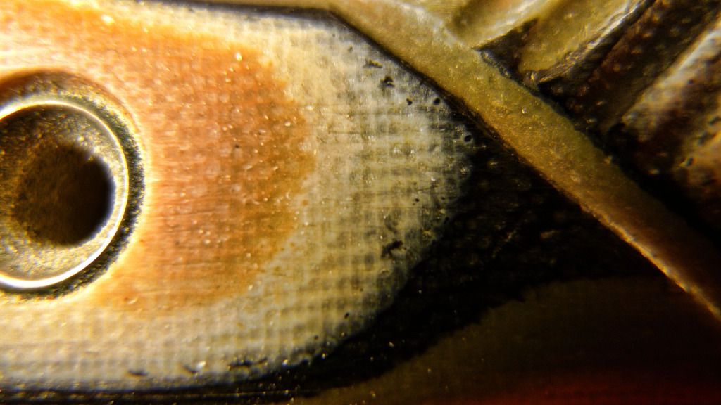

The fiberglass used in g10 is more like fiber-optic cables. They are much thicker, and laid in layers of square mesh (like wire fencing). When the handle surface is exposed - most of what your actually touching is epoxy, the bonding agent that keeps the 'fibers' from pulling away form the material. If it's exposed to abrasion you might get a bit of the glass to come away as a powder, but it's going to be a small percentage of the dust and it's going to be that, dust, as you would get if you sanded a larger piece of glass or ceramic. Because the wires of glass used in the mesh are thicker they don't break away like the fine hairs of the other fiberglass products.
This is the fiberglass your probably thinking of:
This is the fiberglass used in g10 (a BOSS jack with sandstorm g10 scales)
