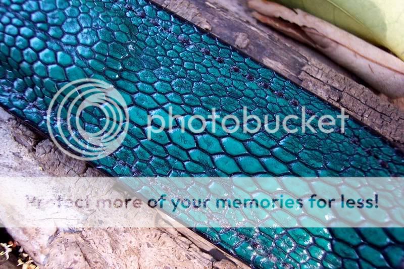

The shades you can get from the dye run the gambit from very light to a nice dark emerald. Add an antique over that and you get some great effects. Some of these are antiqued and some not. :) I had to grab some water based dye, I'll report on that after I get some swatches done. :D

UPDATE on the water based dye. So far so good, its a different technique all together to get this stuff to go even. I'll post my findings soon, hopefully to help out those who want to explore this avenue.
After an all night sit to let it dry, so far the green water based dye is looking good. :) I have a picture to download soon.
Seems the key to this stuff is to be consistent and level with your applications. Each one should be heavy, flooding the leather very well and evenly. Use an overlapping swirl, moving quickly and evenly. The liquid will try to puddle, its important that you continue to go over the area till its even.
One session is all it took, with the spirit dye I had to go over it in several sessions after each application was good and dry to get it dark enough. And after all that I had one very dry piece of leather.
I've got some testing to do on the swatches, I want to know how far this stuff penetrates and how resistant it is to abrasion.
More to come! So far I'm not disappointed. :D
Here's what it looks like so far, before the final finish, and possible antique highlighter.
The photo is a little off, it actually looks darker in person, I didn't notice till I posted it. I'll try to get a better pic.....
EDIT: I edited in the more true to life picture. :D
Those are some cool color effects, I've heard great thing from those dyes, living in So. Cal they don't sell oil dyes or spirit dyes. I've had to use water based. But I like the colors you get from them, took some time getting use to.
