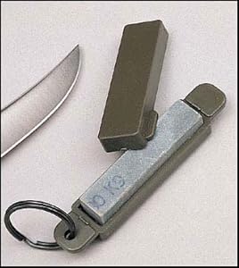

I like the G. I. sharpening stone. It's very portable and very cheap, and unlike most other hones that size you can get a good grip on it and use it safely. I actually use diamond hones most of the time, but there's plenty of other gear the boys could invest that money in.
