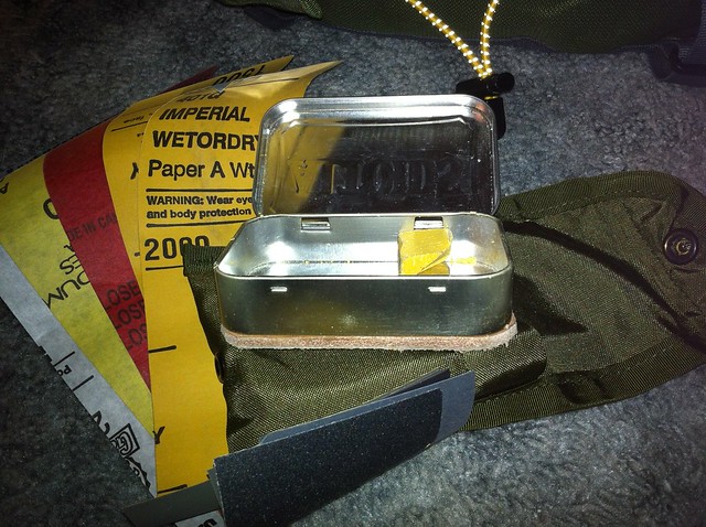

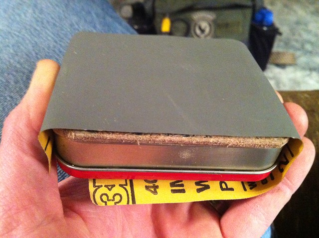

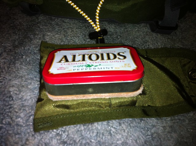

Thought I would post a small field sharpening kit that I have put together. Iz Turley posted a video a couple years back how to put one of these together. I just copied him, have used it a couple of days and it works very well. It consists of an Altoids can, a chunk of leather epoxied to the bottom, small chunk of leather stropping compound, and a small stack of sand paper. I have 220, 400, 600, 1000, 1500, and 2000 grit paper. To use just hold the paper tight across the leather and apply about the same amount of pressure you would use like you would sharpening a convex blade with sand paper and a mouse pad. Or just use the leather with stropping compound on.

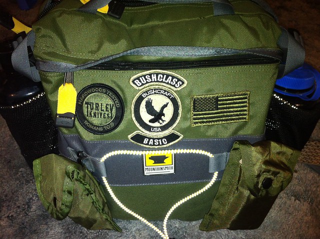

In the first picture my sharpening kit is in the compass pouch to the right on my bag.

Kit weighs 2.6 ounces not counting the surplus compass pouch. I just weighed it on my electronic scales. There are lighter and heavier sharpening systems out there for sure.

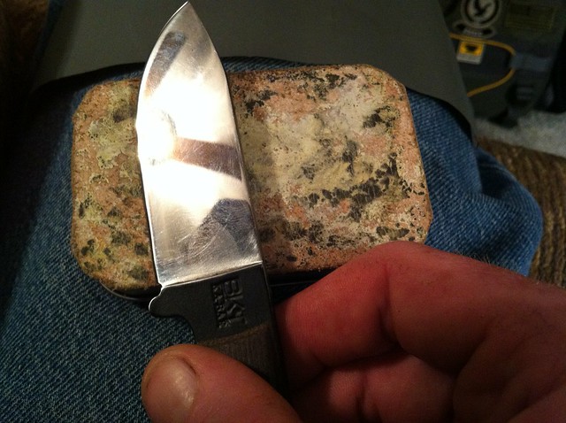

This kit is geared towards sharpening a convex edge and maintaining the edge. As far as using it to sharpen a BK9 from dull to razor sharp, it would take a while (but possible, just not practical). While being a knifeaholic, I normally don't let my blades get real dull. I did use this kit on a friends spyderco Aus8 folder that was fairly dull and brought it back to almost scary sharp. It will make it scary sharp, i just ran out of time, on it i started with 600 grit and worked to 1500 grit. The sand paper system is a proven system this is just a small field kit which does have its limitations.
