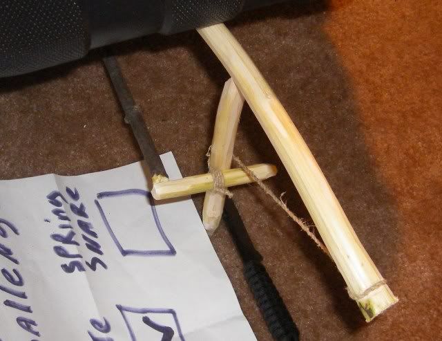

Before I post about the fig-4 I want to update on a thread I did earlier. I showed how to make cordage from yucca leaves in this thread.
http://www.bladeforums.com/forums/showthread.php?t=808663
I said I would use the cordage for the Paiute trap in the Jan challenge. I got some more leaves and kept at it. Now I have over 8 feet of cordage. I don't know the strength but it can hold up a 20lb free weight. I'm gonna keep making more until I have enough to use this cordage for both the Paiute and for the L7 snare.
On to the Fig4:
I have decided to only use the Eskabar for this challenge. I wear it as a neck knife and no matter what happens to my gear I will have my Esky.

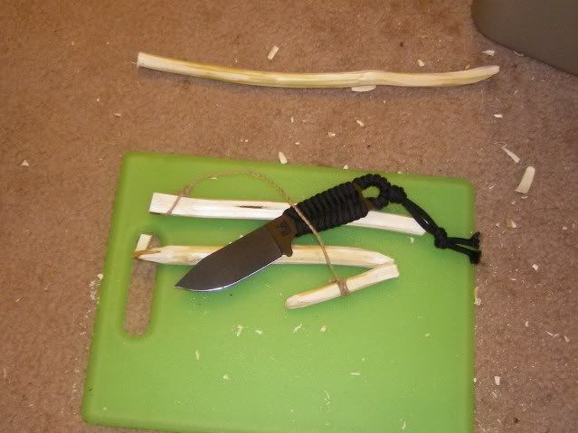

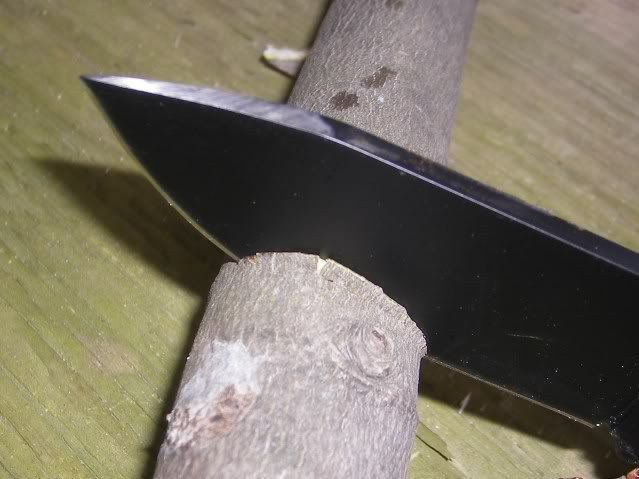

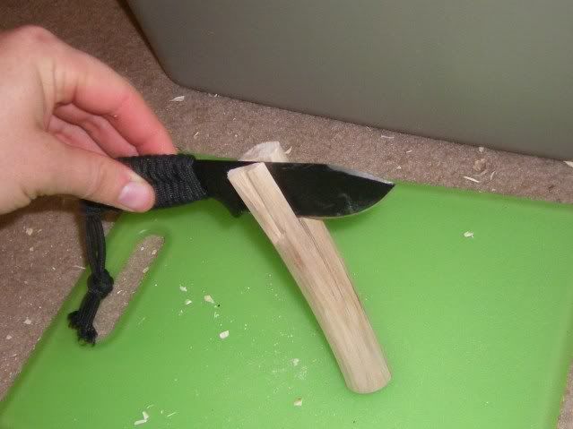

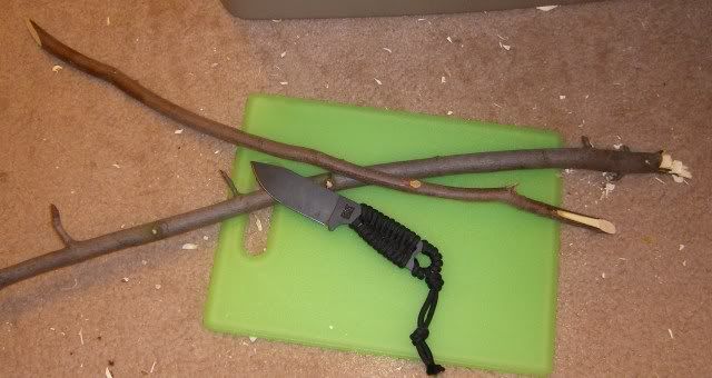

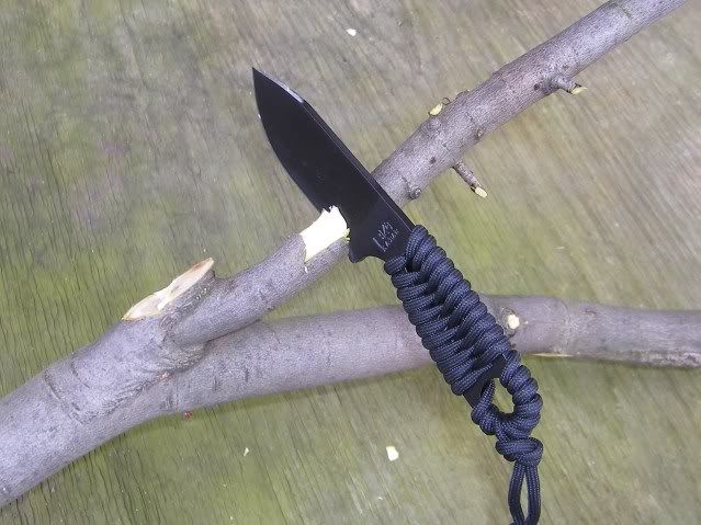

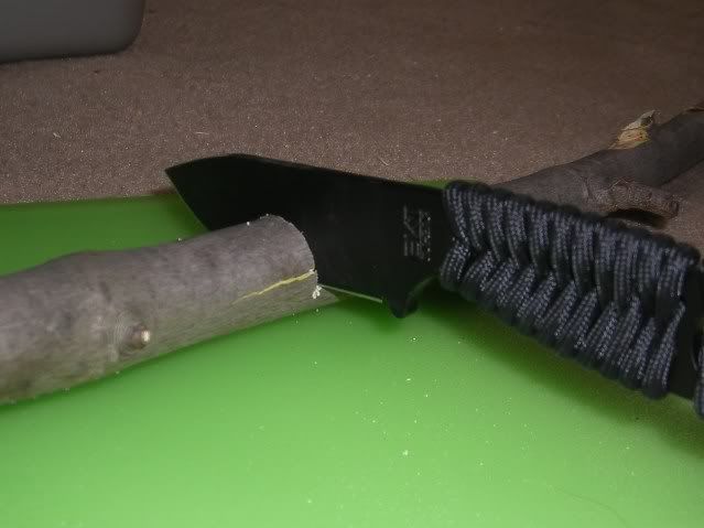

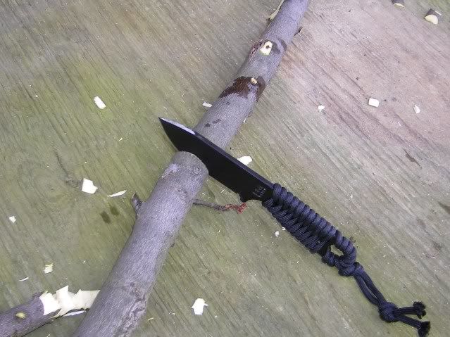

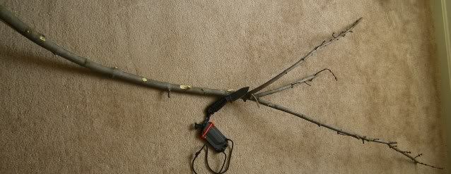

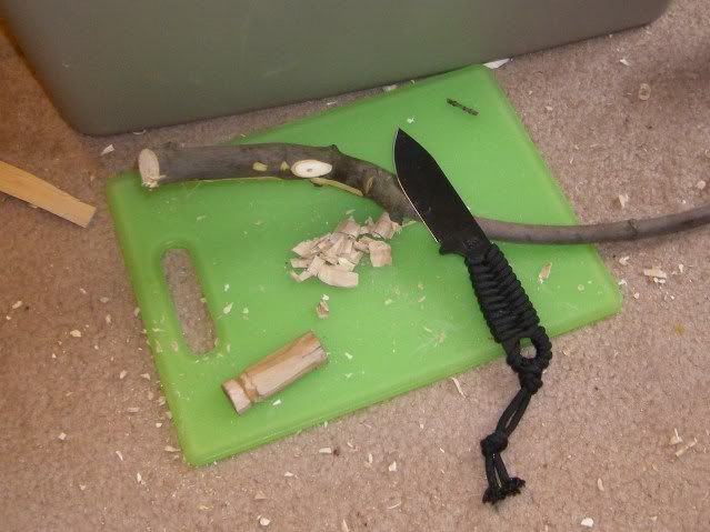

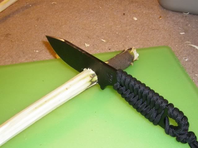

I will use a different wood for each trap. I choose sugar maple for the fig4 because it was available behind my house. I battoned the branch apart and then in several places to length. Esky handled battoning just fine.

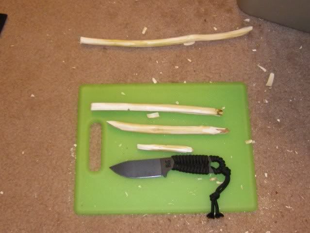

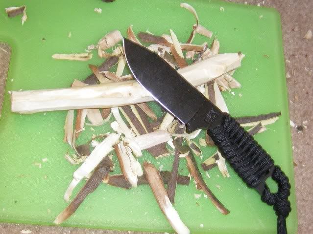

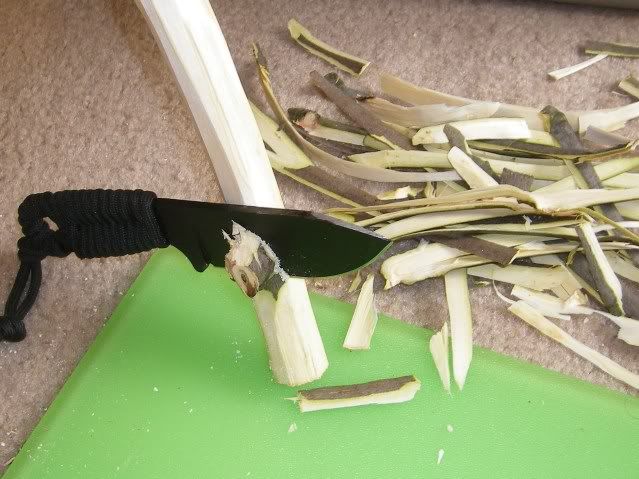

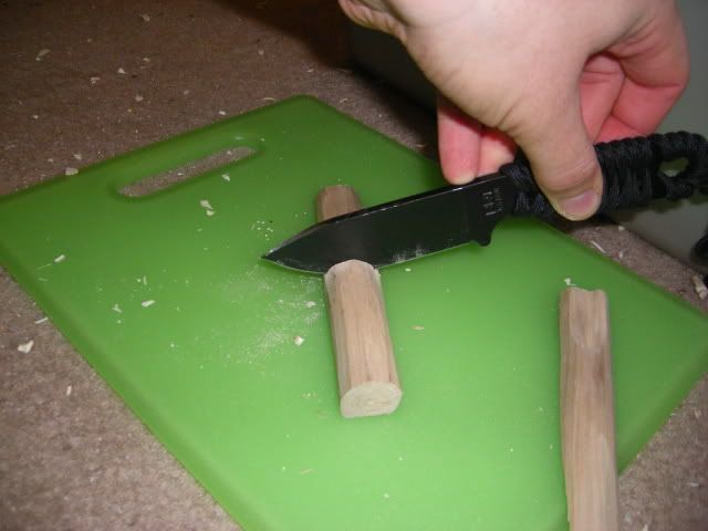

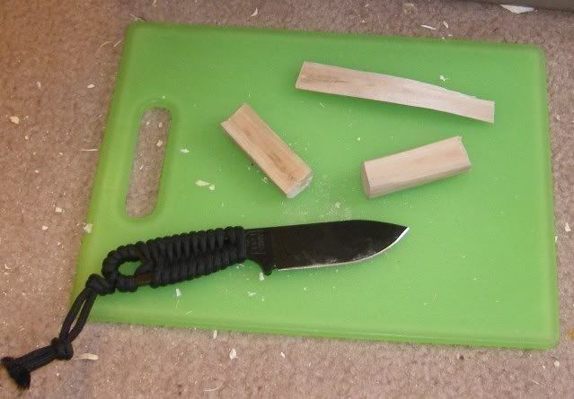

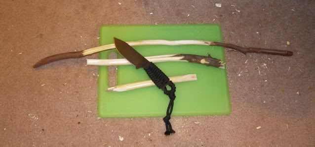

Then I brought it inside to get started. I batoned out the sections that I needed and started stripping the bark off the trap parts. I also had a couple knots to baton off.

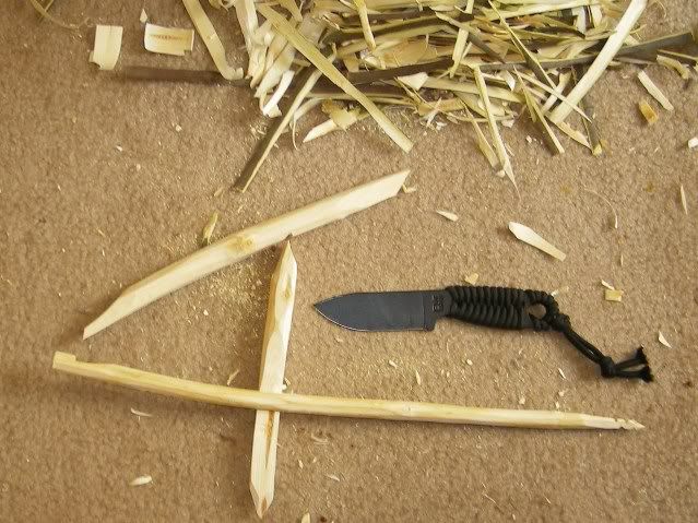

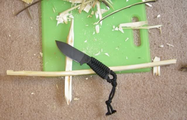

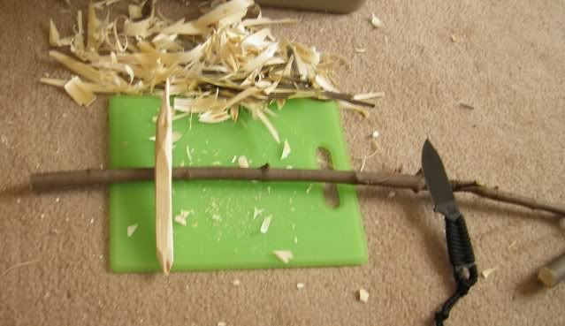

With the upright finished I laid the bait stick across to determine the length I would cut it off.

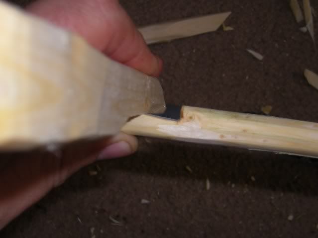

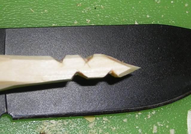

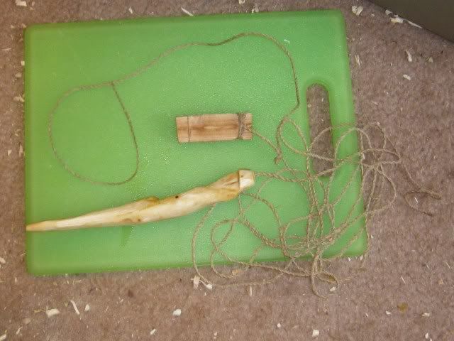

I like to make serrations in the end if the bait stick when I am using a meat product for bait. As the meat dries it hardens (think jerky) and the serrations grip the bait. Squirrels will always go after meat products! I the spring, birds eggs are by far the best bait, but they require a different trigger. The second pic shows the notch on the bait stick that catches on the upright.

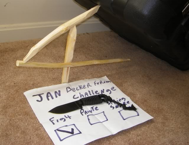

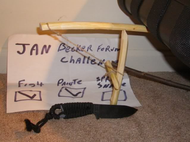

Slap on the angled stick and this one is finished.

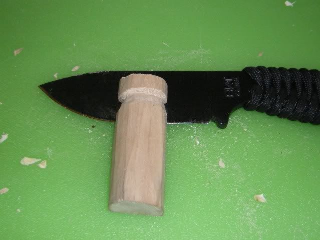

TRAP #2 Paiute Deadfall
Raw materials

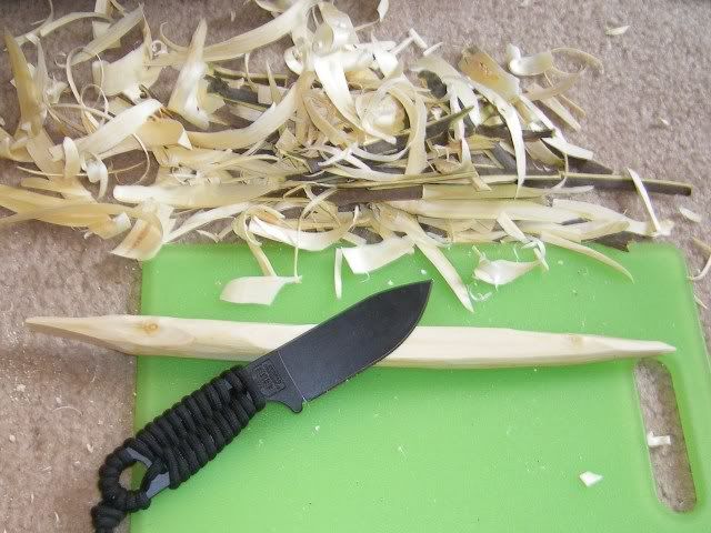

Strip bark from necessary parts. Batton lengths for trap parts.
Make the Cordage.

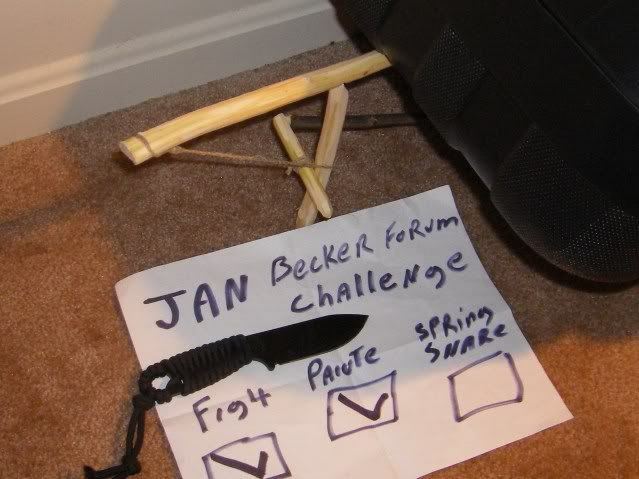

Attach cordage to trap
Set and tune trap
For those not familiar with this trap, here is a top view of how the trigger is set.

TRAP 3- L7 SNARE

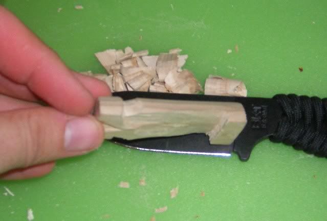

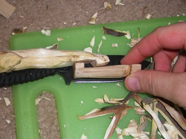

Baton wood to length then split to get a flat spot.
Next, shape the top (trigger) section with a hook on one end and a groove for the cordage on the other.
Pick a good strong branch for the anchor and baton the length you need, strip the bark, and cut the notch that will mate up with the hook end of the trigger.
BIG STEP I made ten feet of yucca leaf fiber cordage. I don't even want to think about how many splices it has! The first pic shows how I made a sliding loop in the natural cordage to act as the snare.
