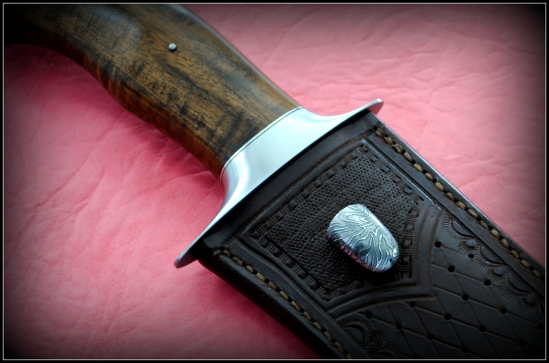

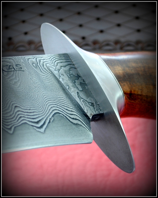

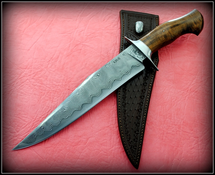

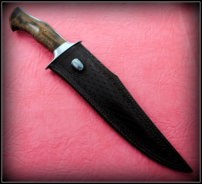

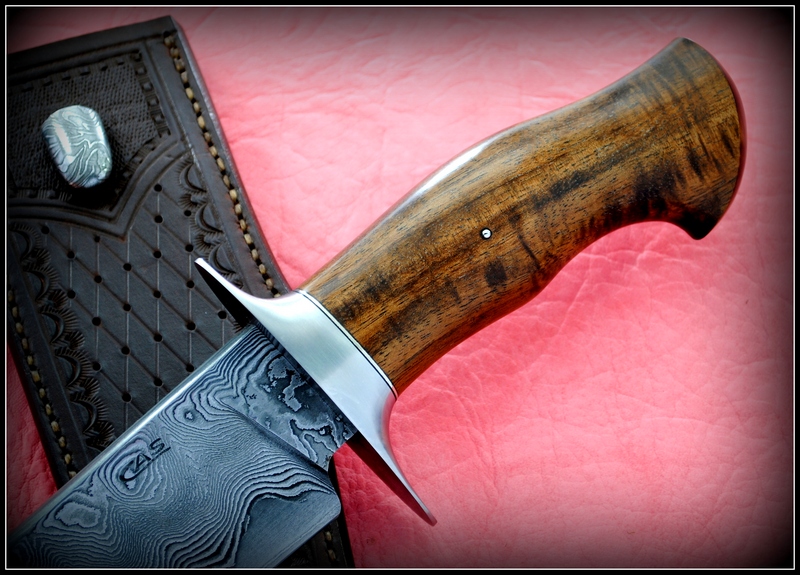

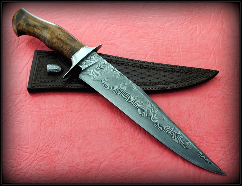

Hi guys,
I wanted to share with you another fighter done in damascus and san mai. On this occasion with 11 "Blade and stabilized Koa handle.
Steel: 1070 and 1010 on the sides, on the edge 1095
Handle: Stabilized Hawaiian Koa
Measurements: 11" Blade / 16.2 Overall
Guard double: Aisi 420
Best Regards,
Claudio
