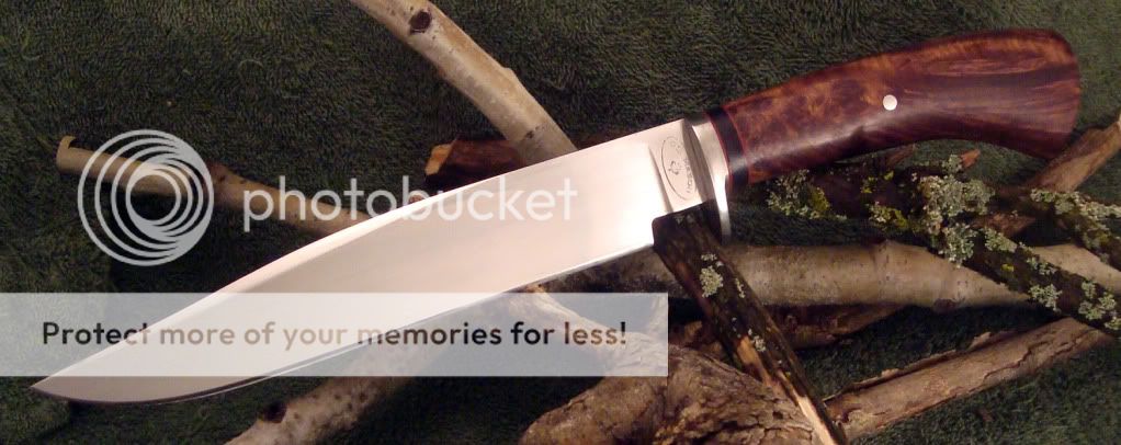

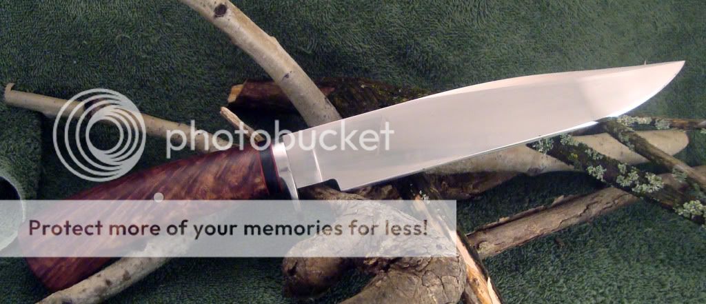

This fighter just showed up in the mail today.
It was made for me by George Mason who goes by Unky Gumbi here on the forums.
I really like it!
Sorry about the bad photos.
I think George has some better ones he took before he put the knife in the mail.
A few details;
Overall 13&3/4", blade 8&1/4"
Steel CPM D2
Wrought Iron Guard
Stabilized Redwood handle
Nice Mark and compliments to you George, well executed.

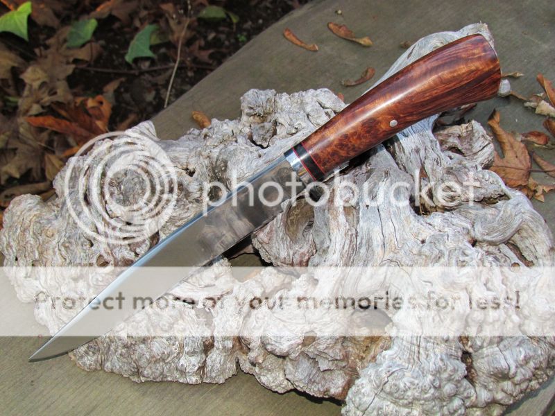

I think Mark's pictures do it justice, but I will add mine too.
I know I have a lot of things to work on before I will be truly happy with my work, but this is my best to date. I give credit for that to all the good advise I have gotten from the makers in Shop Talk.

One thing I try and avoid is a too sudden/sharp transition from the dropped edge to the ricasso. 90° turns can be a stress point for cracks in HT and breakage in use. That is not a real concern on a well made D2 fighter like yours, though. I like to round the turn from one surface to the other. It also makes grinding and sanding easier.
I know what you are talking about with the transition from ricasso to edge, and if you look back at every other knife I have made they have all been as you describe, but had a real short ricasso for some reason. Maybe I need to make the next one a combination of the two. I am still looking for my own individual style and I know it will all fall into place some time. Little hints like this and others I have gotten all help to shorten that time up.:thumbup:
