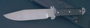

This has sort of a Strider influence, no claim to anything close to what they are making. This is just one I enjoyed making.
Enjoy!
Fighter in O1 Tool steel.
Blade is edge quenched 1/4" O1 tool steel.
Flat grind, Handrubbed Satin finish
Blade is 6 3/4" OAL is 11 7/8"
Handle is Linen Micarta With NS pins
Heavy duty Multi position Kydex sheath can be worn upside downor with a Teklok clip.

Nice Robert, I can see the Strider influence in the handle. Gotta love that 01 tool steel. That will be one tough knife!
Keep up the good work:)
Your execution of the design looks superb. The grinds and fit all appear to be top notch - a sure sign of quality. I like the blade too, but frankly, I have to be just a bit critical of the handle. It seems to lack contour.
As I mentioned - execution of the design really does look excellent, but it's the design itself that, in my humble and unqualified opinion, could benefit from just a little tweaking, if you will. Now, I can imagine why the Strider guys make their production knives like this - it's probably much easier and faster to profile and fit straight lines than curves, allowing for more efficient production of high quality and effective cutting tools - but if you're going to take the time to build a nice, sole-authored, handmade custom, why not also take the time to profile a more comfortable and better fitting handle?
Again, please don't take me too seriously here. I really do like the knife. I guess I was just hoping to see another one of your excellent fighter-bowies and thought I might convey how I'd like this one better with only some slight modifications to the design...

By the way I agree the handle is kinda plain but it is meant to be versatile.
