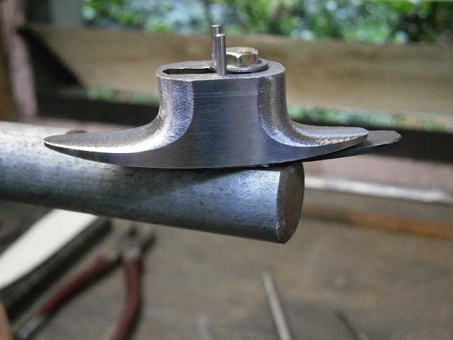

Here’s my latest; a fighter in 5160 and Desert Ironwood. Blade is 8 3/8” long, 1 5/8” wide, and ¼” thick at the ricasso. Overall length is 13 3/8”. The guard is etched and cold blued mild steel, and the spacer and pin are both stainless.
The balance point it right at the plunge.
You’ll notice that there’s a small pit left over from forging, hardly 'brut de forge', but worth mentioning.
Thanks for looking.

For those who find this stuff interesting; here are some in-progress shots:
Forged blade welded onto a handle for normalising and thermal cycling.
Heating up.
Cooling down.
Tang and ricasso softened a bit after hardening.
Clip bevels almost done.
Filing the guard to shape.
filing a groove in the guard.
Almost finished guard.
