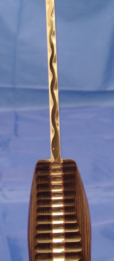

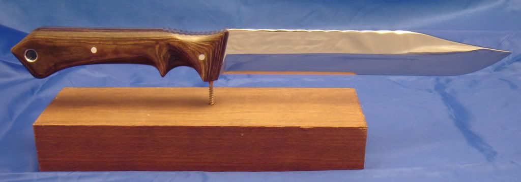

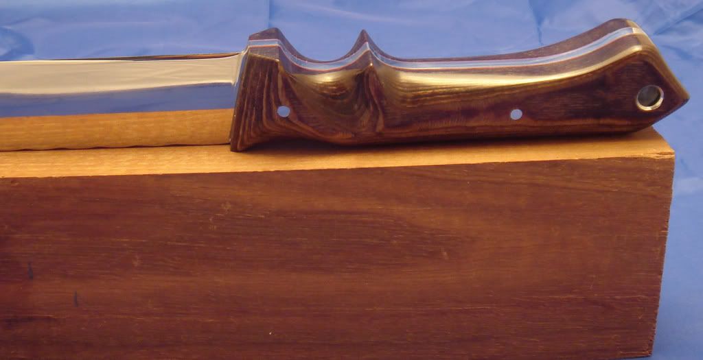

Made from a old car leaf spring.
3/16" thick
8 1/4" blade
14 1/4" overall
Convex grind (hand filed)
Jabrock scales
Aluminium pins and tube.
I don`t have access to a heat treating oven so this one has been edge quenched in oil using a oxy torch.
A lot of first`s for me on this one .
First try at file work.
First Fighter.
First use of a tube .
+ - Comments welcome
I am calling this one the snake Fighter because of the file work.
Thank you for looking
Richard

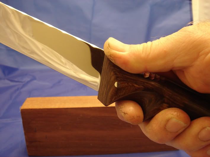

Damn, you have calloused hands.
Hard working hands :) Its winter here plus when you are doing a lot of grinding your hands are in and out of water quite a lot.
I am quite suprised that no one made a comment on the point of balance for this knife.
I took the picture with the knife resting on a screw head to see if anyone would notice.:confused:
