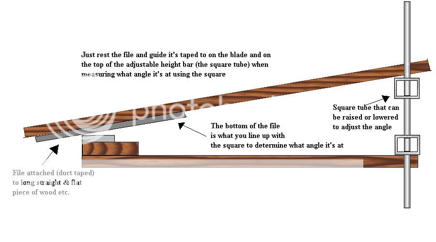

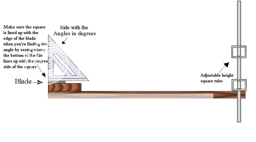

All I did when I used to use my file jig, (pretty much like that one) was in order to account for the angle change once the steel was all filed off to reach the edge, I just layed the file on something (sitting next to the clamped blade) like a piece of scap steel for instance, that was half the thickness of the steel that my blade was, and set the angle according to that. Say my blade thickness was 1/4" , I used a piece of 1/8" steel to set the angle.

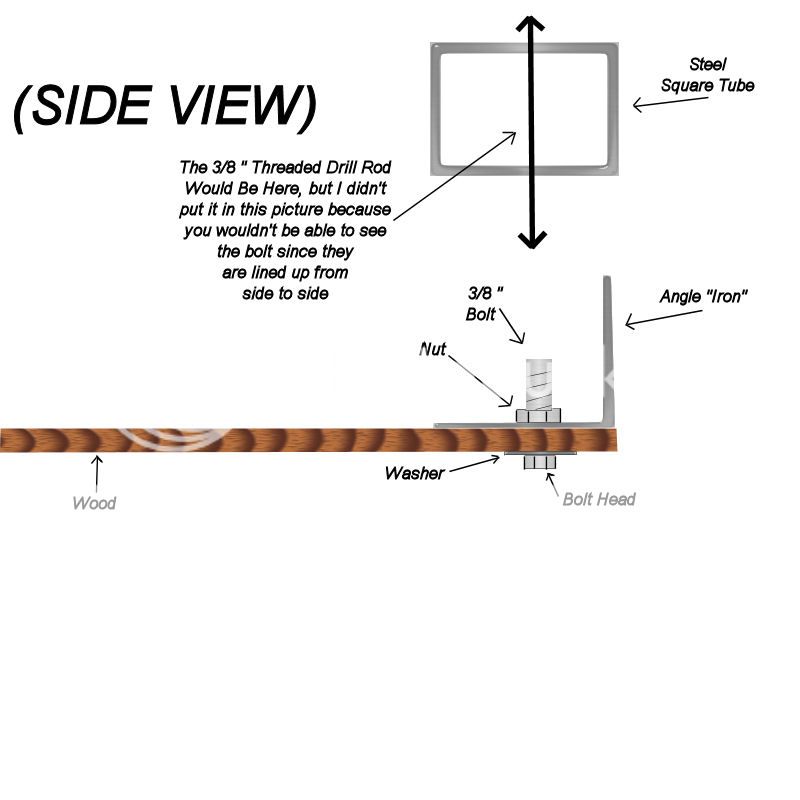

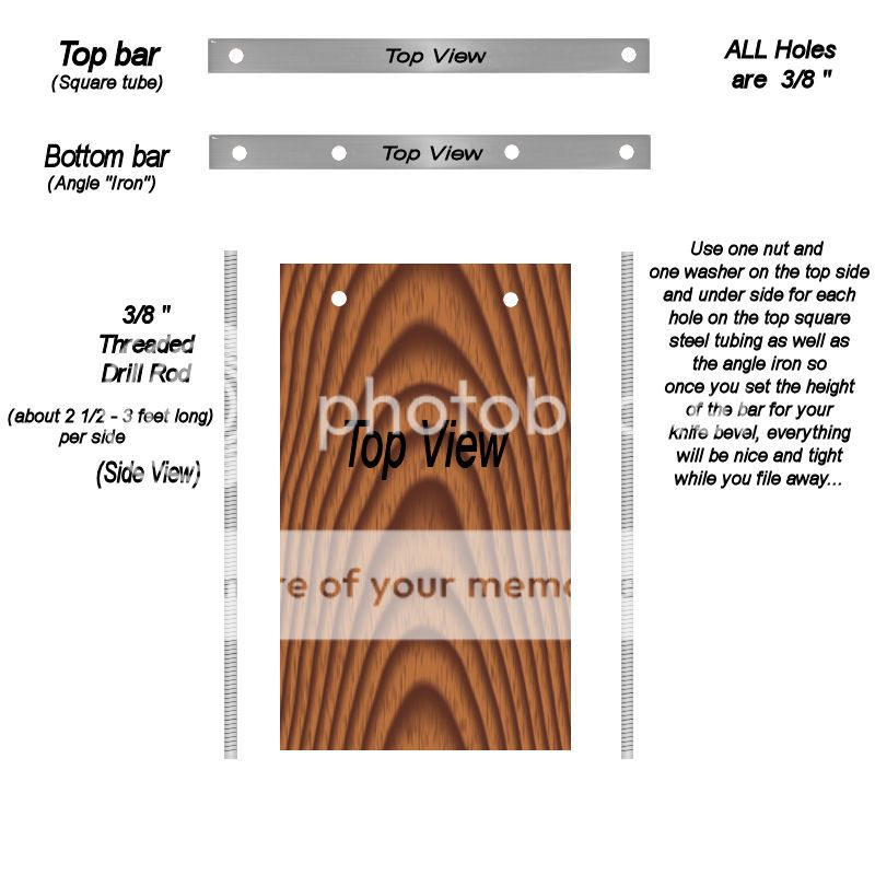

Haha , What are the odds of that!? That's cool though man, I'm glad my vids helped inspire you to get into knife making :) Like I said if you have any questions about my jig like how it's built and/or how I used it just let me know. I have had a few people in the past ask me how I made it as well as how to set/measure the angle of the jig.. I'll just go ahead and post some CAD pics that I made up for them cause it can't hurt ;)
Here are two CAD drawings I made up trying to show one guy how to measure/set the angle using this jig (remember that I set the angle using a piece of metal (or w/e) that is half the thickness of the blade stock):
And here are a couple I made up for a guy that show details on how I built/assembled "my" jig:
