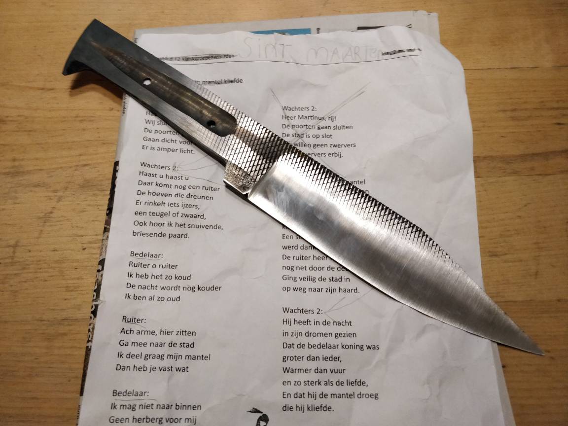

As a bonus...here's a rasp bowie I'm currently working on.
