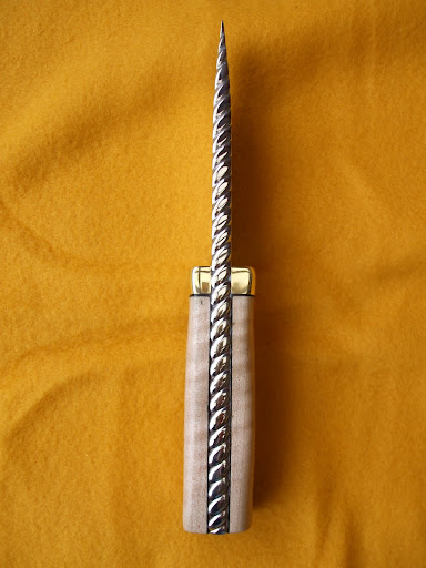

Your "rope" is more like angled humps. You want to twist the file so they have an "S" shape with tapered ends. This image isn't really clear, but if you look close you will se that the rope segments have a tail on each end that curves off to give the overall "S" look to each lay. They also taper off as they go into the tail toward each side. This gives a navette shape to each segment instead of a straight hump.
